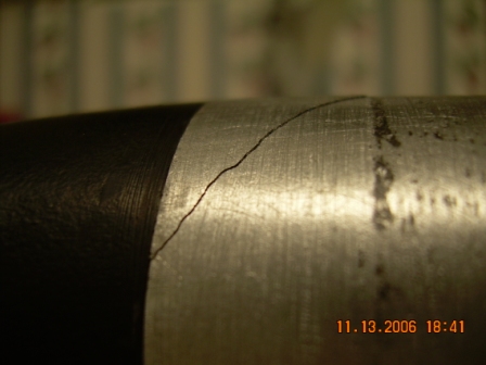

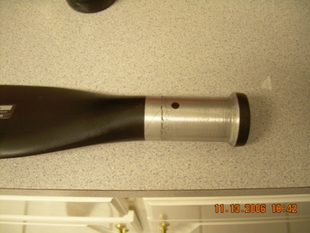

I have a Series 5 Vixen with a Continental I0-240 (125HP, fuel injected) engine. Prop is a Warp Drive 70", 3 blade taper-tipped, nickle leading edge). Total time is 260 hours. This past weekend (during an out of state trip) I found a crack in one of the collars near the hub. After removal of the prop we found a second blade with a simular crack. Warp Drive will not cover becuase of the "high impulse" engine. This was the recommended prop...way back when... According to Warp I could purchase two new blades! This was really not what I wanted to hear. Crying or Very sad
My Warp system is now useless. Please understand that I am not knocking Warp Drive. I have flown 1500+ hours behind (and in front of) their product. It's just the combination of a high (sharp) impulse engine and their non-flexing, lightweight prop set-up. At this point I can NOT recommend using Warp with this particular engine. ...I'm not sure about other Continental/Lycoming engines???

Warp had a problem with cracked collars several years
ago and strengthened the hubs. I wonder if yours is
one of the old ones. I have a picture of one of the
cracked hubs on my home computer, but not there now.
I thought that Warp had offered replacements for the
lighter hubs back then, but maybe not.
Yours is not the first in any event, but if this is a
newer hub, it is the first of those I have heard
about. Good thing you caught it.

If anyone is interested I could take some pictures of the cracked
collars. Let me know. Thanks!

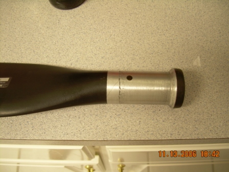

I would love to see a picture of the damage. I don't have the same engine
but will put this on close inspection anyway.
Guy Buchanan

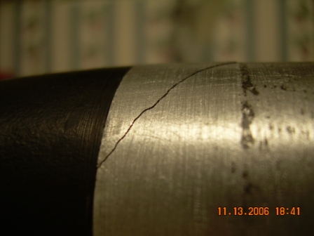

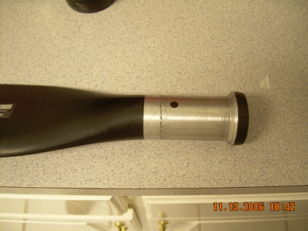

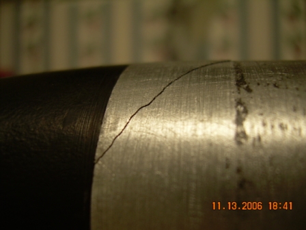

FlyboyTR
Joined: 04 Nov 2006
Posts: 215
Location: Mobile, Alabama
PostPosted: Tue Nov 14, 2006 8:35 am    Post subject: Re: Vixen: Warp Drive Cracked (Continental Engine) Reply with quote

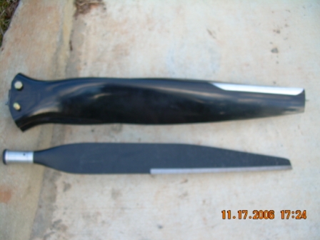

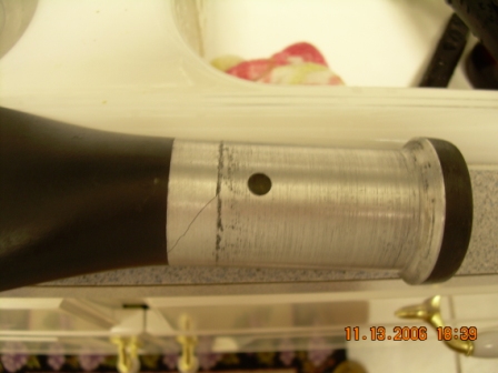

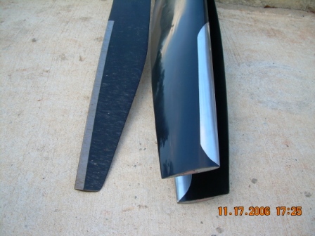

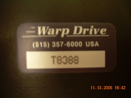

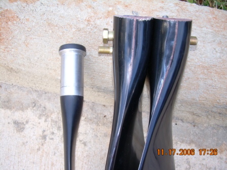

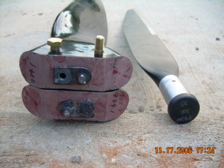

Thanks for all the input and suggestions. I will try to attach 4 pictures of the crack.
Travis Smile

Thanks for the photos Travis. Boy, good thing you found those before they
got any worse!
Deke

PostPosted: Tue Nov 14, 2006 3:01 pm    Post subject: Vixen: Warp Drive Cracked (Continental Engine) Reply with quote
I remember this when it started. There was a guy at one of the Skyster
fly-ins with a crack in the aluminum - I don't remember what engine he was
running. I thought - and please correct me if I am wrong - that the
aluminum ring is non structural and serves to give a smooth metal interface
between the composite structure and the hub. I would be curious to know if
the crack is continuous with the composite blade or is limited to the
aluminum.

PostPosted: Tue Nov 14, 2006 3:32 pm    Post subject: Re: Vixen: Warp Drive Cracked (Continental Engine) Reply with quote
I'm not sure if it's continuous or not. It would be hard to tell without grinding the collar off.
Travis Smile

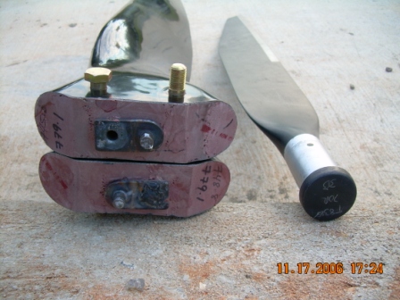

Ivo Magnum arrived. Looks OK. Wanted to add a couple of pictures showing the Warp Drive and the Magnum. It looks really "large" as compaired to the Warp. Plan to install this week. I'll update after installation and flight testing.
Travis Smile

PostPosted: Tue Nov 21, 2006 9:01 am    Post subject: Vixen: Warp Drive Cracked (Continental Engine) Reply with quote
At first I thought dang big blade, wide cord, longer, and then I saw it
is going on a continental. That looks about right to me. Hope it works
out. Interested in the real world results. Thanks for the pics. Love
that feature.
Rick
