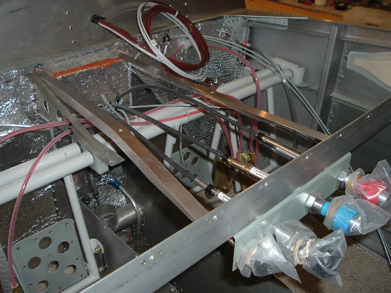

PostPosted: Sun Nov 12, 2006 12:23 pm    Post subject: Quadrant vs. Vernier Cables Reply with quote
Tim & Kevin,
Take a look at the pic attached. I believe this may fix the problem with the venier cables on Vans RV 10. With the much wider panel in the RV 10 the panel flexes and the controls are not as stiff and accurate. I put this on to strengthen the lower panel in the middle where the control are. All but eliminates the flex when you push and pull on the controls.
Just a thought,
DEAN 40449

Tim(at)MyRV10.com
PostPosted: Sun Nov 12, 2006 3:18 pm    Post subject: Quadrant vs. Vernier Cables Reply with quote
Dean, that's a great idea on that brace for the panel. I'm wondering
though if it might not make it more directly stiffer to the cable mount
plate if you put some angle tabs on the end of the mounting plate for
the controls, and attached it to the braces there. That way the actual
place you're pushing on is braced tightly. I'm not sure that this
is what caused 220RV to suck so bad, but if you're right on your guess,
that could be a really good fix. But, Mark also said his work well, so
perhaps it's just 220RV. Maybe it's even more that Continental
engine's injection system.
ddddsp1(at)juno.com wrote:
Tim & Kevin,
controls.
Just a thought,
DEAN 40449

PostPosted: Sun Nov 12, 2006 5:05 pm    Post subject: Quadrant vs. Vernier Cables Reply with quote
Dean,
Are the two pieces of aluminum angle running from the firewall to the lower panel the mod you have done? If so, do they connect to the back of the plate that the verniers are mounted in, or to the bottom edge of the panel.
David Maib
40559
On Nov 12, 2006, at 2:19 PM, ddddsp1(at)juno.com (ddddsp1(at)juno.com) wrote:
Tim & Kevin,
Just a thought,
DEAN 40449

Wouldn't you know it, I just drilled out the SS oil cooler recess for cables. Then Scott brings up the quadrant and Tim tells us again how much he likes them. Feels like I made a mistake. In the spring of 05' I was planning to build a 9A until Randy Debauw showed up at the EAA105 fly in. That changed my mind. Life is all about change, isn't it? Tim how did you cap off those cable holes? I remember you drilled them out and then later found the quadrant runs in a different location?

PostPosted: Mon Nov 13, 2006 3:55 am    Post subject: Quadrant vs. Vernier Cables Reply with quote
Hey Paul, basically what happened to me wasn't that the cables
were in a different location (they probably can be the
same from quadrant to vernier), but that I wanted to use
eyeball passthroughs because the dual snap-bushing thing just
didn't cut it for me. My eyeballs are aluminum, which some
would disagree with (they don't disagree with the aluminum rivets
holding the firewall on though), but it's got to be better than
snap bushings. They allow you to start angling that cable
so it comes out of the firewall at an angle that you wish for
better routing, and aluminum allows you to drill the bore
to your cable size for perfect fit.
The situatio that happened is that I had already drilled the 3
holes out for snap bushings. To use eyeballs, I only wanted
to use the 2 outer holes and then drill another below them
in the middle. (the holes would run together if I drilled
all 3. Well, as I unibit drilled the outer 2 holes, they
ran into the drilled center hole, and that whole area
got chewed up. Had I not pre-drilled the holes, it would
have been simple, but I made the mistake of first attempting
snap bushings.
So to fix it, I cut out the mangled metal, went to a metal
shop where they gave me some stainless scrap, and bought
a "patch" that I could drill properly, and then rivet and
red RTV in place to make it all good again. I got slightly
thicker stainless as well.
For what it's worth, I'm not saying you made a mistake not
going with the quadrant. If you like Verniers, you may like
them here too if they don't work like 220RV. But you can
be reassured that the quadrant offers smoothness and precision...
and yes, even on the mixture side to the .1 gph resolution
Kelly. If you haven't flown one (of this type specifically,
it's worth a try. They're nice.
