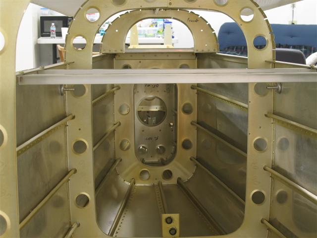

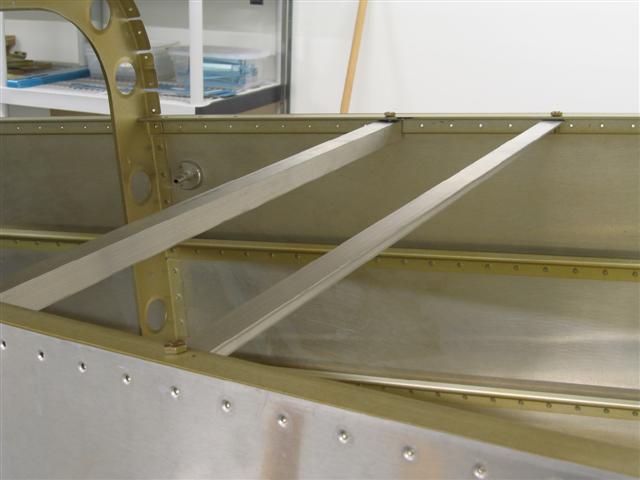

Last night I put in two pieces of angle running across from one side to the other between the F-1007 and the F-1008 in the tailcone (see picture). It took a couple of hours to figure out where I wanted it, cut some angle that was extra, get it to the right shape, drill the holes and so on. It took another couple hours thinking about it, talking about it, etc. All for 2 angles that may, just may be used to hold a magnetometer or some such thing. I can't imagine what some of the more complex mods are costing folks in terms of build time!
However, do this before putting on the top skin of the tailcone, should you even remotely consider hanging an AHRS or some other electronic marvel back there. Worth doing. I'm also going to put in extra wires for the rudder trim, for the camera in the VS fairing, and for the two lights in the HS that I turn on when on long final to light up my tail art.
