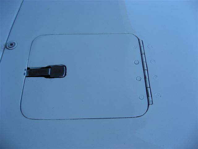

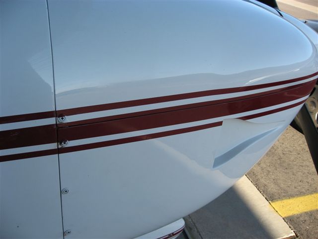

Two pictures of my Glastar ; One had the rivets in the cowl seamed over with a single layer (1") of E glass. The rivets holding the oil access door did not have a layer of glass. The rivet heads appeared between 100-200 TT.

Composites, even VANs RV-10 canopies do not set until the matrix reaches final threshold temperature (Well above 175 degrees). Carbon fiber is usually cured in an oven under vacuum which aids the matrix to reach target and the resin to reach SET. Those aircraft which use dissimilar materials won’t see the shrink for one to three annual heat soak cycles. A have scores of pictures of $25K + Lancair paint jobs which enter the area just after the builder gets through recovering from their investment. It sneaks up and bites the big one.
No RV builder is going to see this phenomena for some time, unless their aircraft is left in the sun of FL, TX or AZ and out in the elements for an extended period. This is one of the unfortunate truisms of composite matrix. David’s findings were most interesting to view after Copperstate. His modifications to the shoulder harness mount are even more revealing when you address the subject of Safety and post crash survivability. Oh yeh, I forgot, statistically no RV-10s have crashed yet. Only one had an unfortunate landing in CA.

David,
How would you strengthen the hard points and what size CS SS washer are you using IF you just go with Vans standard belts? These CS SS washers available at ACS or other places?
Anyone else improved the hardpoints on their top or is this an issue of overkill?
DEAN 40449
________________________________________________________________________
Visit http://www.juno.com/value to sign up today!
dlm46007(at)cox.net
PostPosted: Fri Nov 17, 2006 6:01 am    Post subject: glassing rivets into glass Reply with quote
you can see the pictures of our process on www.inertialbelts.com under airframe prep. In short we are spreading the load over a much larger area and we added additional layers of E-glass and tied all hardpoints together with structural glass mat.
we are using http://aircraft-spruce.com/catalog/hapages/stainlesswashers.php. I looked at www.mcmaster.com #98466A030 and found one for a #5 screw; however the picture does not look the same as the Spruce stuff.
