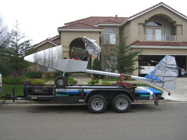

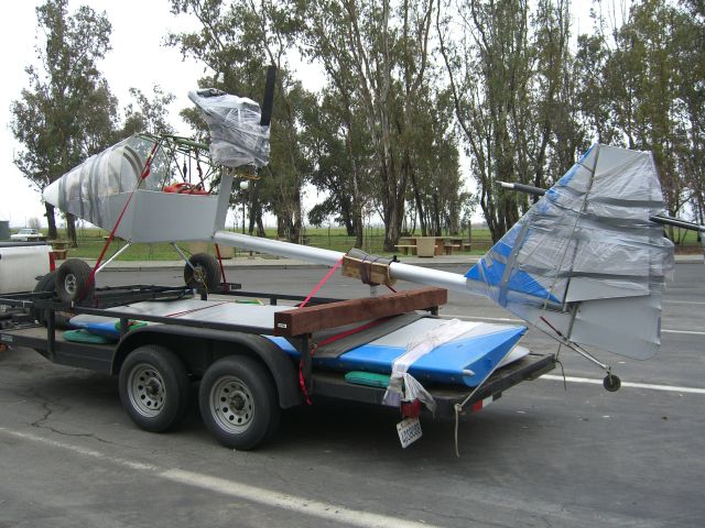

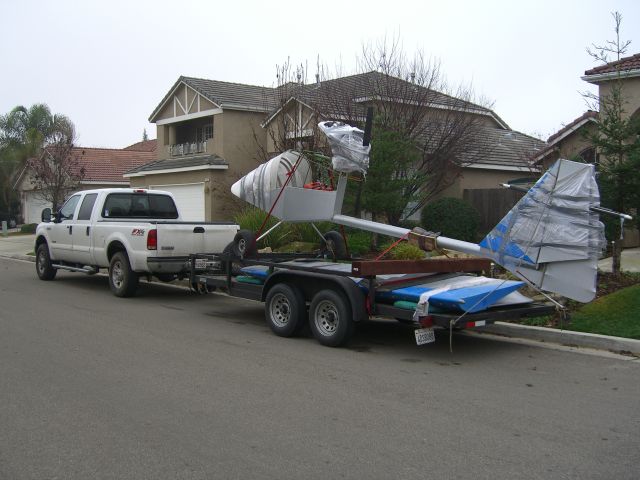

Firebug, this is how I hauled mine for 700+ miles through rain, snow, ice,
fog, etc... Absolutely no damage...

DAVID, EXCELLENT IDEA!!!!!!!!!!!!!!!! I have a welding business on my days off from the Fire Department. I can build any type of metal support I need. That is the ticket. Thanks a million for the idea. The last thing I want to do is damage the plane when bringing it home.
