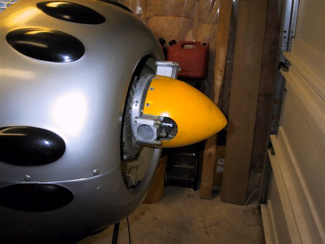

I have probably the same situation as you. My spinner/plate cabe off a
GSC and I'm using it on the Warp. See attached picture of how mine is
mounted. Nine #10 screws go through the spinner and into the plate.
Don Smythe

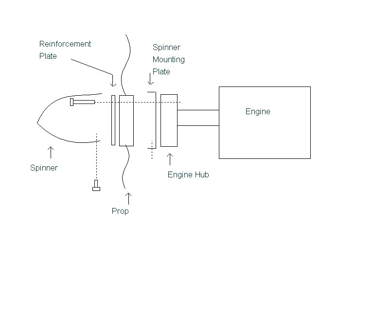

I've attached an slightly exploded view of the spinner and hub. (ignore the title, software picked it) As you can see locknuts would be a little inconvenient behind the plate. I've sent it to Warpdrive props also for comment.

Thanks Don, that is exactly what I need.

PostPosted: Sun Nov 05, 2006 3:00 pm    Post subject: Warp Drive mounting Reply with quote
Dave , That looks right. Just use the round crushplate on the outside of the warp hub then put you bolts through that. I have a E box and it is tight to get locknuts on but i have them on an no safety wire. But you can use safety wire if you like. I would not put on spinner till you all done playing with prop etc. I don't have a spin on the WARP but I might get one for looks, I doubt you would gain much with it but who knows, the Kitfox has a huge hole up front and most likely alot more thant required.

PostPosted: Sun Nov 05, 2006 3:30 pm    Post subject: Warp Drive mounting Reply with quote
My drawing might have the spinner plate reversed. That is, the flange goes
toward the rear. Not sure without looking. When I installed the GSC
spinner, I had to do a little bit of trimming on the spinner to fit over the
Warp prop.
Don Smythe
lcfitt(at)sbcglobal.net
PostPosted: Sun Nov 05, 2006 6:26 pm    Post subject: Warp Drive mounting Reply with quote
I think it depends on the spinner. It seems not all are mounted the same.
My Warp spinner mounting plate, at least I think it was from Warp as it came
with the prop from Skystar, is mounted last (forward of the prop hub) as
the flange for the actual spinner mounting is tapered aft with cutouts for
the prop blades.
The squash plate, I think, is primarily used for the wood props. My set-up
came with one, but the bolts shipped were too short for installation of the
plate. I decided that the plate was something for the Misc Kitfox Box if
using the Warp prop.
The former is as it is, the latter is an opinion.
