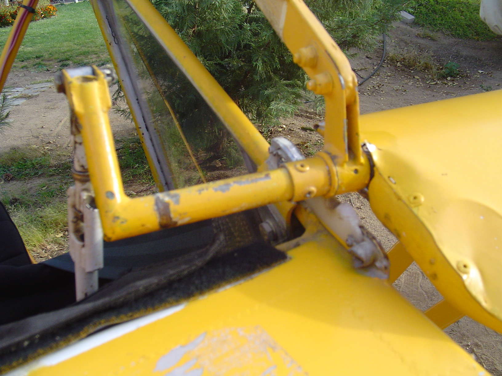

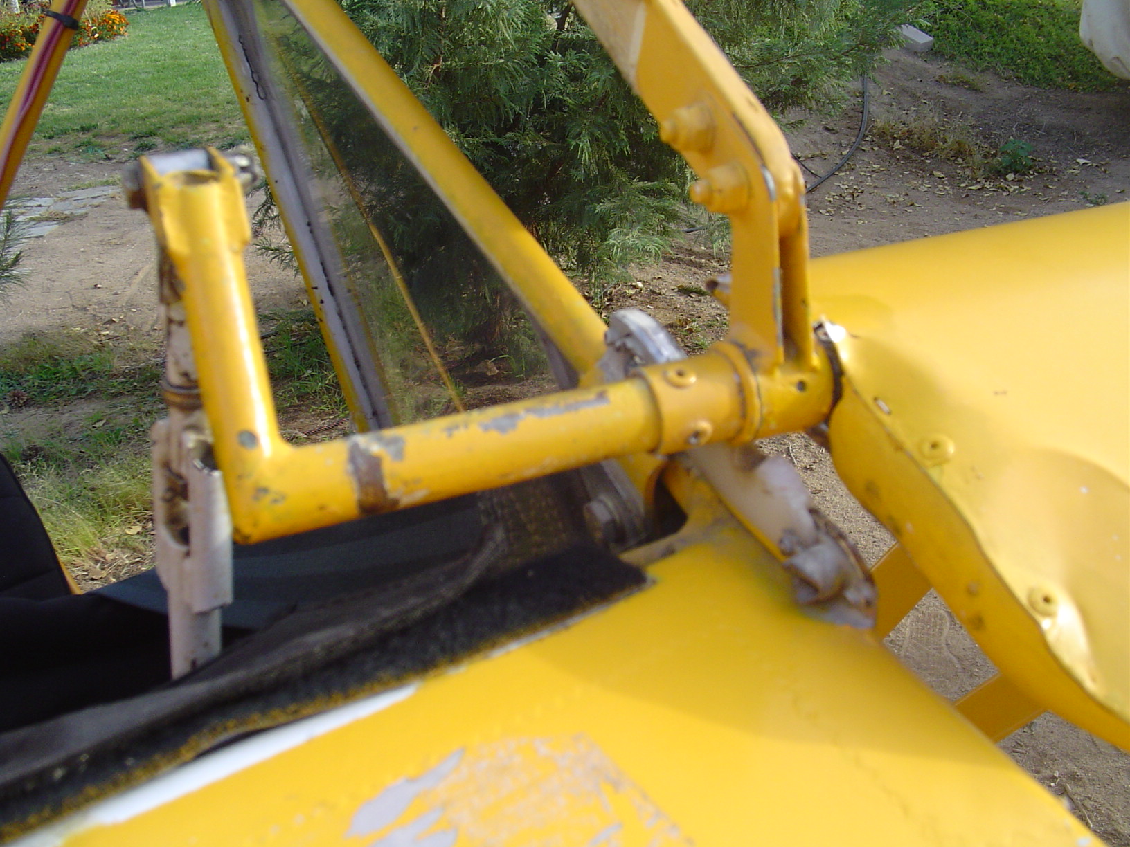

I posted earlier about a problem I'm having with the flaperons dragging on the turtledeck and bearing support. I did post pictures there, but maybe again here would help. Can anyone send me a picture of what the bearing
guide should look like? That would help me aviod having to reinvent. I think I have an idea, but I could really use the assembled expertise here on this forum. By the way, if any Kitfox drivers every find themselves stuck in the Victorville area here in California, don't hesitate to give a call for help. It's still awfully desolate in this desert. I'll be sure my phone numbers are in my profile.
Jack

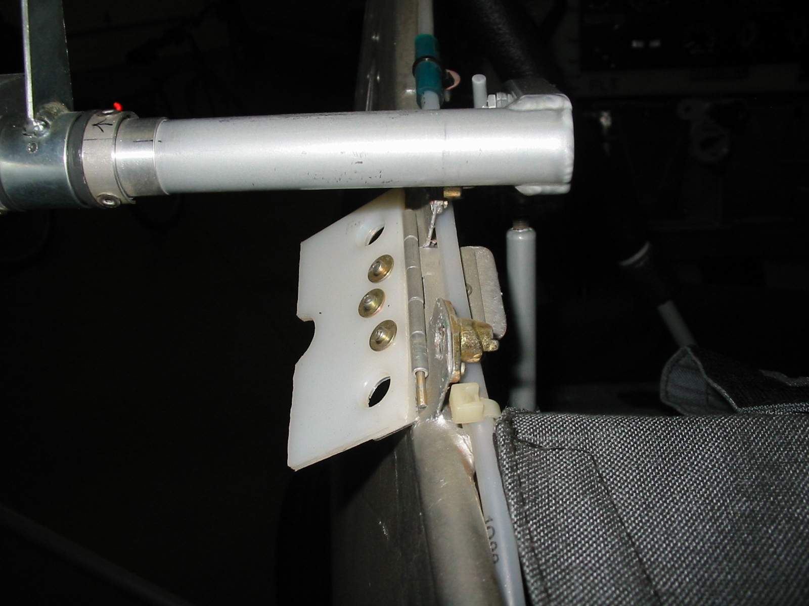

That system looks to be kind of rough on the flapperon when folding the wings.
Attached are two pictures of the Kitfox system. Do these show what you are looking for?
Tom Jones

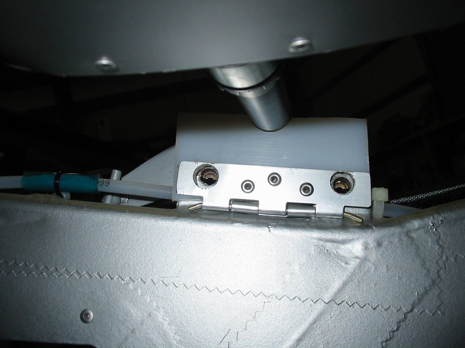

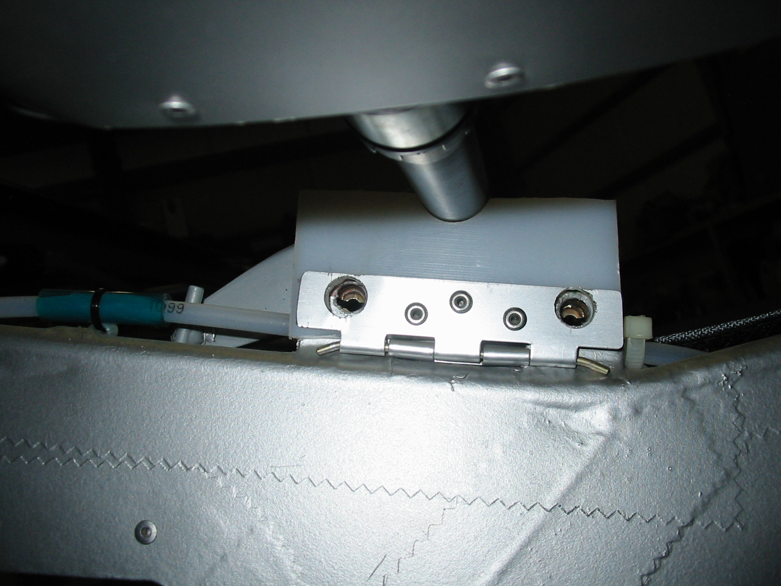

Here is the other picture.
Tom Jones
