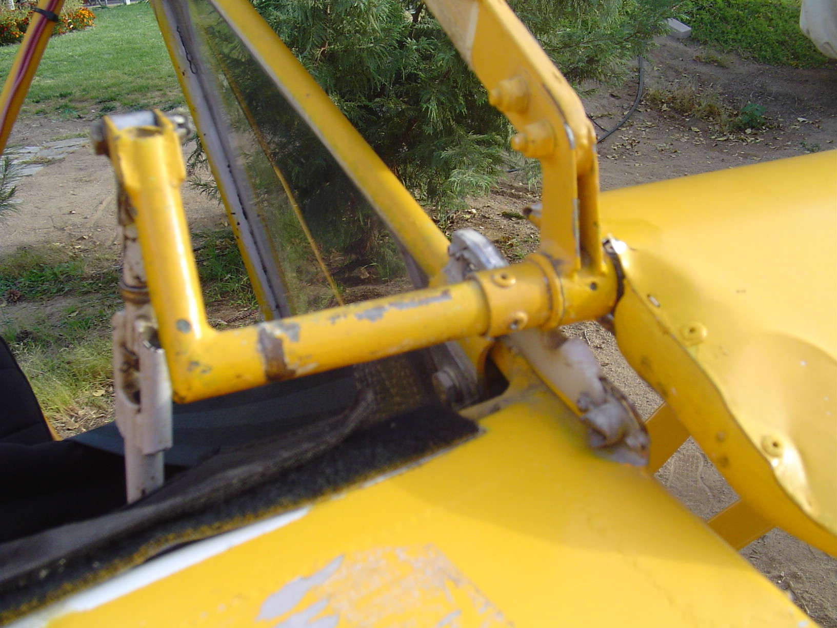

I recently purchased a Kitfox model II. It has a few small cosmetic items I want to fix. The hardest one to me is how the flaperons drag on the bearing support on the turtle deck. Can anyone help me with some ideas in making the flaperons clear this bearing support when the wings are folded back?
I can send pictures off the forum to better show what is currently happening.
I'm looking forward to getting into the air very soon. Thanks in advance for your help.

rudderdancer
Joined: 28 Aug 2006 Posts: 27 Location: Victorville, CA
Posted: Mon Oct 30, 2006 3:34 pm Post subject: Re: Flaperon support on turtle deck |
Thank you all that wrote a response. I'll try to attach some pictures now.
The very inboard ends of the flaperons are looking beat up. The bearing supports do not fold down and the clearance to the fuselage is very close.
One of you commented that the bearing support should guide the flaperon up and over. Could it be that that portion on mine should be tall enough to clear the turtle deck zus fastener and taper back toward the tail a little bit? Please continue to offer suggestions.
Jack
