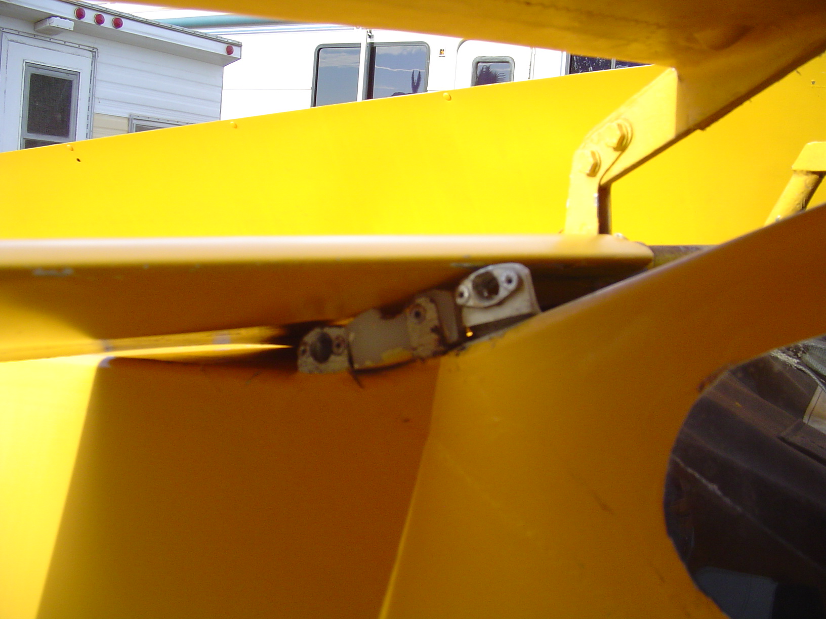

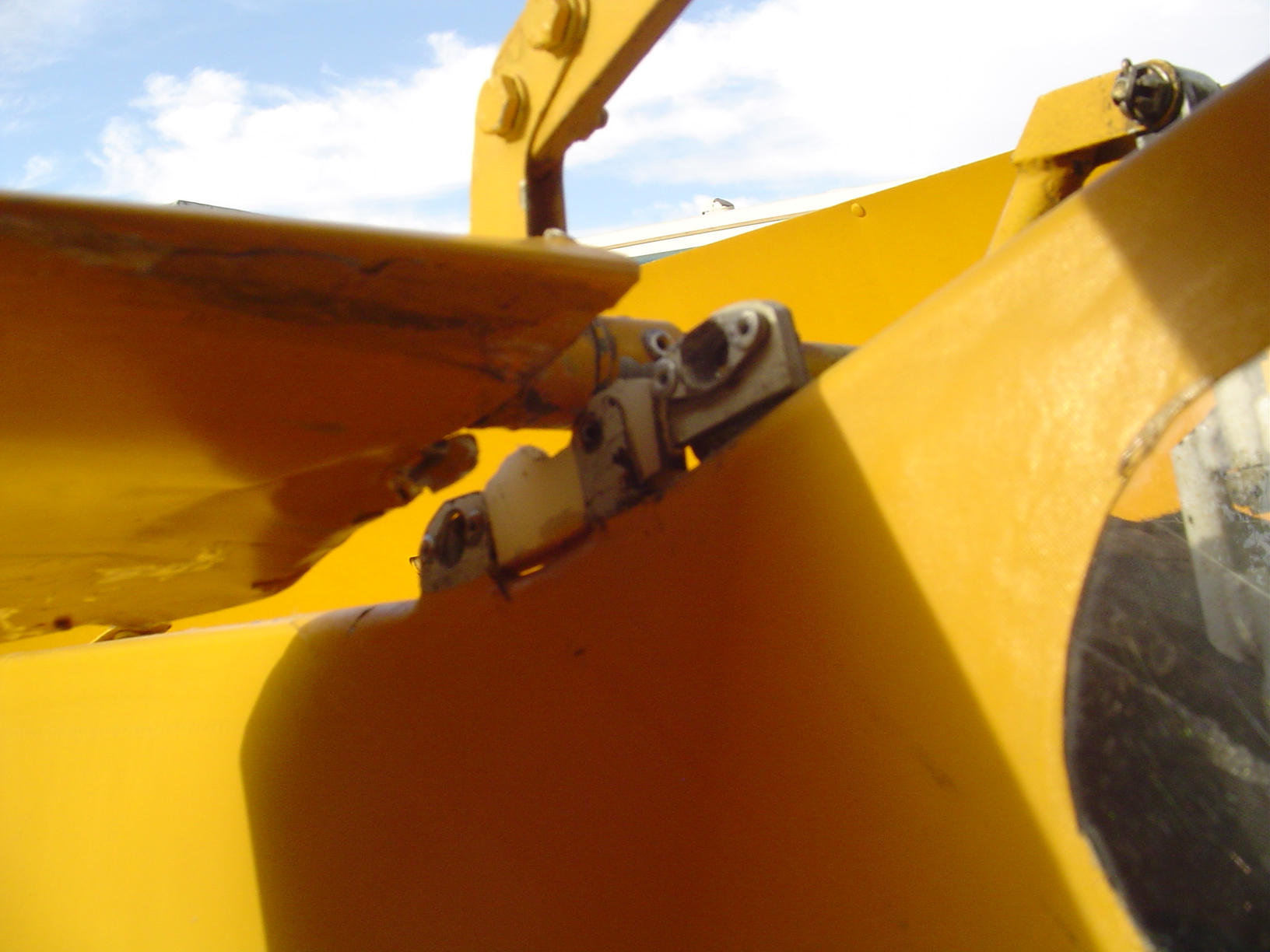

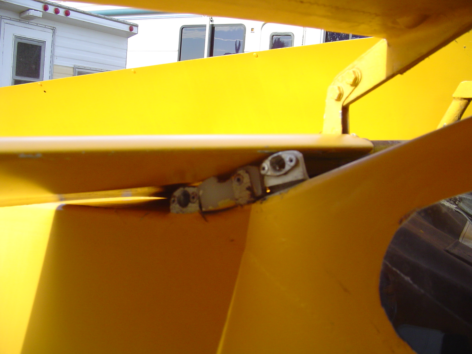

PostPosted: Mon Oct 30, 2006 3:34 pm    Post subject: Re: Flaperon support on turtle deck Reply with quote
Thank you all that wrote a response. I'll try to attach some pictures now.
The very inboard ends of the flaperons are looking beat up. The bearing supports do not fold down and the clearance to the fuselage is very close.
One of you commented that the bearing support should guide the flaperon up and over. Could it be that that portion on mine should be tall enough to clear the turtle deck zus fastener and taper back toward the tail a little bit? Please continue to offer suggestions.
Jack
