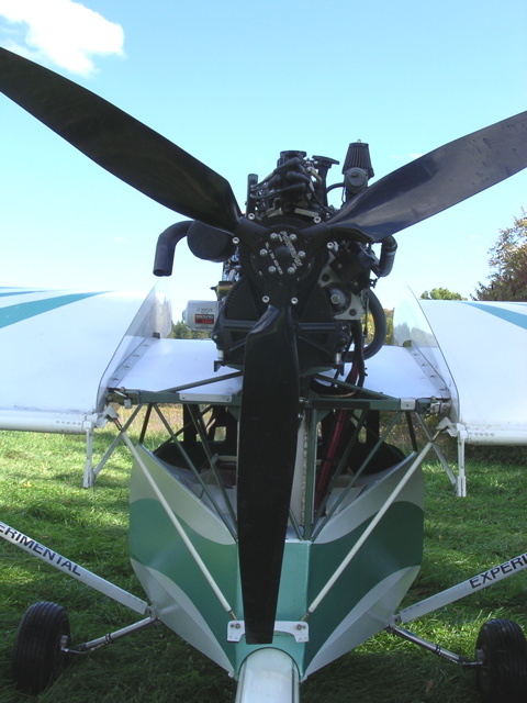

Does anyone have experience flying a mk3 without a gap seal, I noticed one on Barnstormers but haven't flown mine without it yet, It looks like it may improve airflow to the prop and possibly be more efficient?

I would consider flying a MKIII w/o a gap seal to be a Bad Idea.
You know how every airplane has tip vortices rolling off the wing tips as the high pressure air escapes from under the wing and around the tip? (Not a very good description, but you get the idea...)
Without a gap seal, you now have four vortices per airplane, two at the tips, and two in the middle.
Bad Idea.

-Unless you do it like this..........
but I agree with Mr. Pike, nothing there at all degrades your lift by
a large percentage.
I tried it and didn't like it. I've also flown conventional tractor
high wingers without
the fairings to the fuselage. Again a serious loss of lift.
BB
