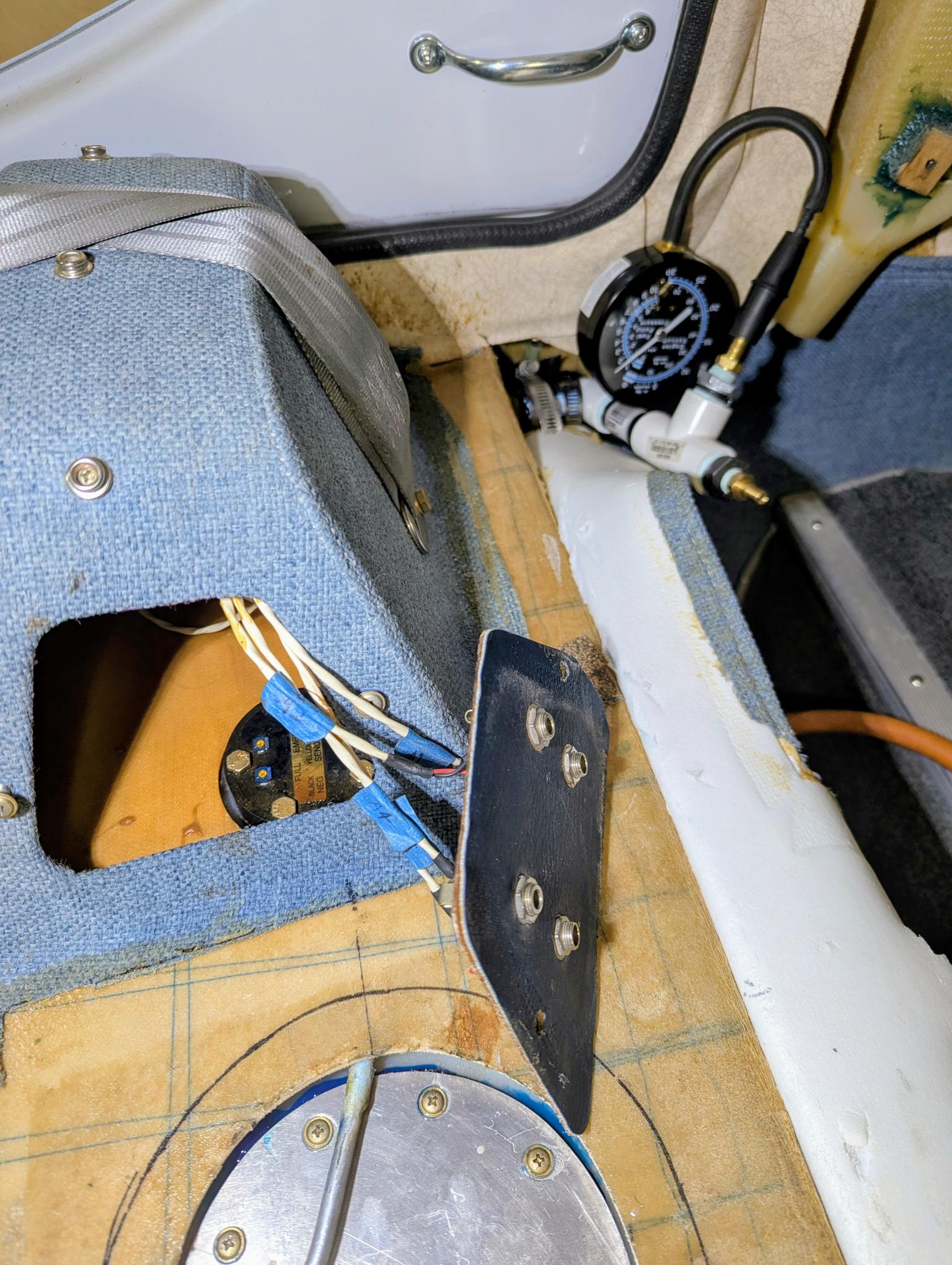

If one day you find your Europa with fuel leaking out as I did don't assume it's the fuel tank like I did.
I just completed a air pressure test at 2psi like the service bulletin suggests. At first pressure came down rather fast but a soap test revealed the capacitance gauge unit bolts were loose, tighten em up then it was not leaking at all.
So what caused the tank to empty out almost completely? Not sure yet maybe the sight gauge tube? I'm still working on that but the tank holds pressure.
I was so certain it was a tank crack I installed the aluminum oval lid as per Dave Disney/Miles McCullum's Mod 8, it is great to have access to inspect the tank so no regrets. One less obstacle.

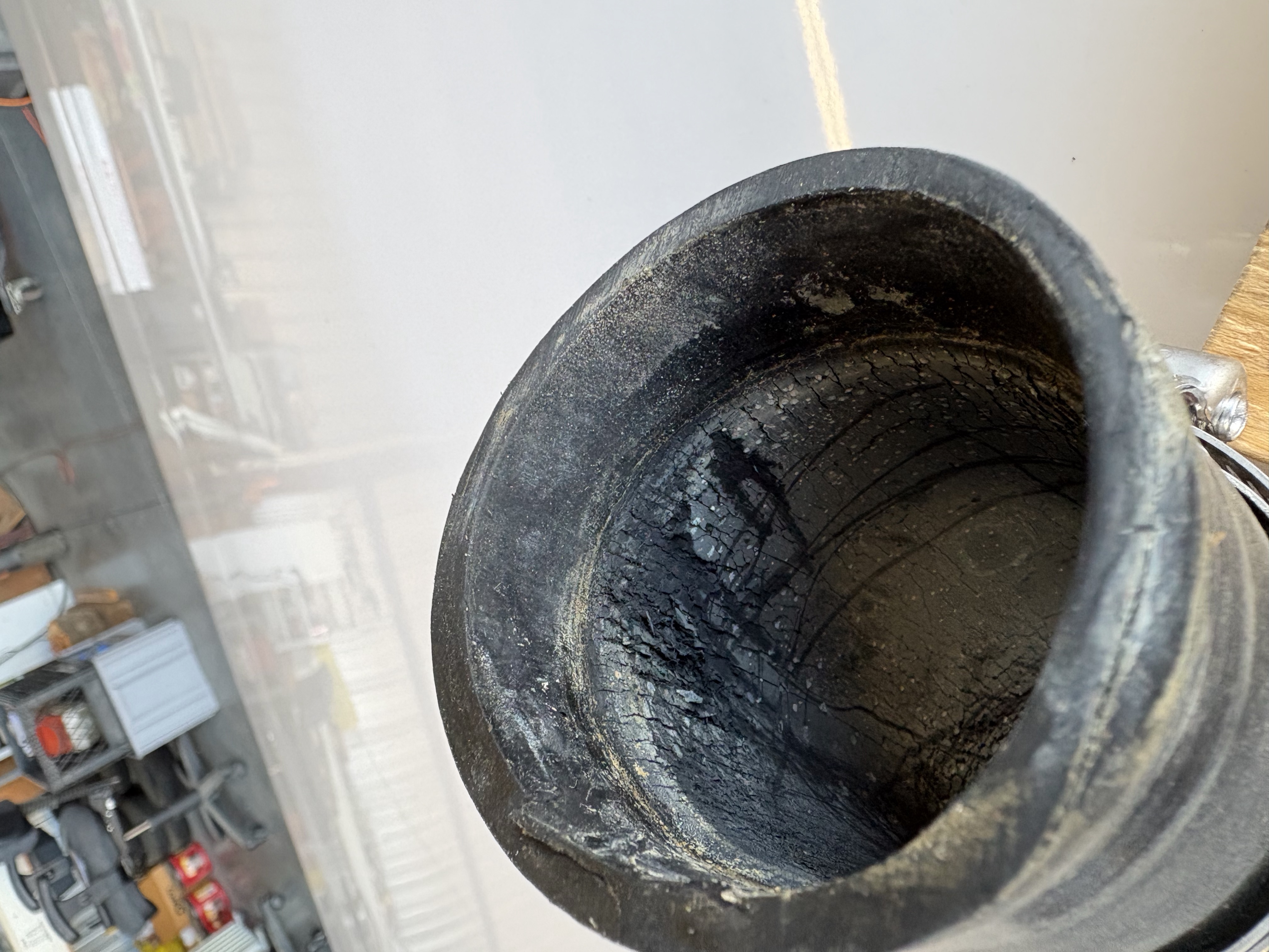

Well I hope that my leak is what I think. If my tank gets 3/4 full the fuel level is up into the rubber filler hose and drips fuel. Replacing the hose clamp didn’t help so I’m going to replace the rubber filler hose today.

I hope it is what you think it is! My original 2" fill hose was not leaking but where the fuel pooled in the elbow it had degraded and was near failure, now have the aluminum elbow from a thoughtful Tim Ward ( Thanks Tim ).
The red strip rubber fill hose is actually fine if you replace it when it degrades.

After 24 years of service the rubber was deteriorating and weeping where the fuel pools when the tank level is above 3/4 full. It was harder to remove than it was to install the new hose.
