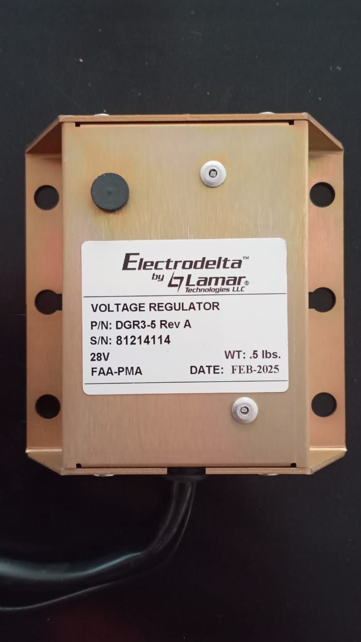

Hi all
Can anyone help with clarity on the wire colour allocation on this
type of regulator?
I cannot find any info...seems this is a drop in replacement for
various legacy installations where a plug in adapter eliminates the
need to actually know where each wire colour is allocated.
Best Regards,
Bob Verwey
082 331 2727

I don't know if these will be helpful, but I was able to find a couple of documents related to this regulator or units like it.
First is a Textron Aviation service bulletin, SEB-24-06. It doesn't say anything about wire colors, but it does have a wiring diagram with pin numbers that might be helpful.
https://www.aircraftspruce.com/catalog/eppages/alternatorcontrol_dgr3-5.php
Second is a DGR3 Field Test document (unfortunately, this is hosted on Scribd, which has a heavy advertising load if you don't have an account). It contains a schematic for a test set that has wire colors (page 6). Maybe those colors will match what's on your regulator?
https://www.scribd.com/document/664162239/DGR3-Field-Test

Bob, No help here, except to suggest that you search through the forum's archives. 10 -15 years ago, I'm sure someone posted about this issue.
Charlie
