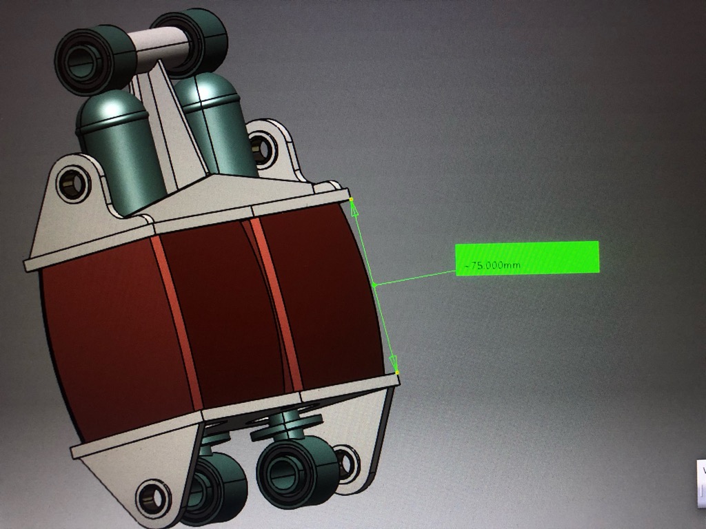

After 800 landings 181 undercarriage measures 3.0" between LG-05 plates, under load, tail down, BEW 325kg.

The build manual specifies a distance of 79 mm (3.1 “) between the plates. This is a critical dimension as it can affect the operation of the landing gear. It also dictates the amount of over-center on the LG08 legs and the corresponding horizontal load transferred to the stops on the frame, especially durning landing. Finally, the dimension also affects prop clearance, which isn’t all that great with the block set to spec.
As my rubber block compressed over time I made up the difference with spacers made from black ABS. I started with a 0.25” spacers some years ago. I now have three spacers installed making up a gap of approximately 0.73”. The new spacers are made from 6mm thick material, although it was sold as 1/4” thick sheet.
So, my rubber block is close to the same dimension as yours.

I measured my XS Mono 914/Airmaster suspension block in the garage no wings on it and it is 2 11/16" between plates. This includes a 3/16" plywood shim. Yes it supposed to be 3.1" but that is no load. If one goes back and reads the old Factory Flyer's, Ivan mentioned putting a 1/4" shim in one of the factory Europa's, G-ELSA if I recall. I did purchase a new suspension block from Swift but it's on standby for now, I'll put it in later.

This has been a great discussion... After a routine inspection of 181's undercarriage up on the hard stand today, measuring up the block at the same time. In the last three years the block has sagged from 78mm to 60mm... The numbers say each digit at the rubber block is approx doubled for propeller tip clearance changes... Will have to swap it out and get it all right before the big prop gets bolted on 👍👨‍✈️
