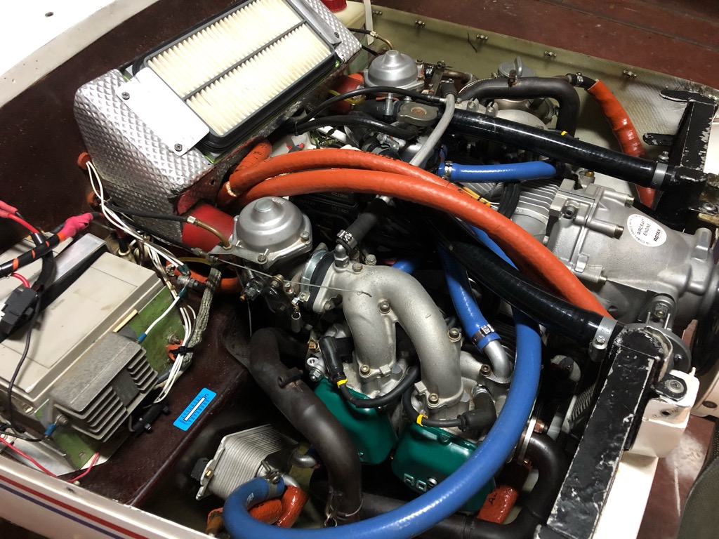

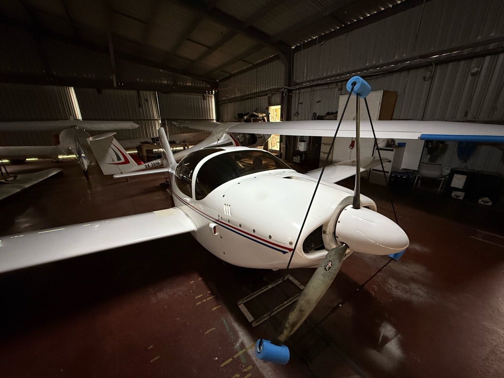

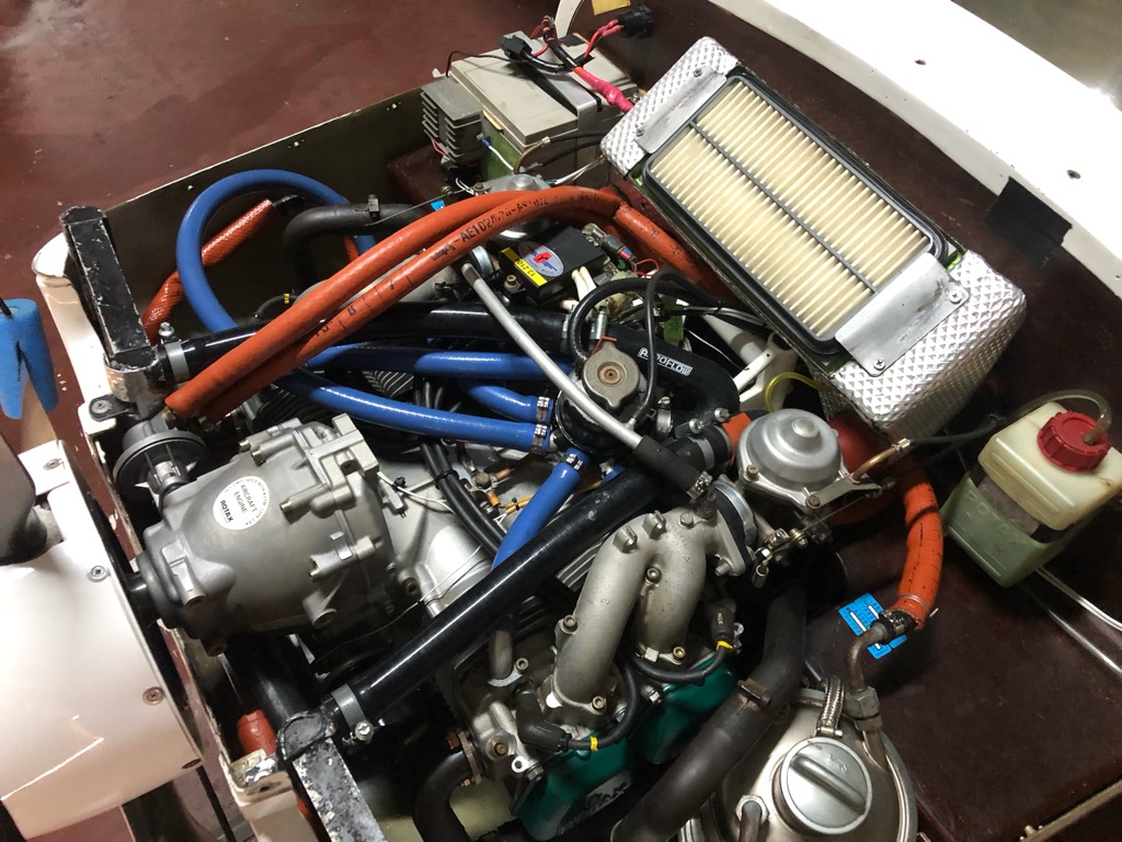

Sunday 05:30 start, pulled out the 80hp rotax unit and bolted in a 100hp rotax unit; all in a single day...
Primary ground checks yesterday; Secondary ground runs today...
5400rpm static burst check on previous 80hp prop pitch setting; 100rpm drop on both line A and line B ignition channels.
Maintenance release and log books signed off; ready for flight ops... waiting for cyclone to go away...
