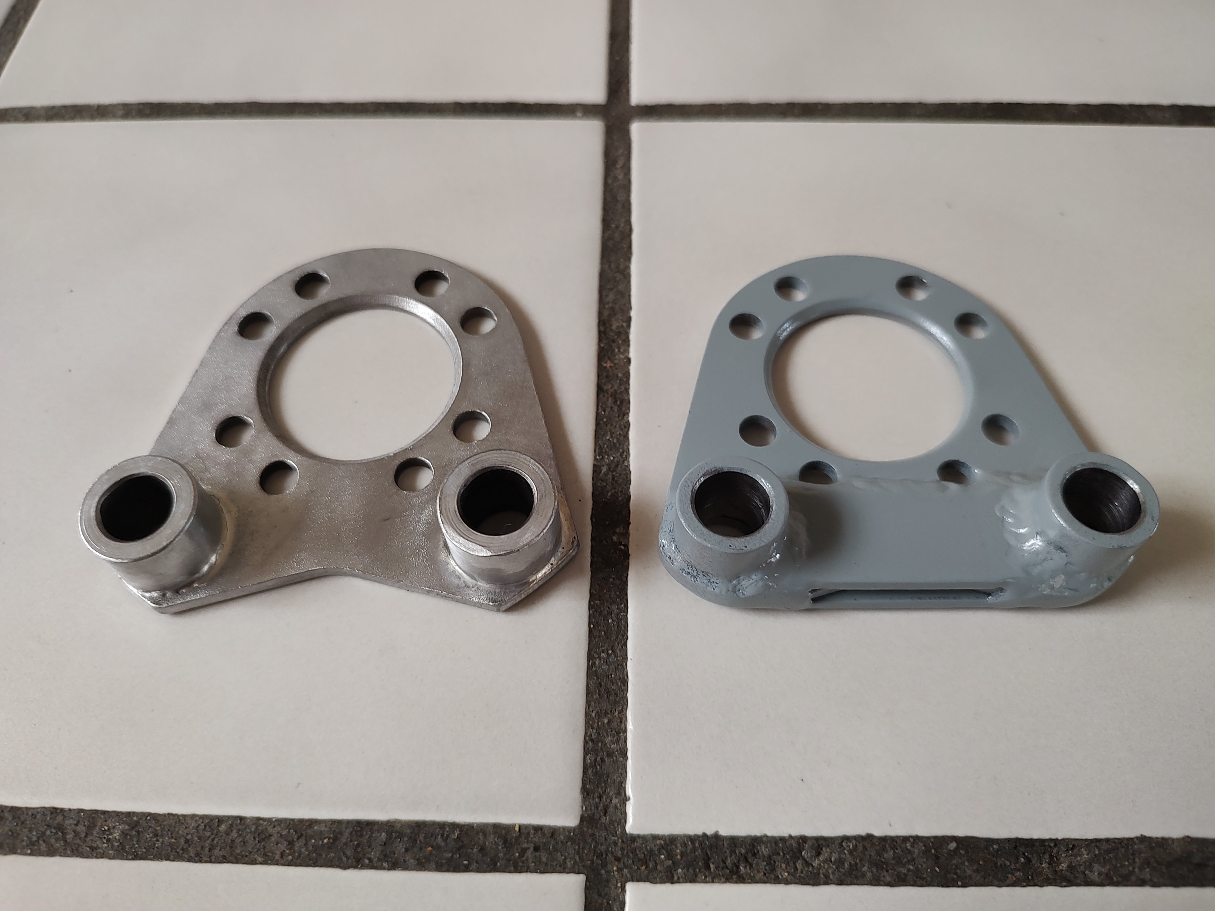

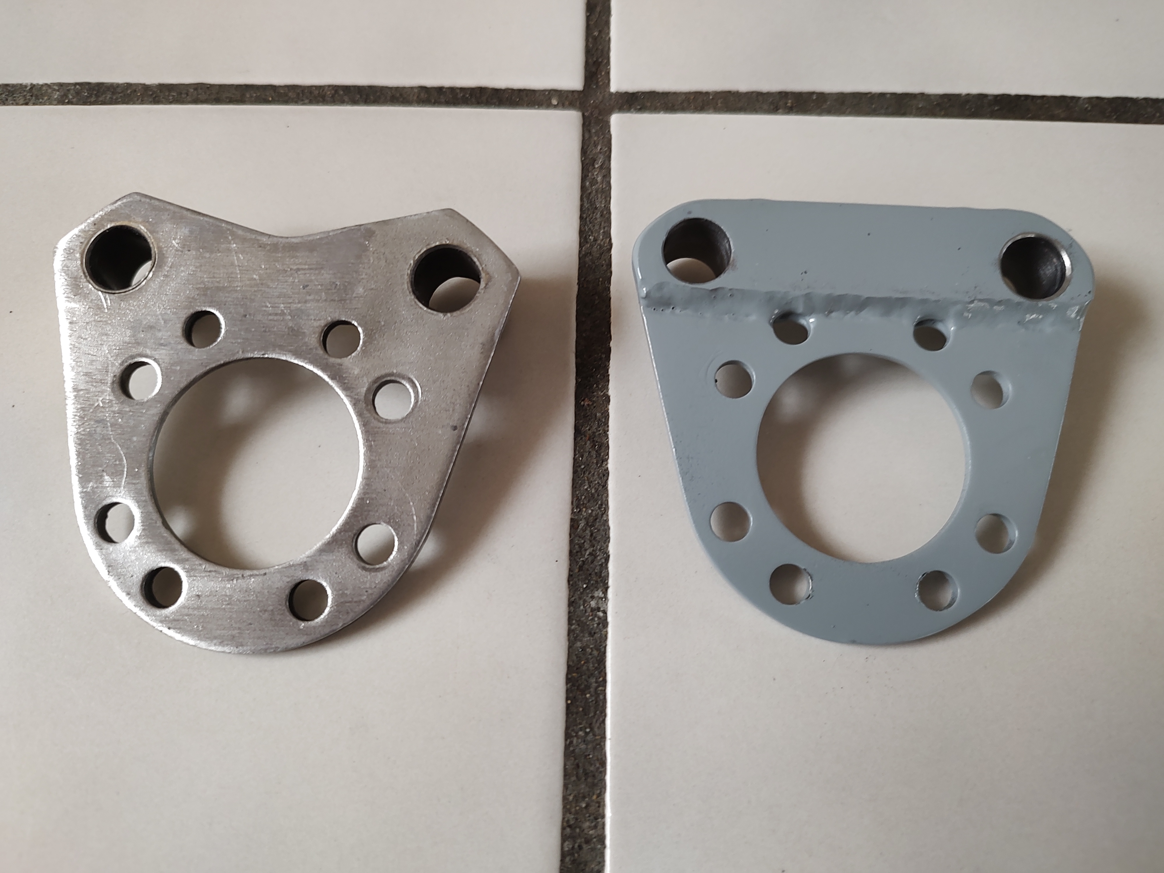

I can't believe I haven't seen others having a problem similar to mine.  Parker-Cleveland part 075-00800 Torque Plate is cold rolled steel that deforms over a period of time because it is not hardened or is just too weak for the application. I replaced a badly bent one some years back and  they are getting pricey new $600, and used $200.  I straightened mine this time and had doublers TIG welded on to triple their rigidity in the weak region. Original left, modified right.

Just curious - in what way was it deforming? Not clear from the pictures. What should we be looking for at the Condition Inspection?

Deformation of the plate in the area of the caliper pin ferrules.  This causes the plate to twist and keep the pads engaged with the disk.  The plate must remain flat and the ferrules parallel to one another so the caliper pins can move freely.  You can see in the modified plate that I have tripled the thickness of the plate in the critical area by welding steel doublers.

…..many thanks!
