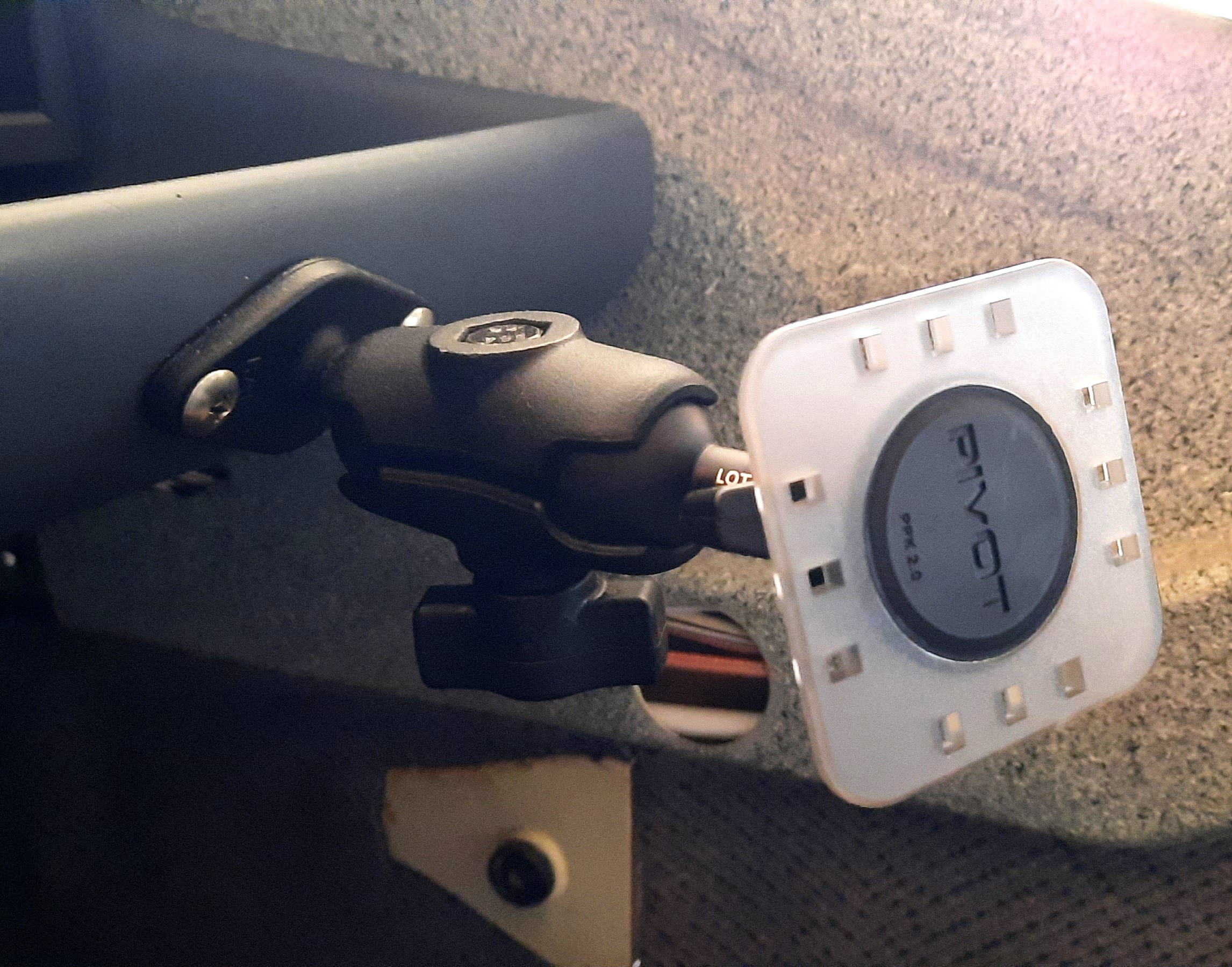

PostPosted: Wed Sep 04, 2024 5:45 pm    Post subject: Re: I -Pad Mini position and mount in a XS Mono Reply with quote
Hello Ron,
I mounted my I pad using a slightly more expensive but excellent mount that airline pilots use in big jets.
The connection to the Europa is on the edge of the tray, bolted on, with support behind to make sure it stays solid.
Whilst I have not flow the Europa as yet, it is very secure and allows almost any orientation both for pilot and passenger, if they want to watch an in flight movie.
This is the company for the Ipad case https://pivotcase.com/
This allows the ipad to be slipped on and off easily.
The actual mounting arm is generic
Trevor
WARNING - do NOT buy a cheap USB power outlet for the aircraft - I had MAJOR issues until I tracked this down.. I purchased an aviation standard one that does not make a row on the Trig radio ...

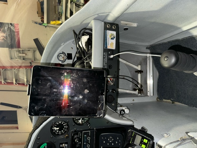

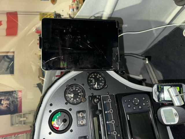

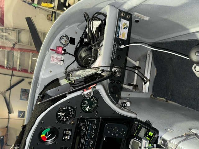

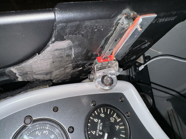

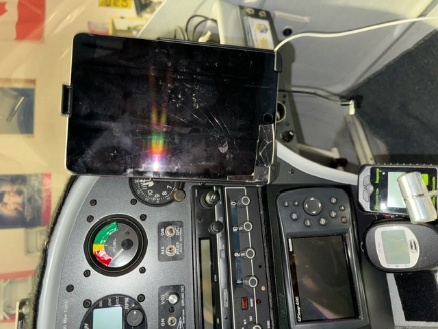

PostPosted: Wed Sep 04, 2024 6:59 pm    Post subject: I -Pad Mini position and mount in a XS Mono Reply with quote
Made my own… works a treat.
PeteZ
C-GNPZ
On Sep 4, 2024, at 9:20 PM, rparigoris <rparigor(at)hotmail.com> wrote:
Forgot to mention, want the ability for passenger to be able to use I-Pad Mini. Ron P.
