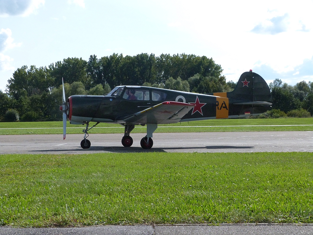

the air pressure numbers look a bit low at below 20 bar, maybe from a Yak 18 two seat. We did fill up a 18 T two years ago, but just cared for stand height, no worry about numbers. You fill up more than required and only by testing and wiggle on wings and later reduce air in small amounts for some angle in linkage at the tele. You don´t want all straight up, too stiff on the ground, see my photo. The two pressures inside are separated by a piston in the chromed tube. The high pressure side is only acitve at high bumps from heavy carrier landings, when that piston moves down from the excessive pressure rise in the low pressure system that you fill up at the top valve way up the gear. So just fill up at the top valve for stand height, no matter what numbers say, for your aircraft conditions in use.
Take care for dirt on the chromed teles, there is only a felt "seal" , that does not seal much but instead collects loads of dirt that ruins bronce bushes inside and scratches the hard chrome. So only help is clean all the time once you see dirt collected. For having a real seal and dust wiper you have to disassemble the complete landing gear, a bigger job but no rocket science. Standard seals inside are common o-rings, not great. Today I´d go for hydraulic type PU seals when available at these sizes.
cheers
Vic

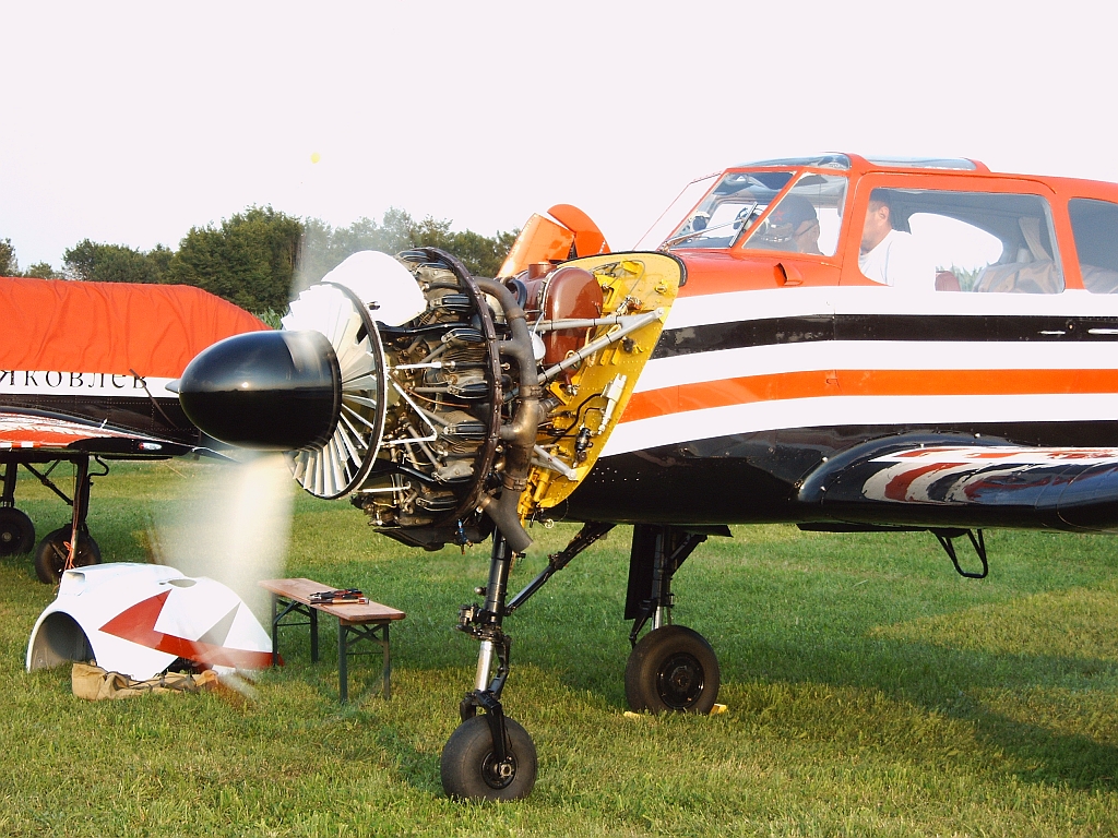

P.S.: In second photo below your Yak in Thannheim - with mag troubles ??
