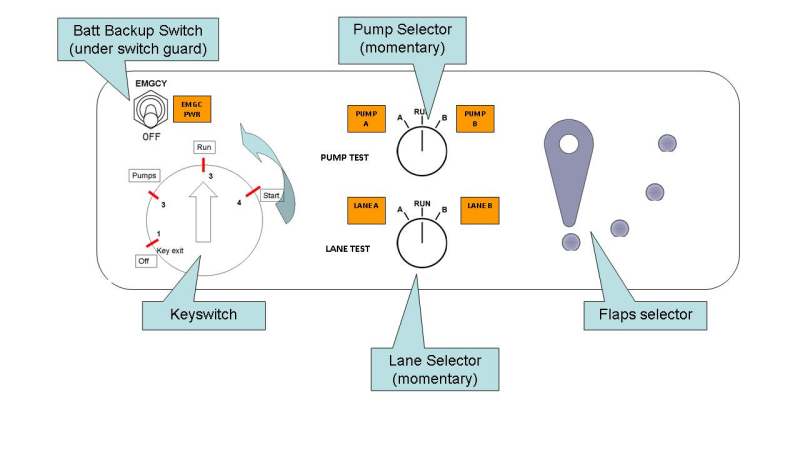

Hello all,
This conversation rang a bell.
In 2016-2017 I was asked to design the electrical architecture for a 912 IS installation in a light aircraft they intended to certify with EASA.
To avoid the multiplicity of switches I proposed the use of a rotating key selector for the Rotax complicated start sequence, with a spring loaded "starter engage" position. The electronic lane and pump test switches were spring loaded to avoid any pilot error.
[img]cid:part1.C3ng0M7d.NioiV3cn(at)free.fr[/img]
The start power was automatically disconnected as soon as bus power exceeded ~13V, and is now managed by the single lever system.
This setup was accepted by the EASA certification team without any problem.

Hi Gilles,
I understand the separate emergency power switch and am doing that also. I understand pumps and momentary start for starter engage. However what is the run position for? Does run activate the start power? If that is the case, what turns off the start power after engine start? Separate logic behind the scenes? Is this switch commercially available or proprietary to the company you worked with?
Matt

Le 09/08/2023 à 13:38, Matthew S. Whiting a écrit :
Hi Gilles,
Hello Matt,
Out of memory - it's been 6-7 years - the idea was positions 2,3, 4 would have "start power" activated.
Pos 3 has  pumps + Lanes activated.
So the "Run" position is pump + lanes and is the "normal" flight position.
Pos 4 activates the starter motor and energizes the correct pump as specified by Rotax.
I had a British firm manufacture a couple of keyswitches as per my specs in order to wire the prototype.
Yes a simple comparator circuit was designed to disconnect "start power" once the engine alternator charges. In case of failure, Rotax assured me that there was no drawback running an entire flight with "start power" still connected.

Pump and lane test switch are momentary.
The idea was to avoid any pilot error or omission in the pump or lane sequence.
Hope this helps

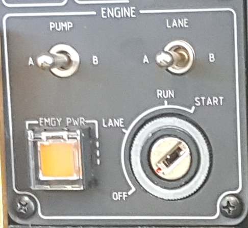

Hi again, Matt,
No doubt the whole sequence can be automated with an Arduino or something. Some factories already did that, but I personnally have some preference for hard wiring and "human" sequencing when it comes to the engine. And automation means electric power and not always obvious failure modes and mitigation.
Having a modular keyswitch wired for a given sequence seems pretty standard for some suppliers, and only cost a couple of dozen bucks, quid or whatever Wink
At the time Rotax IS builders were proud to advertize their neat rows of several switches, cleverly located so you can pull one while pushing on the other. Like other Diesel aero engines, like starting a locomotive.
A pilot error waiting to happen...
This is how they adapted the proposed principle, as viewed on a production aircraft at Friedrichshafen
[img]cid:part1.01pqU4D7.NT2CZw00(at)free.fr[/img] --

Voyager
Joined: 30 Jun 2020
Posts: 77
PostPosted: Wed Aug 09, 2023 7:10 am    Post subject: Simple sequencing using common 5-pin auto relays Reply with quote
Well, when every firing of your spark plugs and fuel injectors is running off a computer, I am not too worried about the computer controlling a couple of simple functions at engine start. Smile
Matt
As long as your chips are as robust, redundant and proved as theirs and you performed the same amount of tests and failure mode analyses Wink

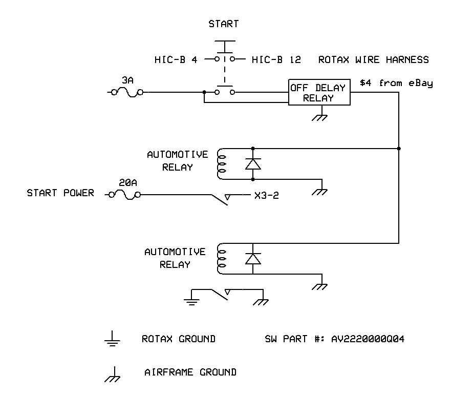

user9253
Joined: 28 Mar 2008
Posts: 1978
Location: Riley TWP Michigan
PostPosted: Wed Aug 09, 2023 8:50 am    Post subject: Re: Simple sequencing using common 5-pin auto relays Reply with quote
How about this circuit? I am not necessarily recommending it, but I think that it does what you want.

Le 09/08/2023 à 18:22, Matthew S. Whiting a écrit :
I agree that a small microcontroller would be a decent solution, however, my coding skills are more than a decade rusty and it would take me far more time to get up to speed again than it is worth.  And the reality is that the system would likely not be maintainable down the road.
I am going with a momentary switch and push button starter with separate switches for the lanes and fuel pumps.  On paper, it seems like my three relay and one diode solution will work and this will allow me to use the momentary toggle switch to latch the relay holding start power until the starter is engaged.  The starter relay will then take over the provision of start power as well as engaging the starter.  Once the starter push button is released, the start power should also release.
If this works great, if not, I will simply hold the momentary toggle while pushing the starter button and plan to mount them close together so that one hand can hopefully actuate both.  This is my fall back solution.
IIRC, "start power" is for powering the electronic lanes and pumps until the engine alternator takes over. In my experience it took some time until the engine was "autonomous".
I would advise to try and make it physically impossible for a pilot to take off with the pump or lane switches in the wrong position.
It happened to a buddy pilot who sometimes visits here, with the 914 infamous two-pump fuel system.
BTW it occurs to me that I might have provided some background to the choices I mentioned.
The goal of the design team was certification of their project - which they finally obtained - and in my experience certifying means convincing "your" system or structure expert that he won't be sued should something happen with your setup after he approves it.
So sitting with him I had to demonstrate how things wouldn't go hairy if my little "Start power" device failed.
Fail to close => engine won't start.No crash.
Fail to open => no incidence on engine as guaranteed by Rotax. Safe continuation to destination.
On the other hand the engine/instruments "expert" didn't allow the cute little digital backup instruments my partners liked and they had to resort to classic steam gauges.
And the clever optical low level fuel sensor had to give way to a mechanical switch and idiot light due to the requirement to analyse the 3rd party device and 5V power supply.
Of course the above are constraints a homebuilder or ultralight manufacturer isn't subject to.
FWIW
Best regards

I would have to review the docs to be 100% sure, but I believe you are correct. Start power is just to bootstrap the engine until the internal generators take over. If my recollection is correct, the engine first uses generator B (the larger one) which is supposed to be online by 1500 RPM. I have never started a Rotax, but others say the engine fires and gets to 1500 almost before you can release the starter switch. I believe it then switches to generator A which is the one that runs the engine autonomously from the airframe, including separate ground.
If my memory from the Lockwood course is correct, this will be detected when the system voltage jumps from battery voltage to generator voltage as once generator A takes over the engine from generator B, generator B starts supplying power to the airframe and thus the voltage jump. However, I believe the need for start power is long past by then.  Others with actual Rotax engine start experience will have to confirm as I am going solely on my course and reading of the manuals and have no real world experience yet with operating a Rotax.
My airplane is a homebuilt so certification isn’t an issue, however, as a retired CS/EE/SE, I tend to design and build to a fairly high standard as that is simply my predisposition.
