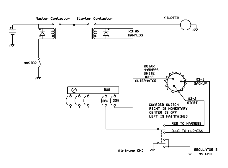

Attached is a drawing from Kitfox that shows only ONE switch used for starting the 912iS engine.
The drawing also shows battery negative connected to the engine mount. Don't do that.
Connect battery negative either directly to the engine or to a ground bus that is connected to the engine.
Joe Gores

PostPosted: Tue Aug 08, 2023 7:44 am    Post subject: Re: Simple sequencing using common 5-pin auto relays Reply with quote
The schematic with single switch accomplishes your goal.
Everything I’ve read in the Rotax manuals says that start power should be removed shortly after engine start and the grounds isolated so that regulator A is not grounded to the airframe.
Joe Gores

PostPosted: Tue Aug 08, 2023 7:53 am    Post subject: Re: Simple sequencing using common 5-pin auto relays Reply with quote
Schematic attached.
It doesn’t as I mentioned in my initial post. You still need two switches as this schematic does not show the switch to engage the starter. The switch in this schematic simply selected between start power and backup power, but doesn’t address the need to hold the start power switch while keeping one hand on the throttle and a third hand to engage the starter. Very Happy

PostPosted: Tue Aug 08, 2023 5:13 pm    Post subject: Re: Simple sequencing using common 5-pin auto relays Reply with quote
You are right Matt. I did not read your original post carefully enough.
You wrote, "mounting one as a toggle switch sideways that can be pulled towards a guarded starter button. . . "
I think that is the best solution instead of complicating the circuit with relays or electronic timers.
