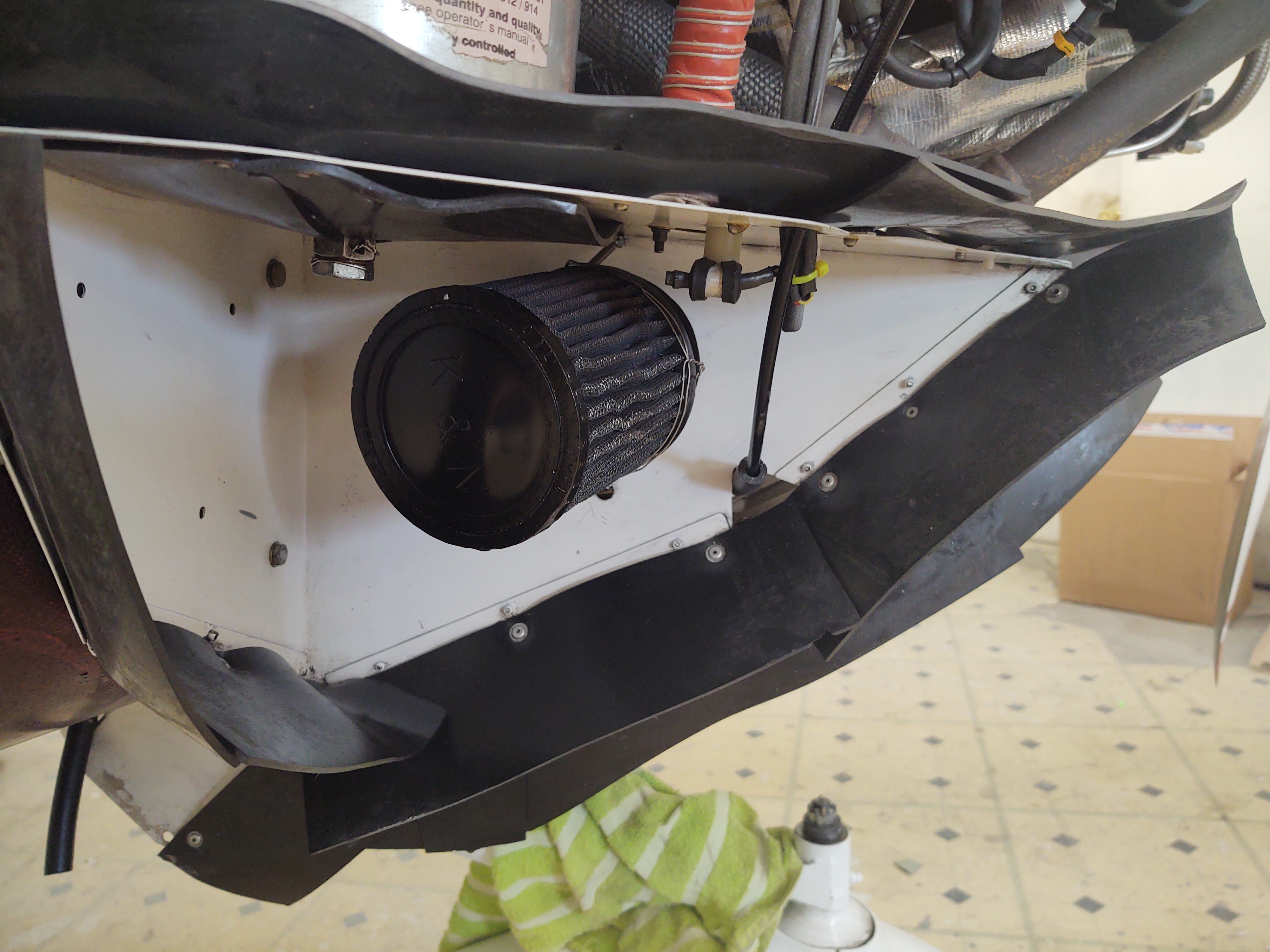

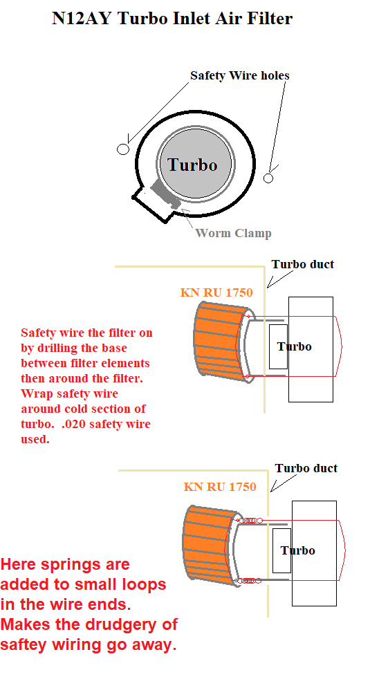

That is standard for K&N. You should see a series of about 5 small rings in the filter opening which are a quarter a mm high so not much to assist in clamping. The filter will smoothly clamp down. When the oil soaks the filter neck (which is normal) the filter will simply slide off because the clamp supplied tends to loosen and nobody safety wires the clamp. So here is some suggestions:
Some consider using heat shrink or thin metal ring of 0.016 to .0625 to compensate. I don't, but the size difference and filter looseness is the reason the book has a warning that all items of the air inlet have to be secured against loss. I have been installing safety wire to prevent it from slipping off.
Photos are attached on how I've done it the last 20 years. Note I use the K&N RU1750 with the 20 degree angle back as it clears my cowl inlet better. I have two springs rather than just safety wire for a quick and easy removal for cleaning. One piece of wire is all that is needed. I loop wire round the turbo, then spin it and bring it through a hole and make a loop for the spring. The filter has two small holes and 25 thou safety wire through the black plastic between the pleats then around and out a hole opposite to it for two or simply do one loop through the filter.
This year I am modifying my filter further for oil collection of oil dripping out of the turbo into the filter (yea, I know, who cares about that oil drip). The air filter has a 1/8 inch barb to flow the oil into one of my catch cans. I know, overkill. It's because I hate that small amount of turbo seal oil soaking the filter because I let the plane sit so long.
