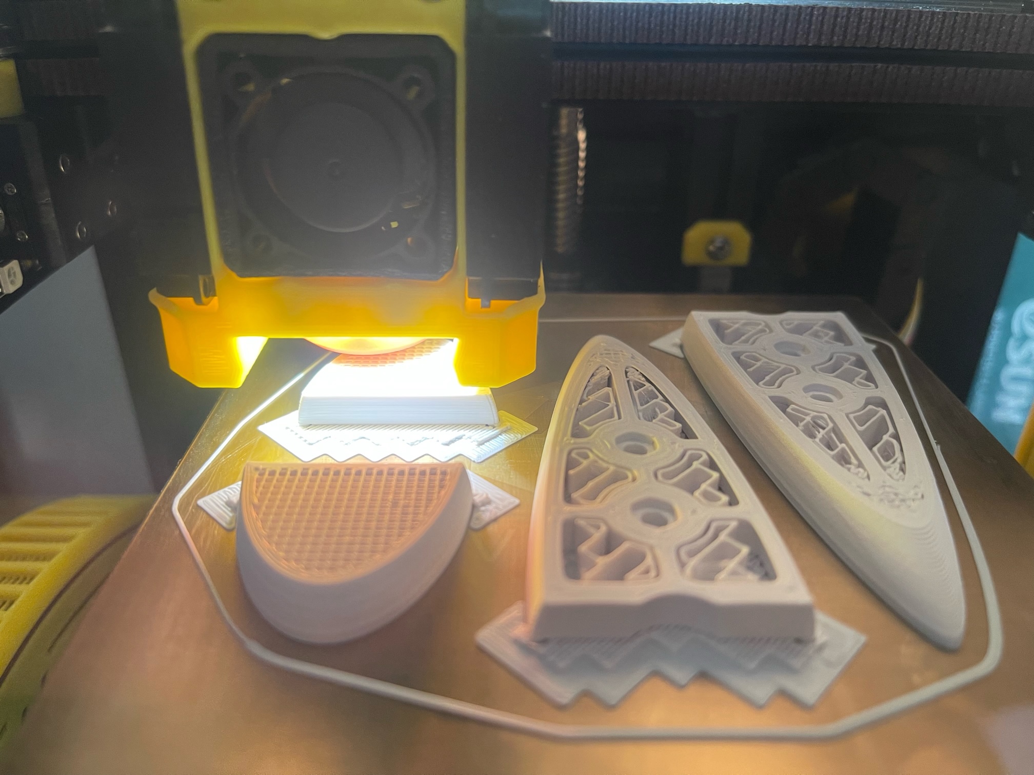

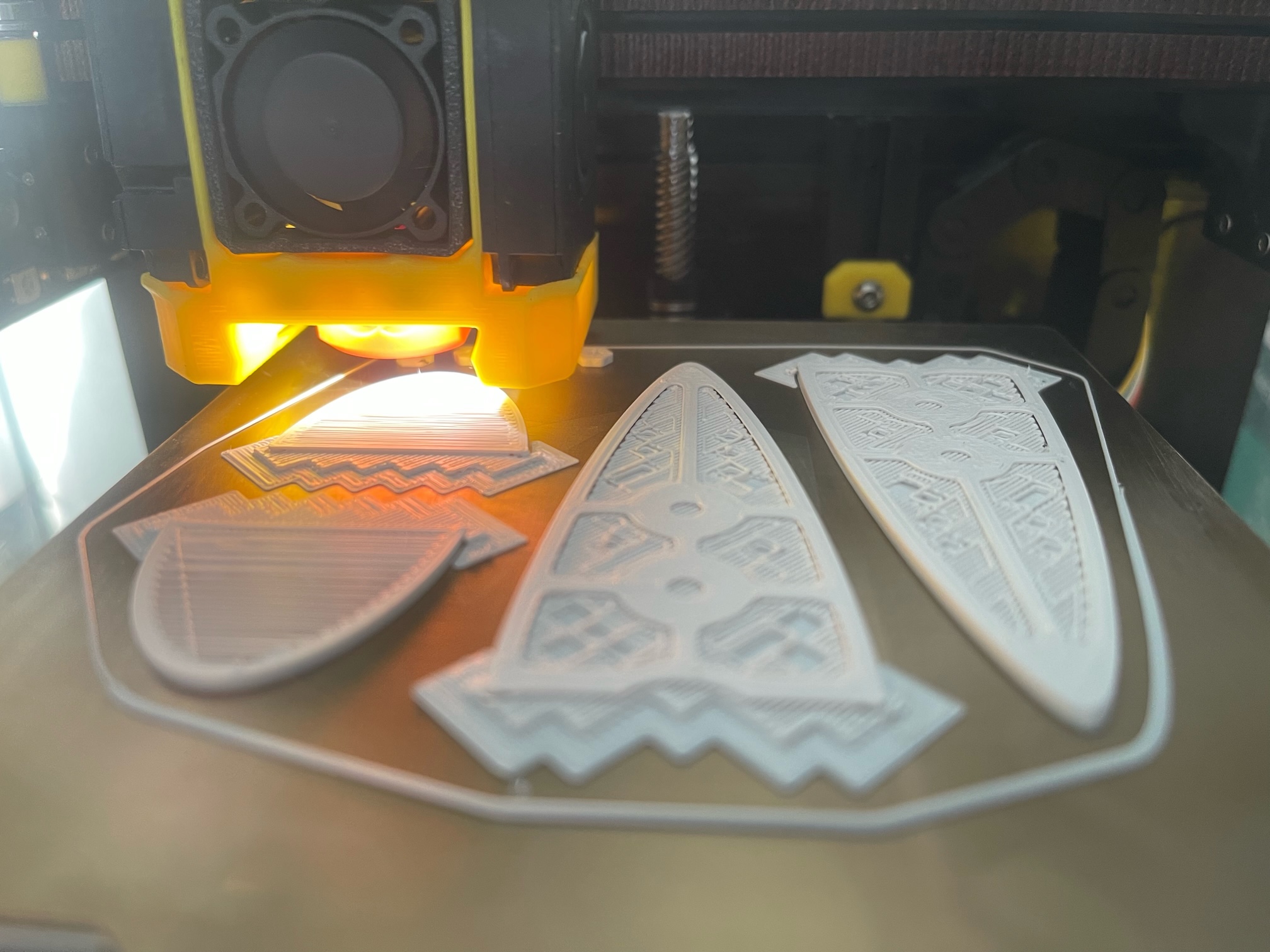

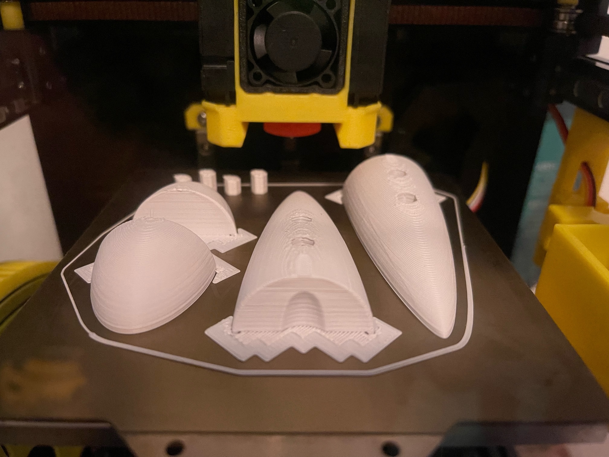

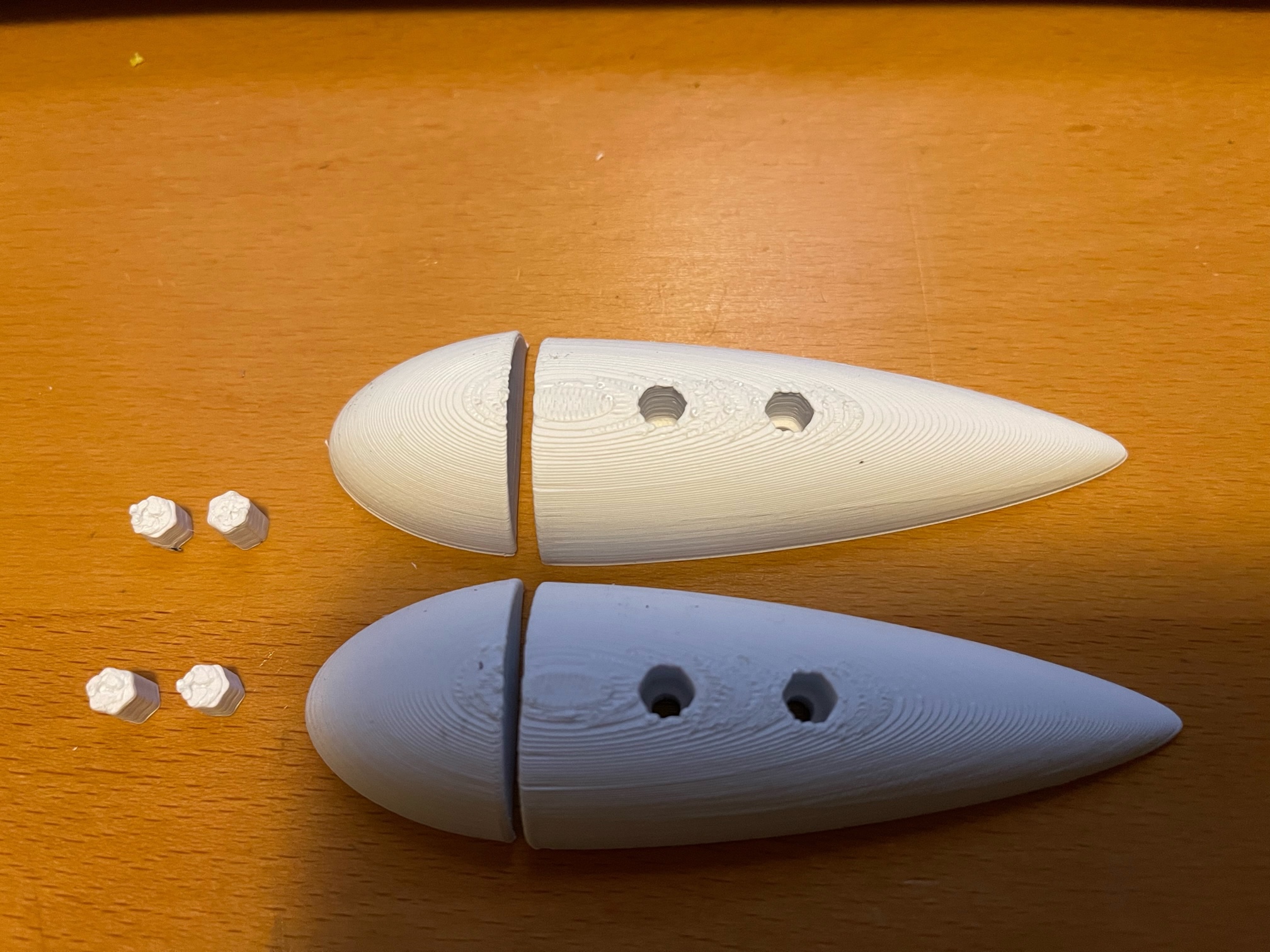

As I’m still setting up my home built 3d printer I thought I would print a set of the shoot-bolt stops out to see how they came out. The white ABS+ I have used is a little more grainy than PLA but can be sanded and painted plus should be much stronger. Hear some shots of the print and finished items. If anyone wants these to try, I’m happy to post FOC in the UK.
[img]cid:751BD4A4-13EF-45E6-8335-7E48DC1C12B7-L0-001[/img][img]cid:D9FDDAF3-25A0-4481-9704-1CAF66DD699C-L0-001[/img][img]cid:D5E615F4-52DD-4695-906C-0C5CAC8B7044-L0-001[/img][img]cid:03DBAFDB-8F04-4797-94E6-A66A224178B2-L0-001[/img]
The fore-fairing has 31% fill as my LAA ones are hollow and one cracked. I have replaced this one with a self printed one but will need to see how they stand up.

Vince looks like the Extrusion Multiplier setting in your Slicer app is too high; try setting it between 8.5 and 9.5... the extrusion beads should be overlapping by about 5%-10%... Extruder temperature looks like it is also a tad too high.... Infill on the forward piece you can set fairly low at 15%, its not load or stress bearing part, will print a lot faster.
The LAA Aft piece is a thin Shell model; it has no interior thickness (i.e its not "watertight"), so printed as the stl is it could probably be crushed by hand and is not optimised for 3D printing only CNC machining. Not surprised at all to hear its breaking in the field. Could be wrong but appears that way...

This 3D printing lark is all new to me so still learning/playing. I decided to build a Voron and use ABS so very much have gone into the deep end head first Wink
These ones I’ve printed will go out to Mike Harris who I hope will provide some feedback.
