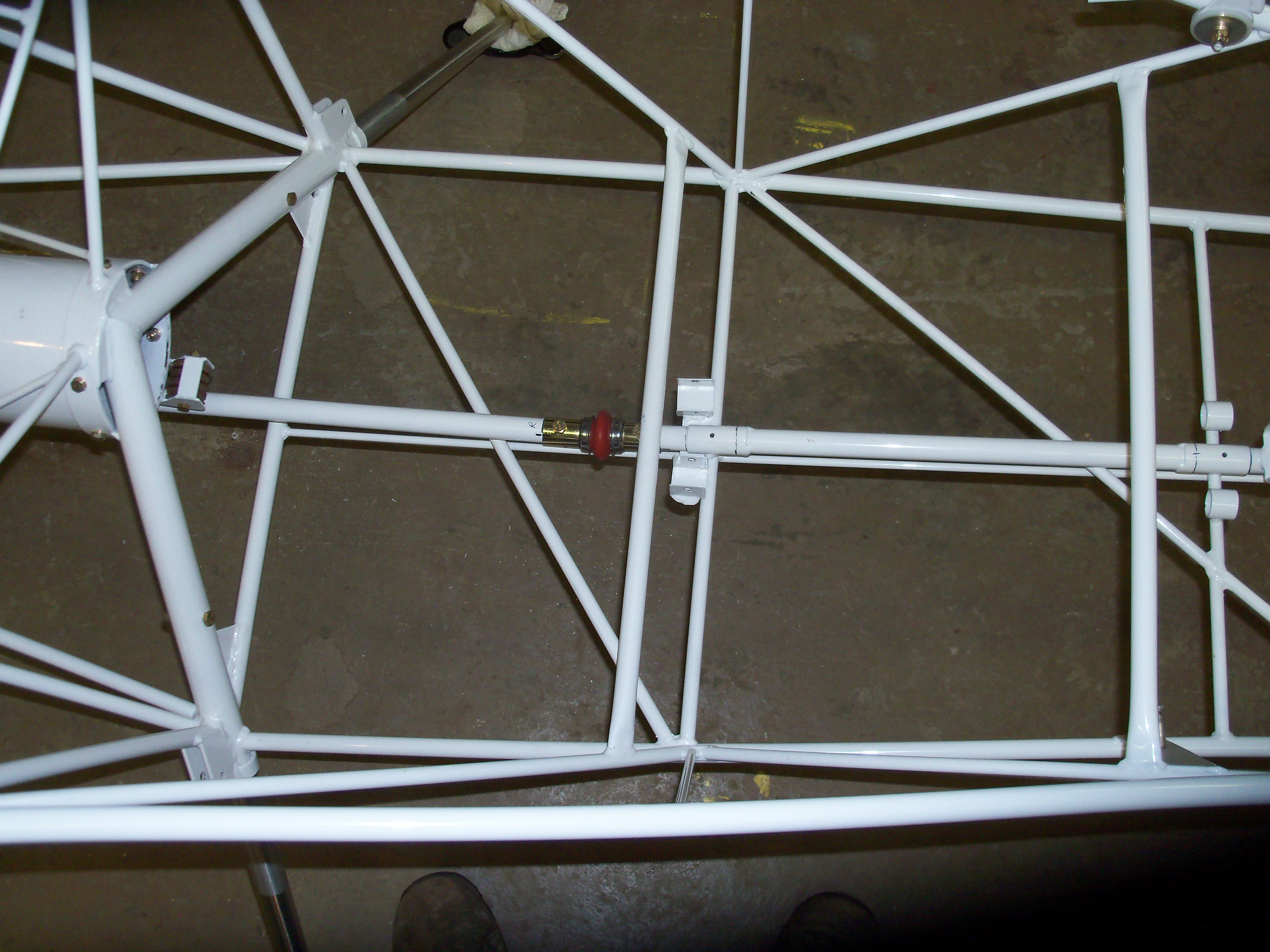

Does the universal joint look like the one in the picture? If it does,
and it has any play in it, I would replace it. Same with the rod ends on
the tubes, mine had no perceivable slop when new except between the bolt
and the eye but that was a very small amount.
I don't know how the joint is constructed under the red seal but was
impressed with it and was told it would outlast the plane. The plans
still showed how to make the torque tube joint with bolts but this is a
much better solution. Maybe you got a bad one?
