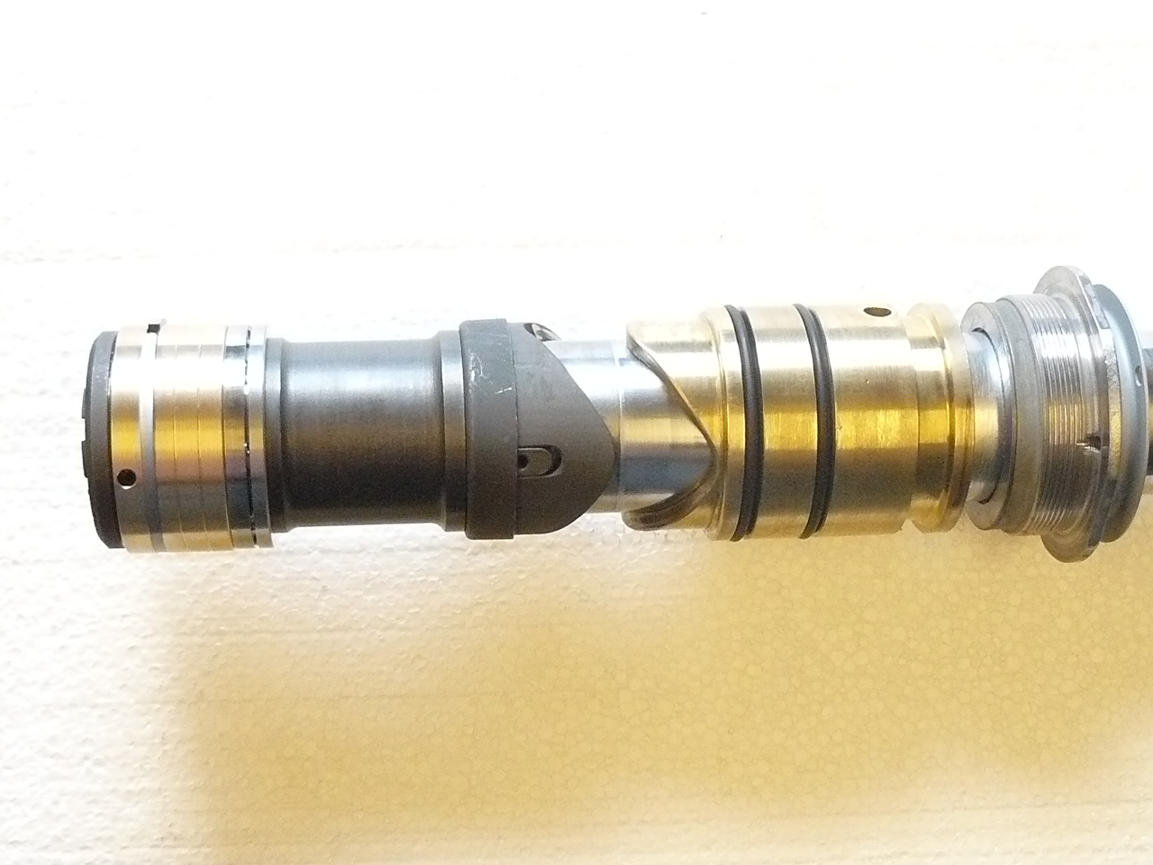

PostPosted: Mon Oct 03, 2022 12:28 pm    Post subject: Re: Nose strut alignment Reply with quote
The only centering device I see is on the front strut. But this is only effective at full extension when landing. So when you see a sideways tendency this will have other causes - like a brake dragging or uneven air fill in tires. The photo is a 18 T part.
Vic
