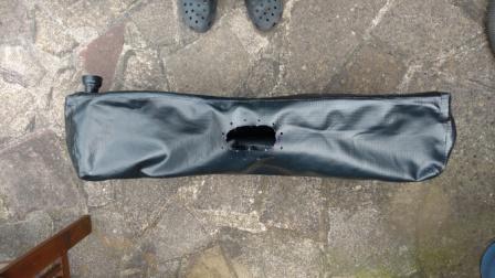

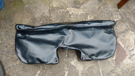

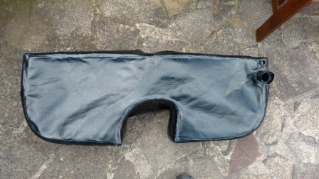

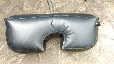

Sorry to hear about your tank problem. My tank developed a split back in 2016, at first, I explored installing a bladder inside the tank as I really didn’t like the idea of installing a new tank. I had studied the repair process and lots of photographs from the web and even produced the mouldings required ready to install a new tank, but I really didn’t want to go that route.
I produced two or three bladders, but I couldn’t produce a bladder that didn’t leak. The idea was to fill the bladder with explosion proof foam as used in racing cars, it would have reduced the tank capacity a bit, but would prevent the bladder from collapsing when empty. I approached several bladder manufacturers, but they all wanted thousands to produce a bladder which is why I went the DIY route. Although the bladder idea didn’t work out for me, I still think this is a great idea if someone can produce a bladder at a reasonable price.
Having spent a lot of time and effort on the bladder, I stumbled on the process of welding plastic fuel tanks in a youtube video. At this point in time, I knew that my tank was split, but I didn’t know where or how bad as I hadn’t cut open the top of the tank. I figured that if I had to replace the tank with a new one then cutting some holes in the tank top wasn’t going to matter, and if I cut the top of the headrests off then any holes I cut could be easily repaired in the replacement process. There was already an LAA scheme for installing a fuel tank sender unit that involved cutting an inspection hole between the headrests, so I knew I wasn’t breaking new ground doing this. Anyway, once the holes were cut I could see the split in the tank for the first time and I thought repairing it was feasible.
I’ve included some photos of the bladder for reference, a copy of the repair scheme that was accepted by the LAA in the UK and a pic of the inside of the tank. It’s pretty self-explanatory, but I’m happy to help if something isn’t clear.
I should add that my original welded repair failed earlier this year after 7 years, but it was only a morning’s work to pump it out and reweld it and it’s been OK since. The repair approval dictates that I must remove the inspection panels at annual inspection to inspect the repair. I usually pump the tank out to do this which gives the opportunity to remove any debris from inside the tank and have a good look at it as well.
Good luck with your repair.
Inflated for leak testing.
 Filesize:  30.73 KB
 Viewed:  10163 Time(s)
Top
 Filesize:  32.51 KB
Rear
 Filesize:  66.11 KB
 Viewed:  10162 Time(s)
The leaking bladder - front.
 Filesize:  66.82 KB

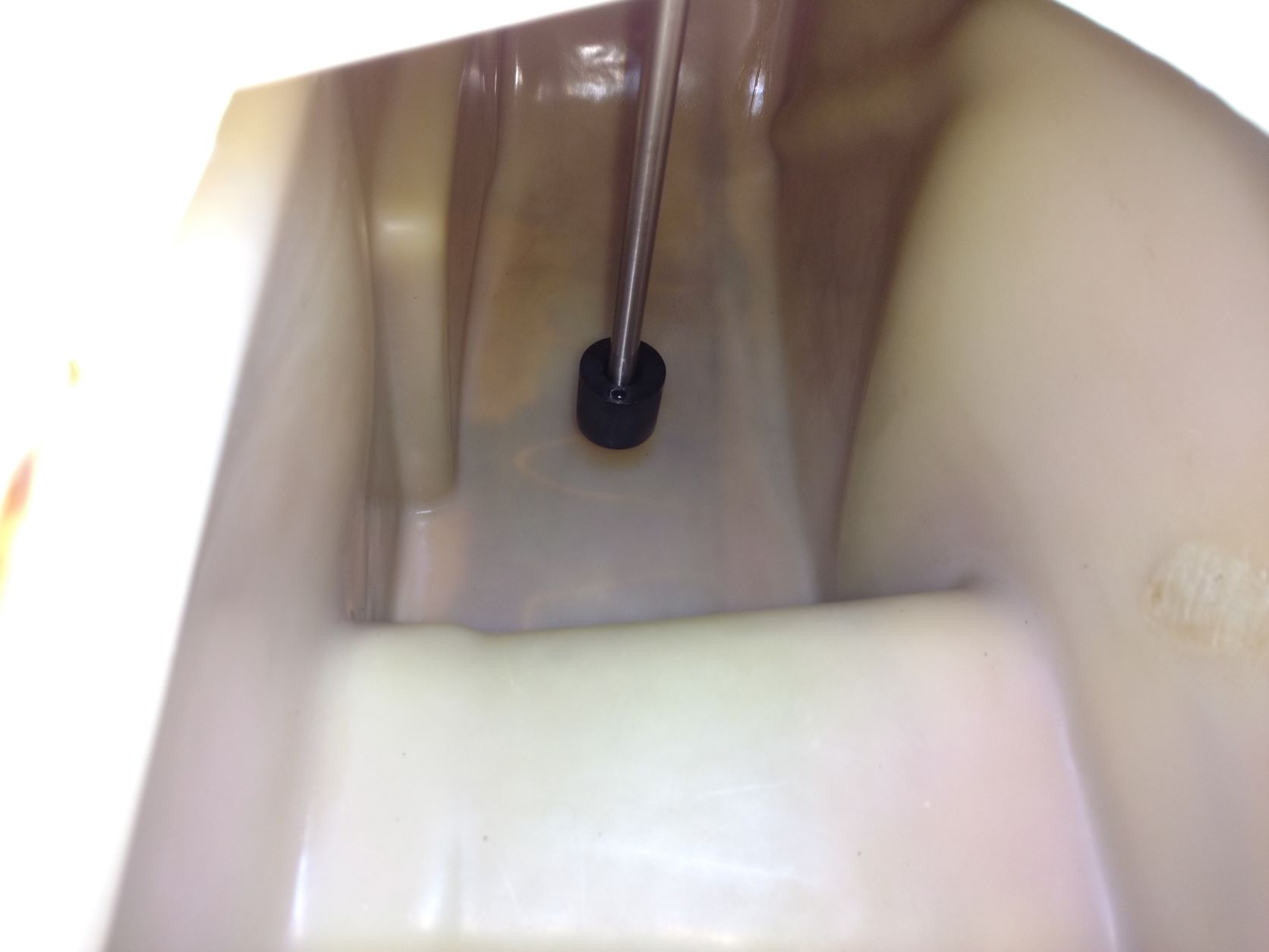

You can just see the repair in this pic - 2 years old at this point.
 Filesize:  83.01 KB

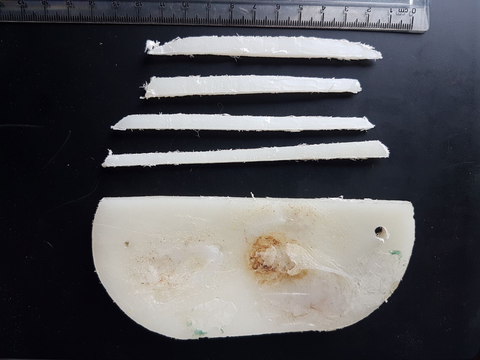

PostPosted: Mon Jul 25, 2022 12:57 pm    Post subject: Re: Fuel tank inspection plate design Reply with quote
Hi Mallard,
I just cut some strips of material from the panel I cut out. I figured that it's the same material so should be OK. From the pic you can see that I was able to use the panel to practice welding before attempting the main event.
