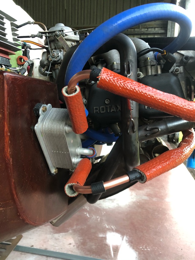

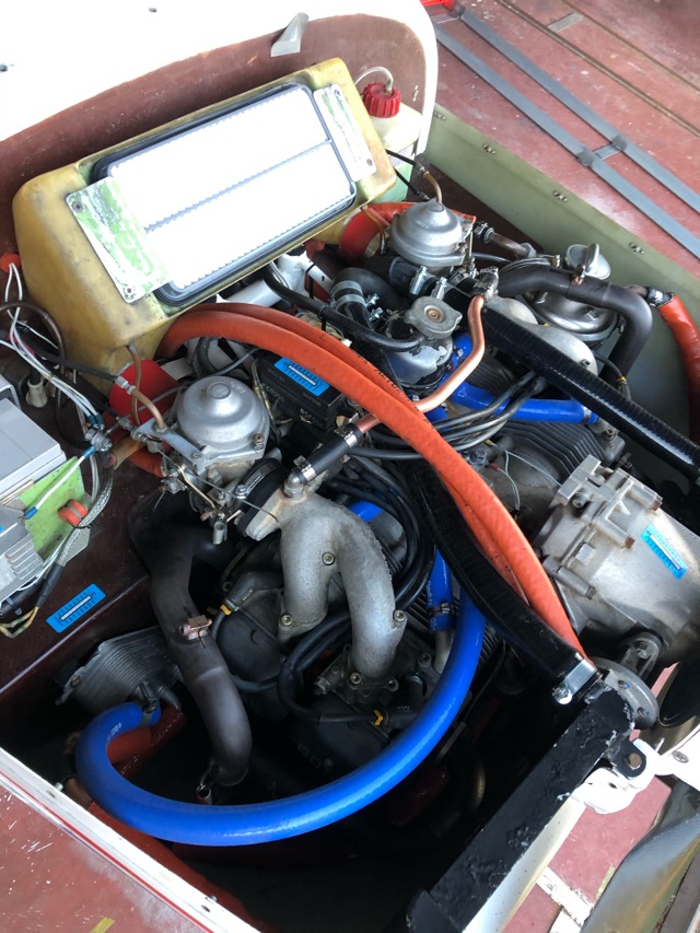

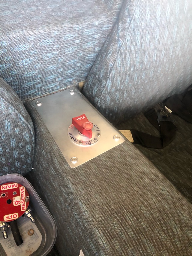

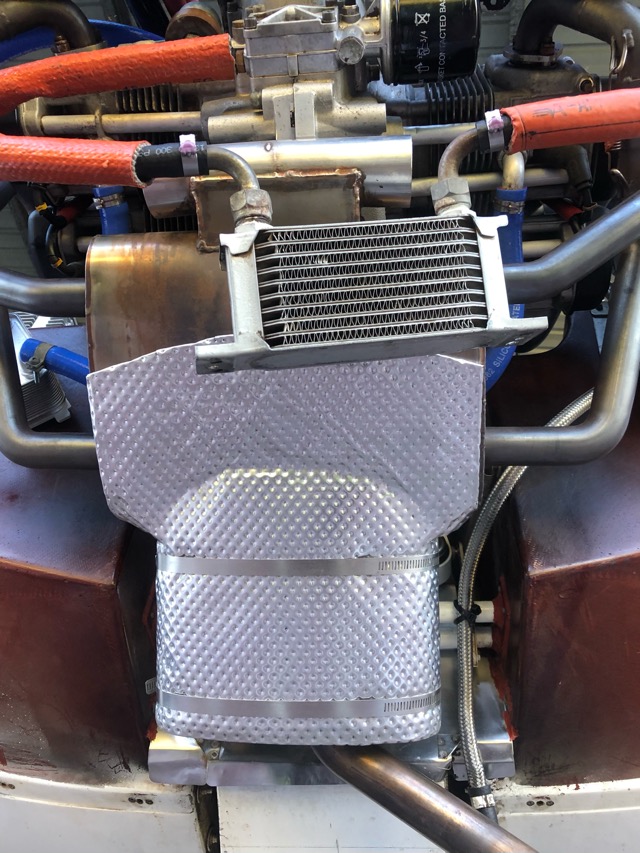

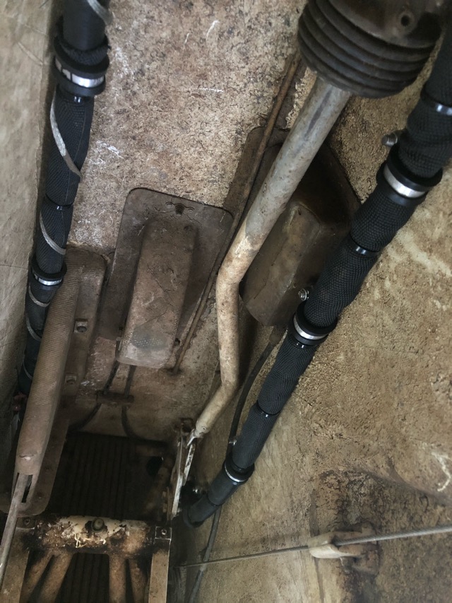

Five year hose change on the 912 plus all fuel lines from tank to firewall, fitted an Andair fuel valve, and carried out an annual... 50 hours of work cleaning up and rerouting stuff, fixing some very questionable work by the previous 2nd owner; some people should not be allowed near tools... the tunnel hoses were not fun; the original builder's work is awesome however no forethought had been put into this task; that's been rectified and set for the next 20 years... extended run up and a check flight after fuel pressure/flow testing.... Back in the air ready for some touring.

I like the way things are sealed in the tunnel. Very clean. Mine is pretty much all open.

[quote="n7188u"]I like the way things are sealed in the tunnel. Very clean. Mine is pretty much all open.
I get to breathe all the grass clippings when I land in sod runways :D .
Chris[/quote]
Yep, that's pretty much how they both were Chris; exposed... the return line was braided line and had never been changed; gave it a squeeze once removed and it cracked to pieces. It took three hours to remove both lines due to the way they'd been originally mounted. They are now both H/P fuel injection line with double layer sheath and standoff mounted for easy removal. They would probably be fine exposed but after extracting the old lines i didn't like the idea of needing to remove them ever again... since taking ownership of the aircraft and gradually finding what i have i can assume the previous owner would of experienced a string of engine failures relatively soon... glad i have managed to stay ahead of it all and save a good aircraft

[quote="n7188u"]It's a very good idea to inspect newly acquired used airplanes thoroughly. I once had an old certified airplane that took me 3 years to get it back to proper condition (and it was a flying airplane with current annual).
Also had a friend crashed his Pitts 1 week after acquiring it, with a fresh annual, because the engine quit right after takeoff due to a clogged fuel filter.
Never trust someone else's work ("Trust, but verify" goes the saying)
BTW, all my fuel lines are exposed in the tunnel but high quality Gates Barricade. I figure I'll change them in 5 years(ish) and they are not exposed to UV. But nothing wrong with what you did!
Chris[/quote]
Thanks Chris, the plane looks great unpainted... also used Gates Barricade; the efi hose is a lot tuffer than the standard carburettor spec hose; all the oil lines are now Parker 7212 Push-On (Push-LokPlus is a higher spec hose and better choice for more rigid bends though).. i had a reputable LAME perform an annual upon purchase before ferrying it back, and then fully went over it myself performing point inspections and maintenance checks prior to further flying. It was sufficient but many things not to my standard. The undercarriage is good on visual and will be getting a deeper inspection once i make up a suitable service stand.
