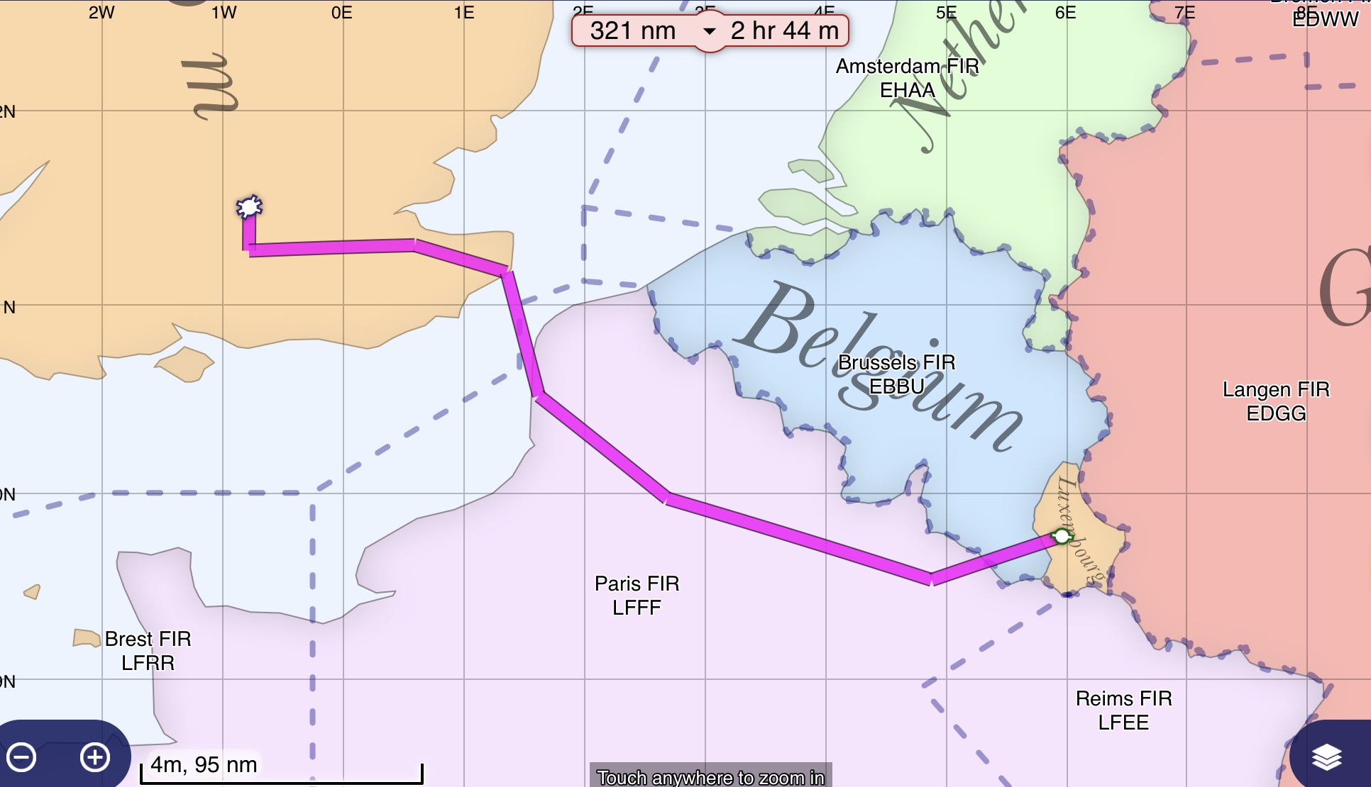

Made my first foreign trip for 3 years. Attended the Europa Club Fly-in to Luxembourg. Flew from White Waltham in the UK via Le Touquet and Albert Bray in France to Useldange in Luxembourg. A stellar event. Joined by 28 other Europas. Great camaraderie.

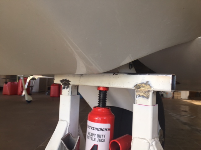

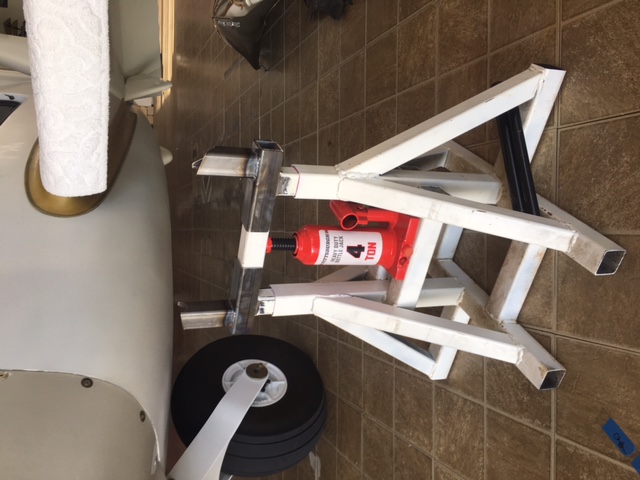

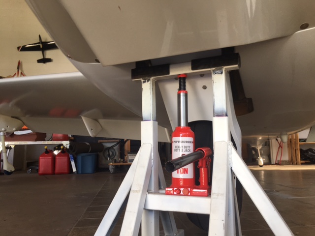

And last, Thanks to Ron P. for sending me a lift built by Bob B. After some minor modifications I got it working. The only thing that was wrong was that the standoff points that hold on to the LG shaft were a little short and would contact the LG arm as the airplane was lifted. I made new ones a little longer and now perfect. I made then removeable to make it easier to slide the lift under the cowling and then insert the lift standoffs. So any thanks to Ron and Bob. I do need to paint it though as I want it to be pretty!
