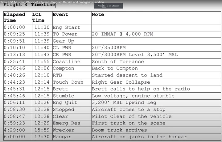

Engine stumbled at 36:17 in the video... went from 4k to 1k rpm and back up to 4k twice.
At 42:13 in the video the engine quit.
At 43:00 in the video he mentions checking switches and circuit breakers but it's not clear to me he checked the 30A main bus breaker that is higher up on the right. By this time he had tried to shake the gear down a couple times and he was glide-able to the airport.
Events are tabulated at 50.37 in the video... clip of table attached here. Stumble at flight time 45:46 and quit at 56:11.
 Filesize:  93.32 KB
