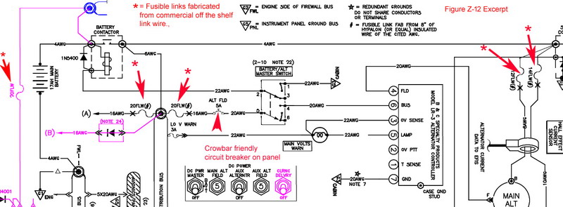

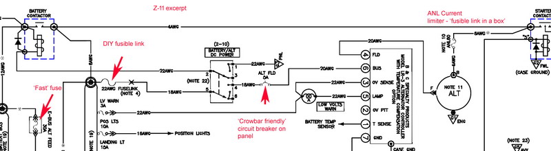

But in diagram Z12 I still don't see a fusible link in the circuit that feeds the alternator field. What am I missing? I see a 5A field breaker at the main power buss. From there a 20AWG wire feeds tab 5 of the master switch. From tab 4 of the master switch a 20AWG wire feeds pin 6 of the B and C LR-3 controller. A 20AWG wire from pin 4 of the controller feeds the alternator field. I don't see a fusible link in this circuit as I do in diagram Z11. The system in Z11 uses fuses and Z12 used CB's. Does this make any difference?
Here are the relevant excerpts from Z-11 and Z-12. There's
a fusible link upstream of alternator field breakers
in both diagrams. Z-11 is an older drawing that suggests
a '4AWG-smaller', DIY fusible link while Z-12
suggests commercial-off-the-shelf, fusible link wire.

PostPosted: Sat Apr 23, 2022 2:59 pm    Post subject: Re: FUSIBLE LINKS & CURRENT LIMITERS Reply with quote
nuckolls.bob(at)aeroelect wrote:
Hi Bob,
... help me understand the fusible link between the buss and master switch in Z11, but there is no fusible link in this circuit in Z12.
The latest Z12 rev N shows a fuse link for the feeder from main bus to field CB. The previous rev M which is in the latest AeroElectric Connection book rev 12B shows the field CB directly on the bus. Fuseblock or busbar and CBs (acres of breakers)... it's a culture war and Bob in in the fuseblock camp. I'm guessing the older Z12 reflects a production aircraft.
Find the latest Z templates in the Adobe folder at http://www.aeroelectric.com/PPS/

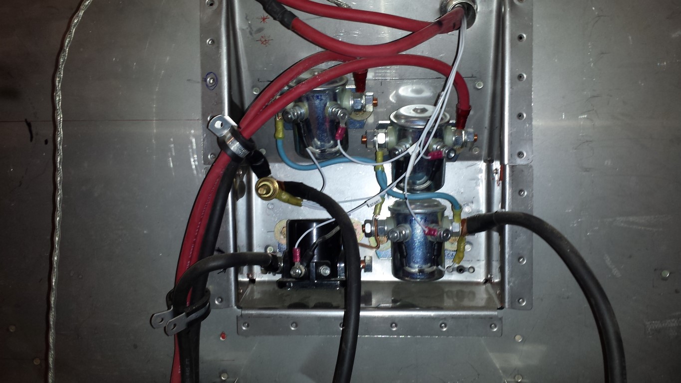

PostPosted: Mon Apr 25, 2022 6:07 am    Post subject: FUSIBLE LINKS & CURRENT LIMITERS Reply with quote
   I saw a builder's contactors installation
   wherein he used fusible link wire to make
   a connection between the power posts on two
   contactors . . . no splice to extending
   wire.
Guilty. Wink
The top pair of contactors control the B-leads of two internally regulated alternators; the blue wires are fusible links to protect the red B-lead wires seen leaving the contactors.
Without a long drawn-out explanation, the reason one is on the 'hot' side of the master is that the plane has a fully electrically dependent engine; I wanted access to an alternator even if the master contactor failed. (Engine bus primary feeder is also fed from the hot side.)
Charlie
