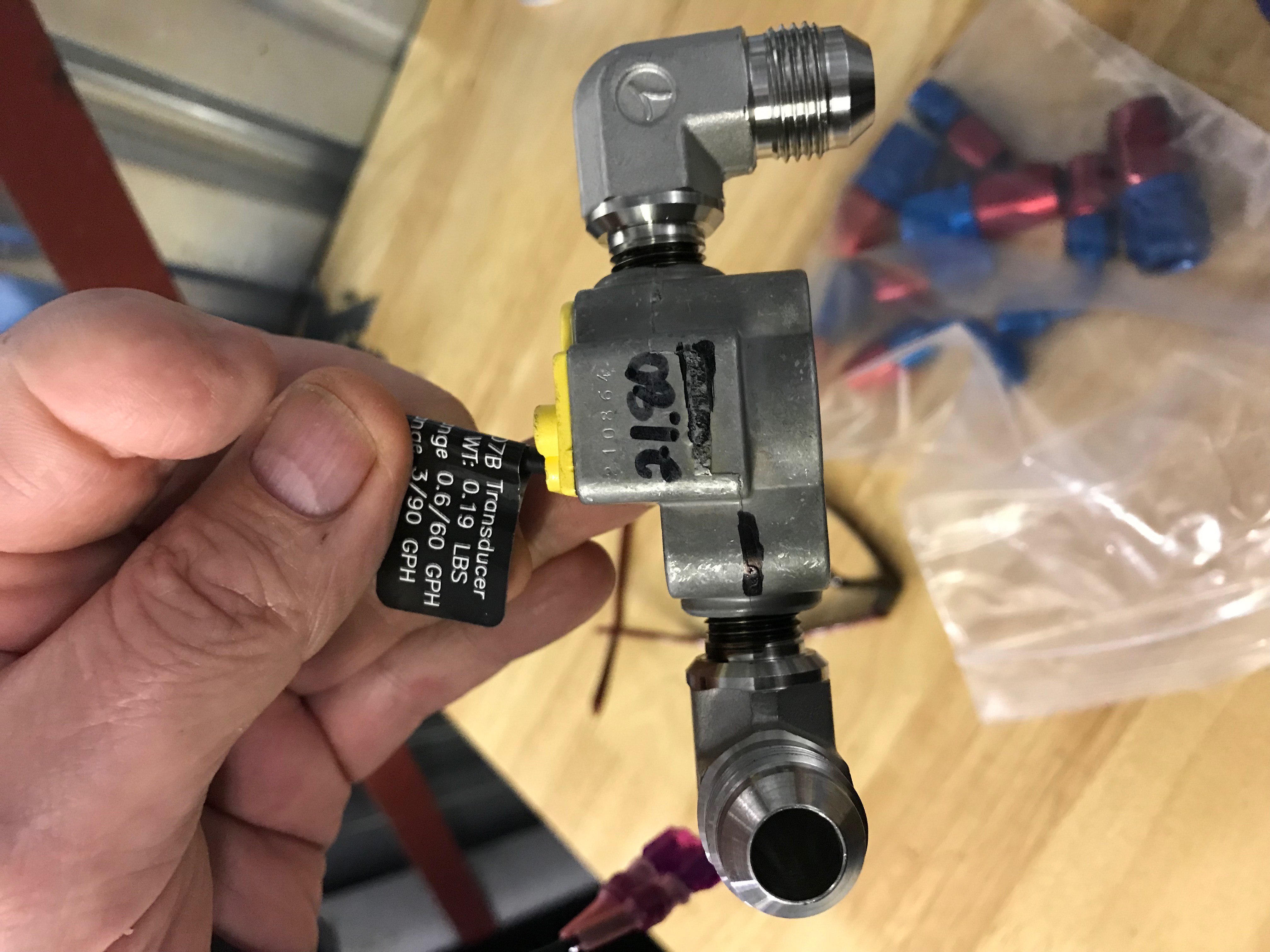

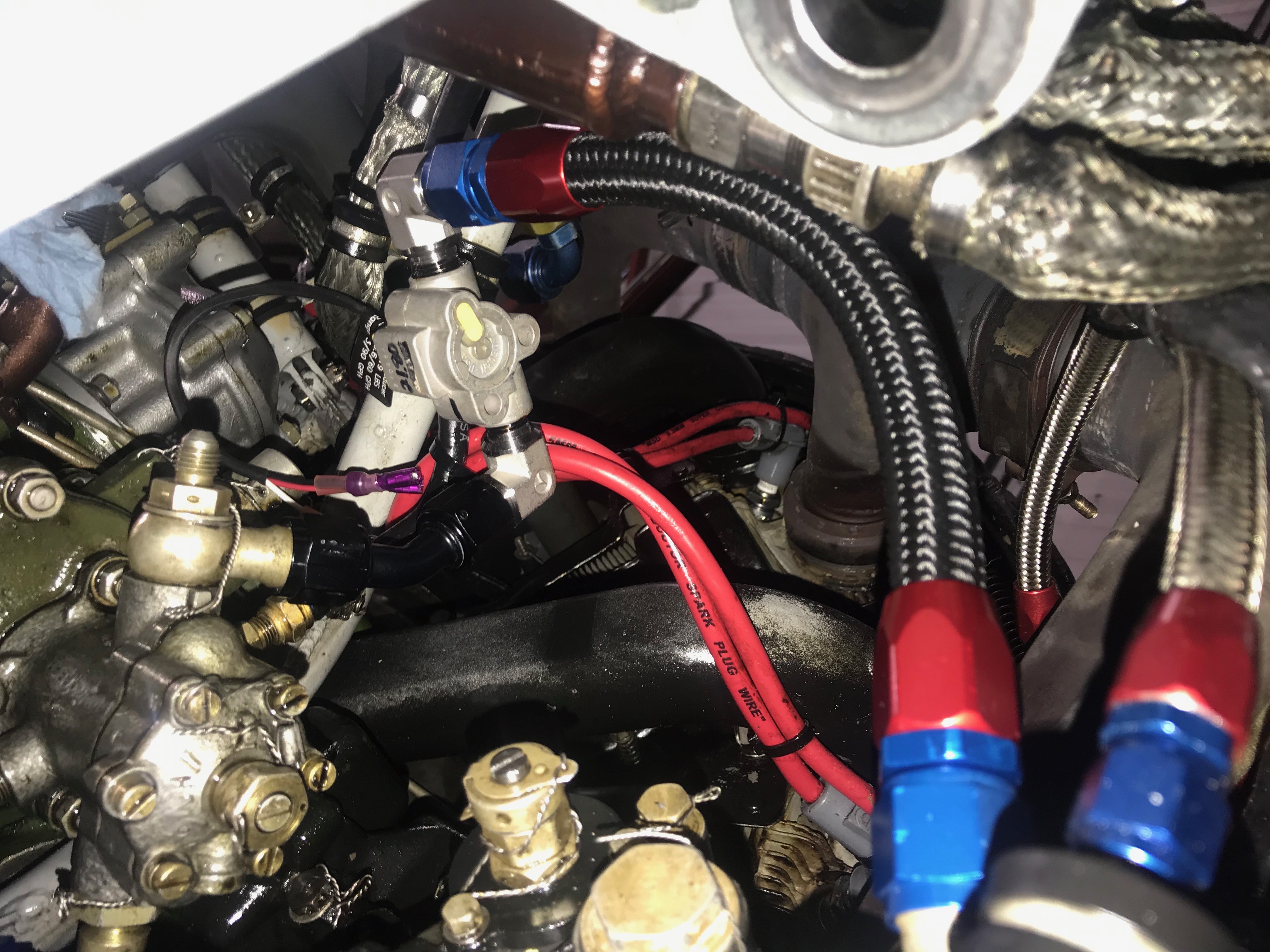

I installed the JPI on my M14P as well.  You will love it.
The hose shop should use a similar size to the existing metric fittings on either end.  They[img]cid:17e6a326a649836dd2b1[/img]
[img]cid:17e6a327c53fc7cf12c2[/img]
will tell you what they used.  You will need two fittings in the JPI transducer to match what they put on the hose.
I purchased two new fittings.  One is the banjo fitting on the fuel pump.  The other was the inlet to the carb.  Both are AN.   Used a solid pipe AN on both sides and mounted to the pump outlet.  Made one new hose to the carb inlet.
See attached photos.  The one photo is looking up from the bottom.
JPI will know what you need for a transducer.  They will confirm your fuel burn max flow.
