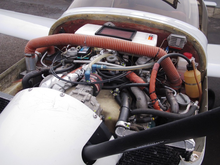

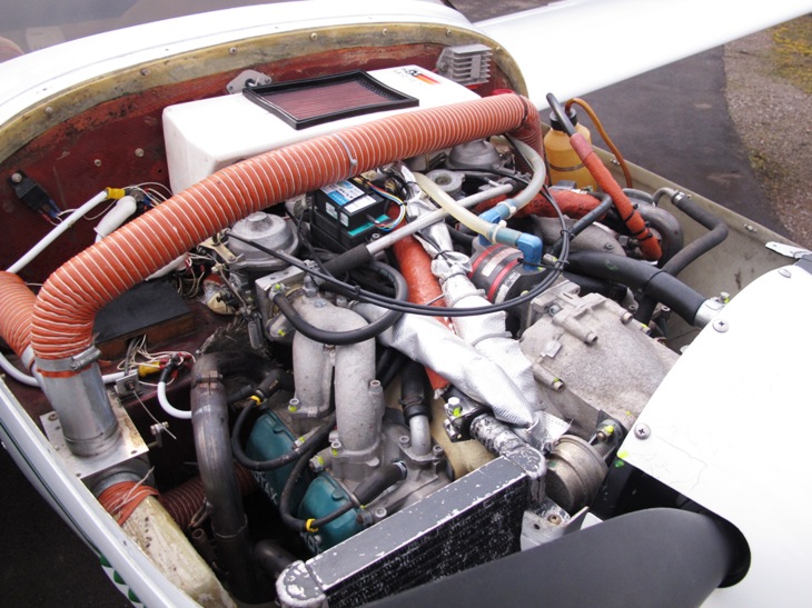

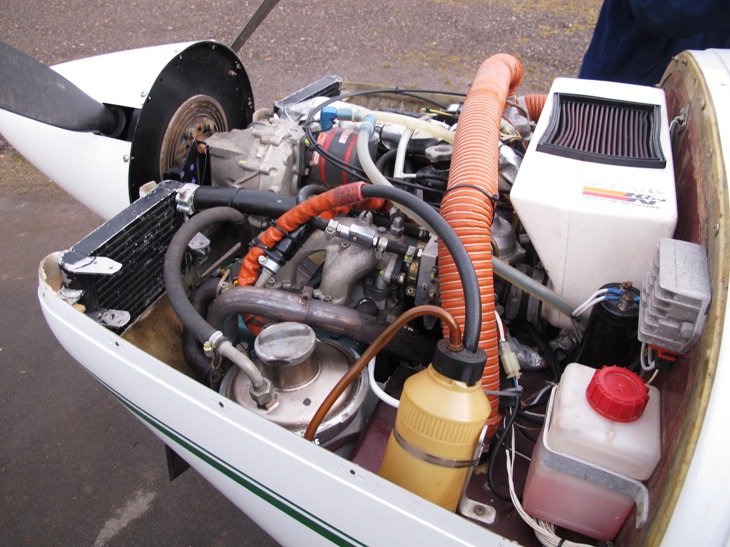

But could do with a little help with the radiator hose placement . If anybody as photos of the routing of the hoses I would be grateful . I think I see how it goes but a little reassurance would be nice .

few pics

Hi stranfaer ?
thanks for the photos ,show me what I wanted to know .

The lower hoses interconnect left and right cores; it runs under the front gearbox bearing flange. Use high quality hose clamps and retention them when everything is at operating temperature and the motor is switched off.
The cores will support themselves with the lower cowl removed; the oil cooler may need zip ties until the cowl is refitted; i’ve found supporting the lower cowl on an upturned chair while refitting the oil cooler to it to be very helpful.

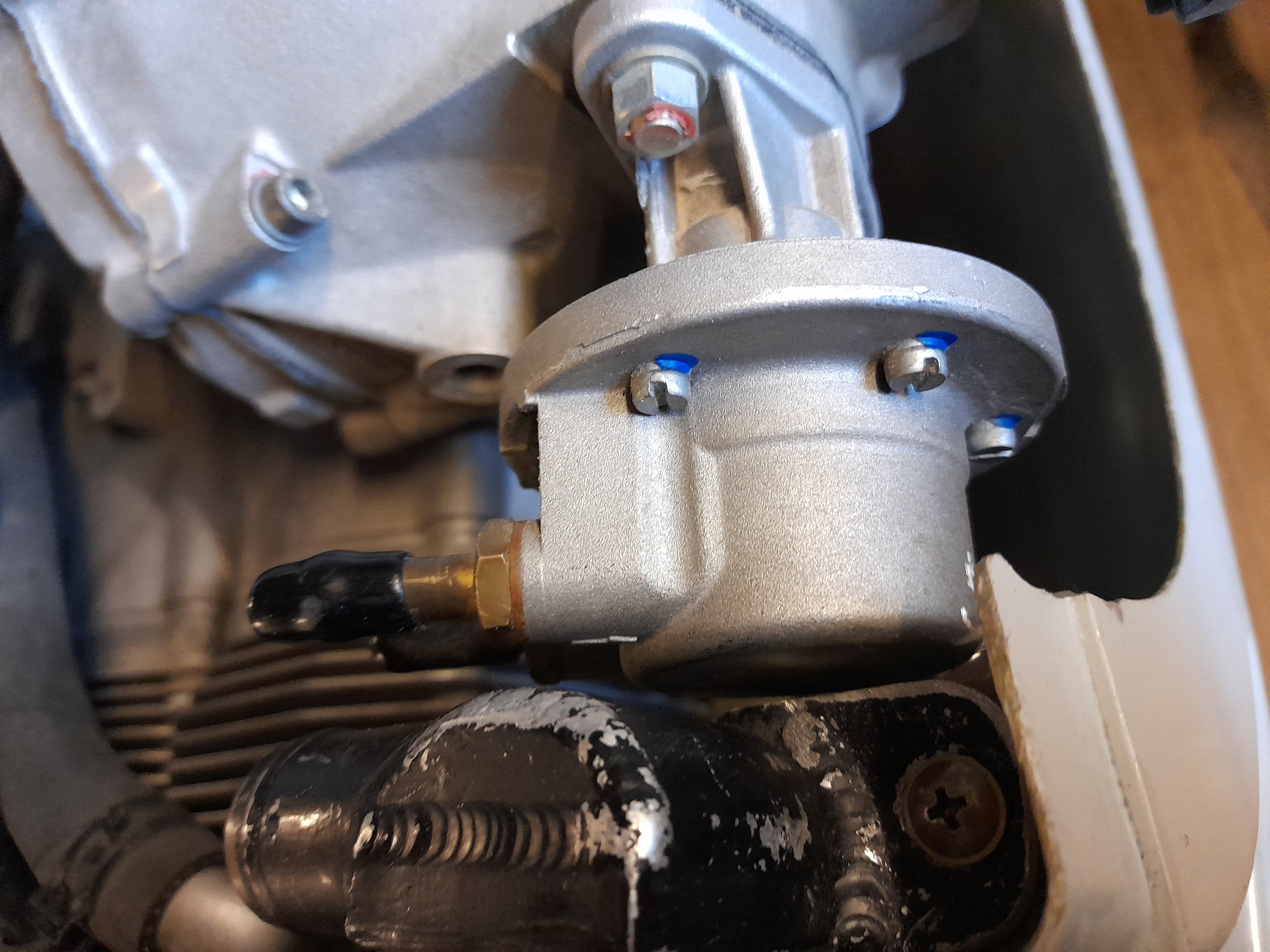

Depending on how old your motor is you may wish to consider mounting the right radiator as far outboard as you can as replacement fuel pumps are longer than the older model and it will have to be replaced at some time.

The earlier model fuel pumps have pressed together bodies; later are screwed together and have an oil drain on the underside of the pushrod body; attached picture is of later model fitted. The pictures above show the earlier style pump.

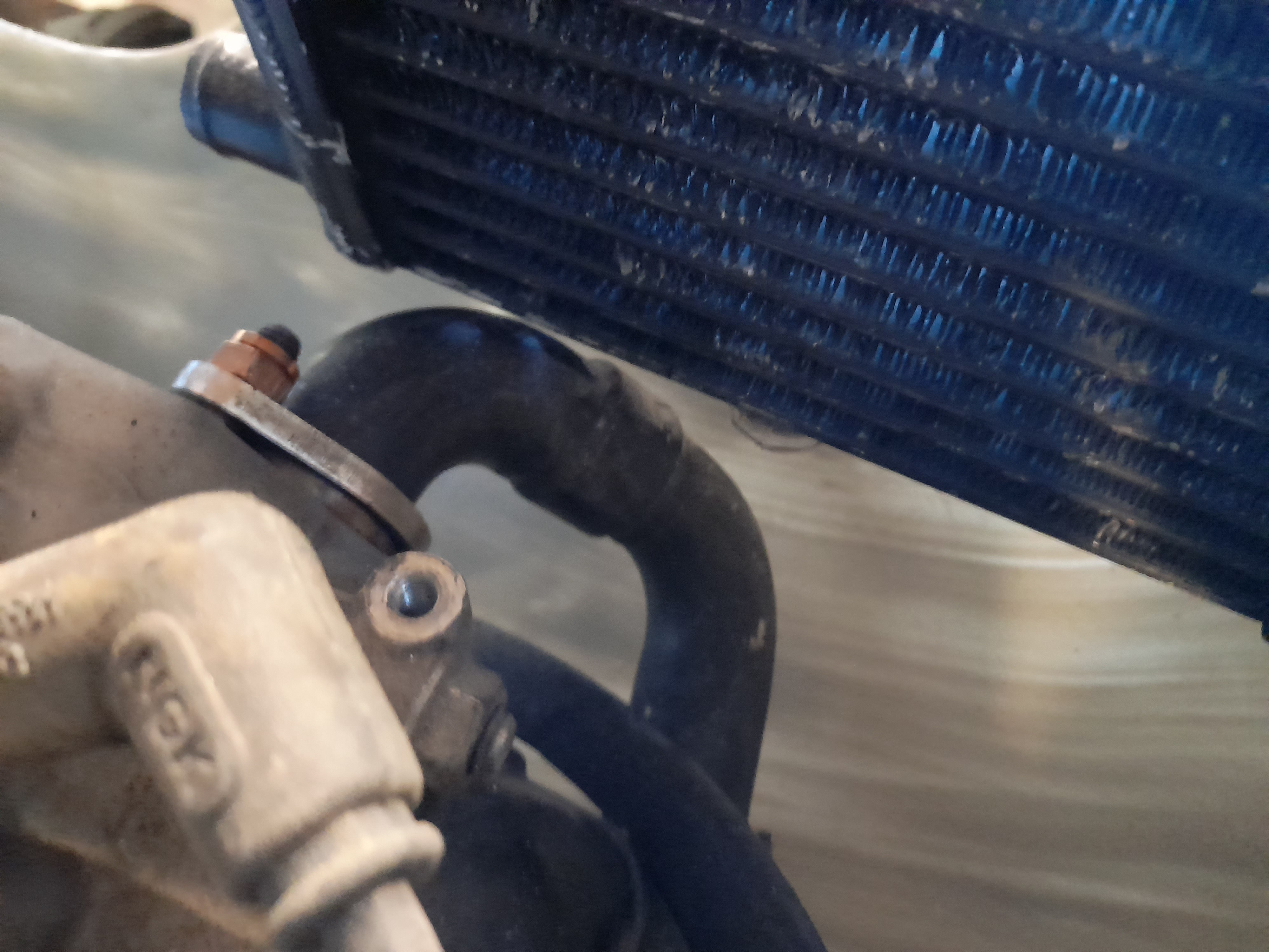

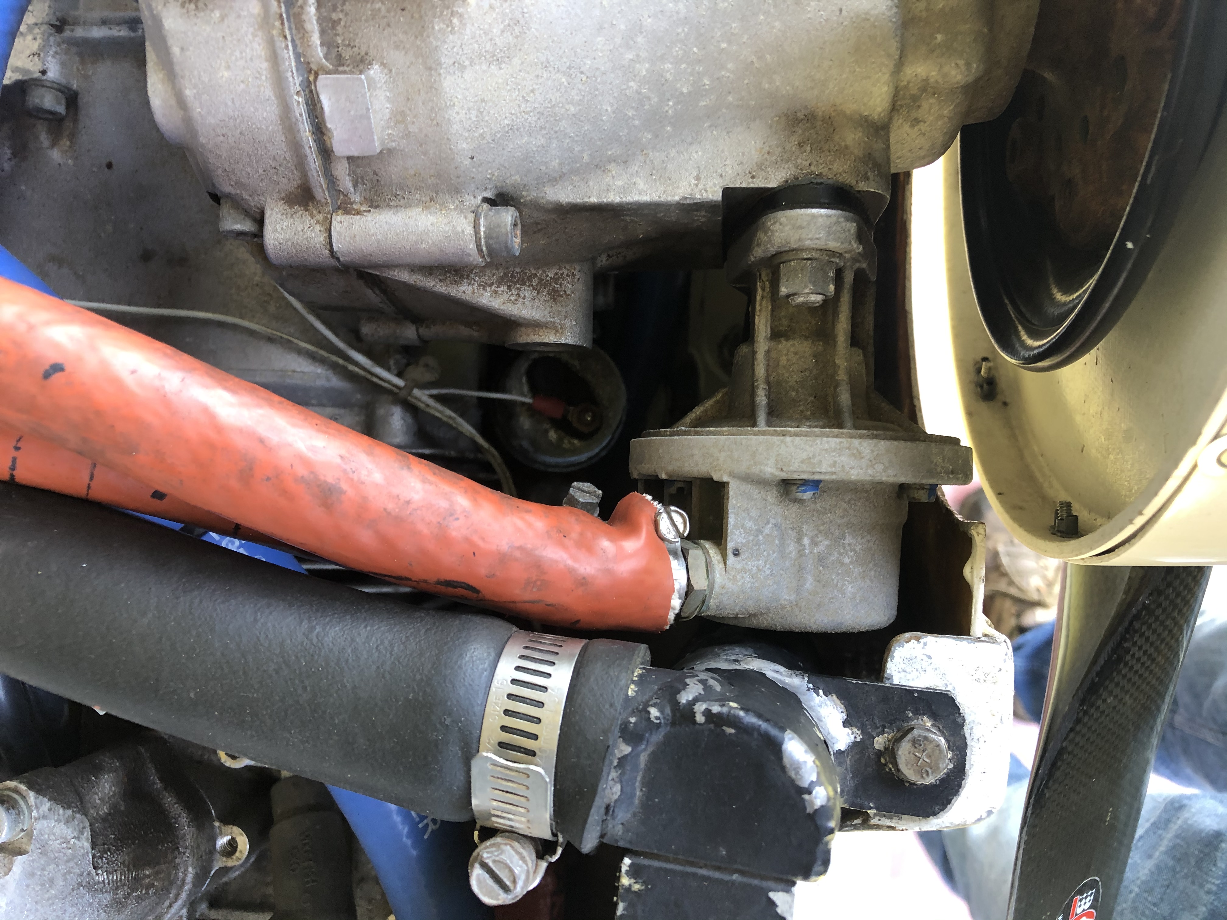

Here a couple of photos . is the gap from the exhaust ok?

PostPosted: Fri Jan 07, 2022 10:52 am    Post subject: Classic Radiator set up help Reply with quote
wrt to the pics, all I can say is i have more clearance in my classic.
also, keep in mind that the engine will move forward slightly with a loaded prop.
