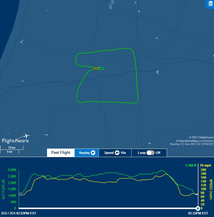

The snow on the ground earlier this week did indeed melt by Friday afternoon. We were able to get in a short local flight under 2500 OVC ceilings to finish the year. Snow is forecast this weekend and temps below freezing so our grass strip will be snow covered and unusable. We added Stabil and put our Europa away for the winter.

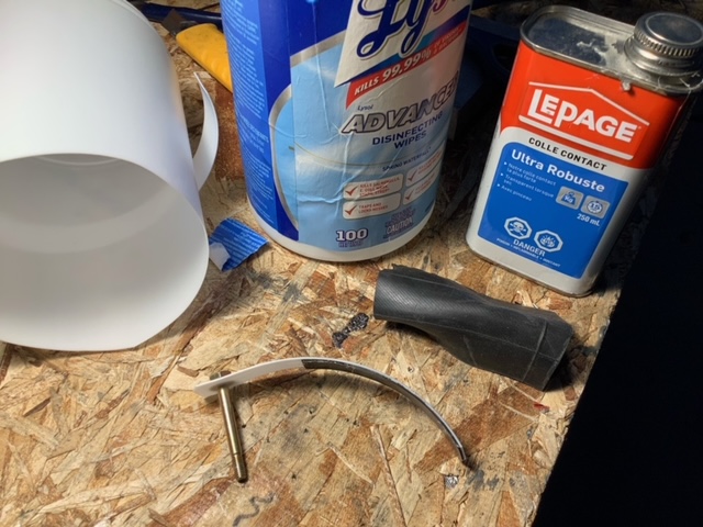

Put another ~8hrs of boring holes in the sky, moving the AOA vane forward incrementally to find the sweet spot for the best dynamic range (without it being beyond the leading edge), and after brainstorming with Ron P., added flow deflector brakes to the outrigger wheels- which get spin’n pretty darn good at cruise….still to be tested.

Peter, never heard of the outrigger spinning bit before and it’s very interesting. I’m battling vibration and whistling at high speeds and this could be one thing for me to try. Thanks for posting it.

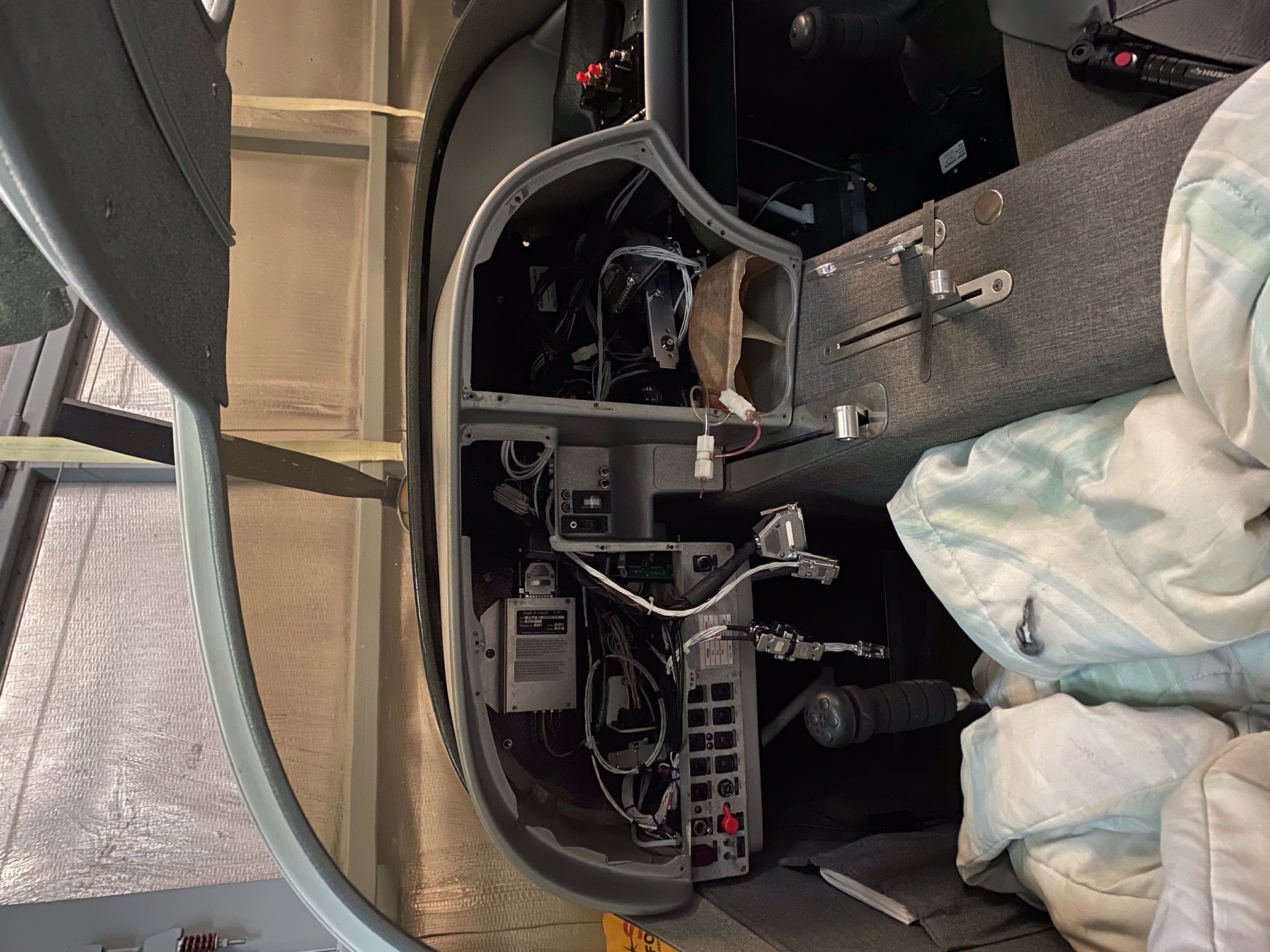

Well, this week I started on a panel upgrade. I am adding a Garmin G5 as a backup to my Dynon Skyview as well as a Garmin GPS175 IFR navigator. With the help of my wife I relieved the instrument panel surround to accommodate the G5 (above the gear handle rebate) and relocated constant speed controller (top of the center stack). I will also need to relocate the Dynon transponder which was located behind the panel as the navigator will occupy that space. The transponder will reside under the aft baggage bay. I am also upgrading the coax from RG58 to RG400 for the comm radio and installing new RG400 for the GPS. I fabricated a couple of the wiring harnesses and am currently making a mounting bracket for the G5. The IFR navigator arrived today so I can start work on mounting the tray to the center stack.
