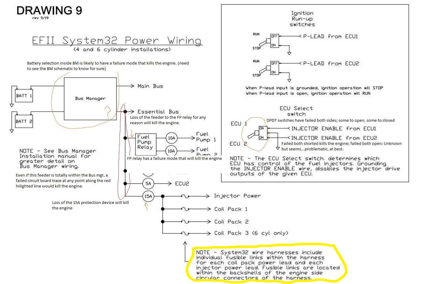

In a belated attempt to not derail Michael's electrical system thread, I'm starting this one to ask Charlie for more details on the possible problems with EFII's System32 fuel injection and ignition system when the electrical system architecture is based on the EFII Bus Manager.
I have been hired to test fly an aircraft with this system. Haven't been able to get off the ground yet due to multiple setup problems and wiring mistakes but none of these were related to the Bus Manager.
Charlie I would be very interested to hear anything you have to say FMEA wise about this system.
OK, for a start, here's a marked up copy of that page from the install
manual. I've likely overlooked some stuff in the quick run-through I
did, and could be more accurate with an internal schematic + board
layout of the Bus Manager. But I've marked six ways the system can kill
the engine, and highlighted a seventh *possible* way; I'd want to see
exactly how up to twelve fusible links are installed within the
backshell of the BM connector. Fusible links may or may not generate
enough heat to be a factor in any wire near them. They're typically
thermally insulated to protect other wires around them but they're
typically not tightly confined in an enclosure (the backshell, in this
case).
As I said, it's difficult to completely evaluate the system without the
BM info. The drawing shows an external 'daisy chain' connection path
(circled in red) to the various components, but the yellow circled text
seems to indicate that path is inside the BM. Having said that, things
like the ECU select switch are likely to be external.
Hope that's at least some food for thought, and maybe others will have
some input, as well.
Charlie

Thank you Charlie,
1. What is the failure mode of the relay that could kill the engine?
2. You mentioned DPDT switches can fail to both shorted, is this something that happens when you flip the switch or can the switch just be sitting there and fail?
Thank you,
Sebastien
case).
Fusible links are NOT replacements for fuses.
Fusible links are ROBUST protection against
hard faults and are used in power distribution
feeders like alternator b-leads, extension feeders
between busses, some battery installations, etc.
They are RARELY suited for protection of
individual loads.
What is the rational for protecting these
feeders individually in the first place?
Manufacturer's recommendations? Consider
REAL fuses if a FMEA warrants such protection.
  individual loads.
I'll take another swing, since I wrote the quoted text (it should be obvious from the text that I don't care for the actual product being discussed).
My yet-to-fly EFI (NOT FlyEFII) has separate fuses for each injector and each coil. The reason I did it is that it's dirt simple to do, weighs only a few ounces, and isolates each item from all the rest in case of a failure. No doubt that's why FlyEFII used individual fusible links, too.
Logic: If running a carb, you can't isolate fuel delivery to each cylinder; you're stuck with one delivery point. Not much difference with 'traditional' a/c fuel injection. But with electronic injection and dual controllers, it's relatively easy to isolate the feed to each device so that a failure along one path will not cause the entire system to go down. That kind of issue is what I was trying to describe in the marked-up version of the wiring diagram; eliminating points where a single failure takes the entire system (in this case, the engine) offline. I consider being able to effectively isolate each cylinder (or pair of cylinders, with some coils) to be a significant advantage with electronic injection over traditional systems. (I do recognize that the added installation complexity can be a negative factor.)
As to the fusible link vs fuse question: I used links in several (all?) the places you mention, for the same reasons; they're as reliable as the wire itself, fewer mechanical joints, and the only reason they would ever need to act is in a catastrophic fault situation. While I haven't installed them for my injectors & coils, I can see justification for using them there, for the same reasons. One shorted coil or one shorted injector will almost certainly burn itself open before either its fuse or, if used, a fusible link would activate. So the only reason for branch protection is the catastrophic failure mode of a shorted wire. Using the links reduces the number of mechanical joints (transitions) in the path to the device.
FWIW,
Okay, if that's what the mfgr wants. But generally
speaking, fusible links are in the same class of
protection as the ANL current limiters. They take
10x longer to open under same 'rated' loads . . .
and make smoke.
Also watch for situations where one fusible
link is supplied from another fusible link
upstream. You have a I(squared)R timing
dynamic to consider for series connected
circuit protection.
