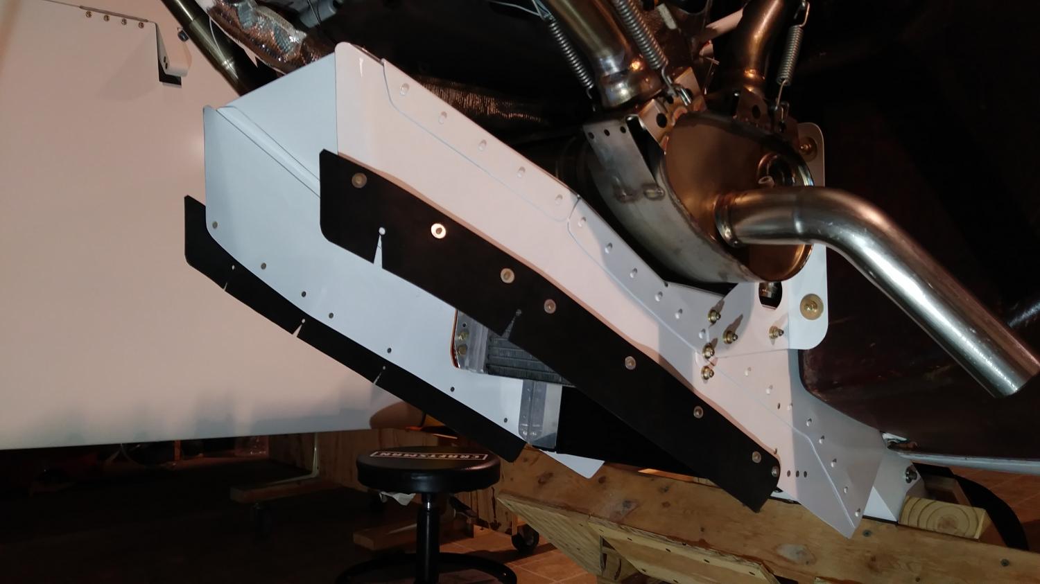

Marcel, unfortunatedly I couldn't find a good picture of the baffling on the radiators and the difusers. The oil cooler has two baffles on the sides (that I do show a picture of) and one on the bottom that is flexible to bend and provide seal pressure against the cowling bottom. If I remember to take pictures of the existing baffles when the lower cowling is off I will.

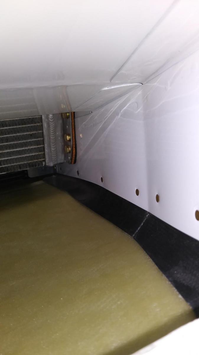

You can also see that the sides of the water cooler have been filled with firewall material and black RTV. The black RTB is bonded to the firewall material but not the duct for easy removal.
You can see the baffle at the sides of the oil cooler.
Water cooler sides and duct to cowling
 Filesize:  41.22 KB
 Viewed:  8983 Time(s)

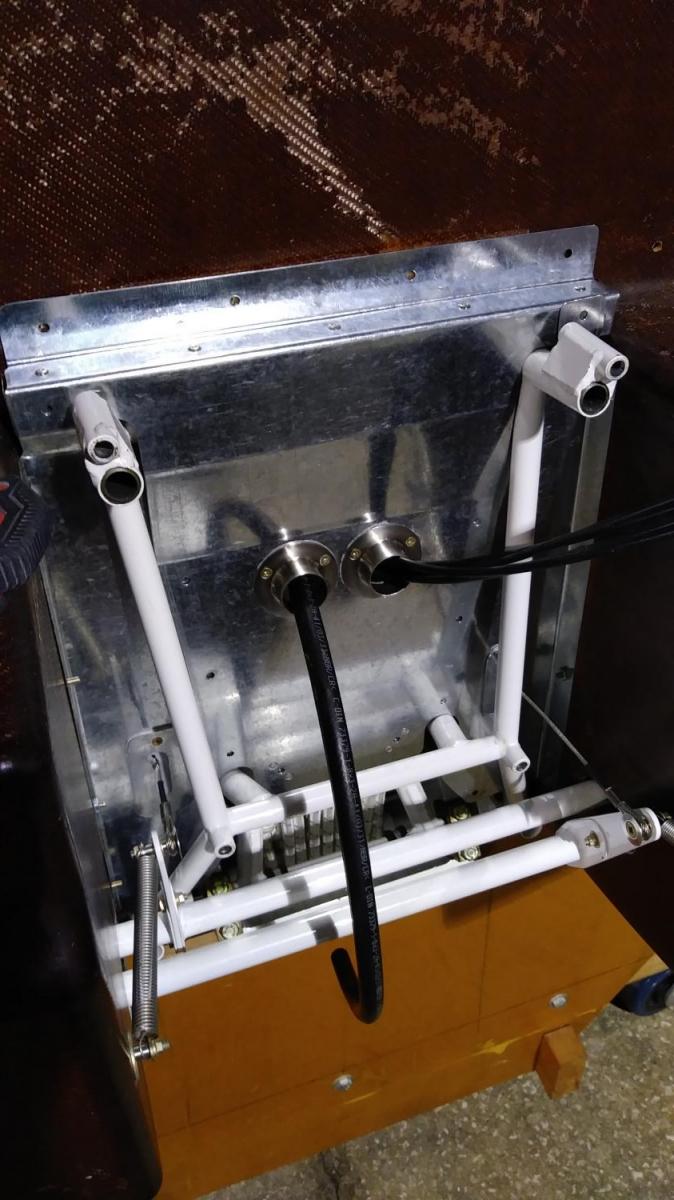

Bud Yerly mono firewall. A lot of small pieces but works great.
 Filesize:  99.88 KB

Hi Chris Curious, what's the tan colored stuff by your baffle seal on the white paint?
Thx. Ron P.

PostPosted: Wed Nov 17, 2021 8:01 pm    Post subject: Re: Oil temperature issue during climb Reply with quote
Ron, it’s just leftover firewall material. The radiator was a tad narrower than the duct and needed something to fill the gap.

PostPosted: Thu Nov 18, 2021 10:23 am    Post subject: Re: Oil temperature issue during climb Reply with quote
Hi Chris
The tan that I'm curious about is on the first pic you posted, on the outboard side of the radiator duct on the left side just above the black baffle seal. Perhaps adhesive? Or?? Thx. Ron P.
n7188u
Joined: 15 Nov 2015
Posts: 408
PostPosted: Thu Nov 18, 2021 10:26 am    Post subject: Re: Oil temperature issue during climb Reply with quote
Oh, I see what you mean.
There is actually nothing there. Must be a shadow from the flash Smile The seal is just riveted in place.
