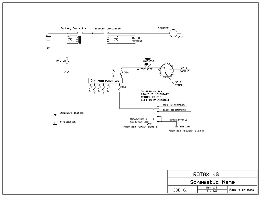

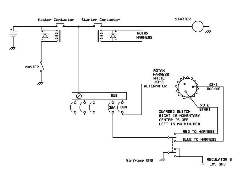

X3-3 is missing from your schematic.
I suggest that the relay be eliminated. It is an unnecessary failure point.
Simpler is better. If it is not installed, it can not fail.
Having 2 buses seems like a good idea, but complicates the electrical system.
If panel switches are arranged in order of importance from left to right, then in the event of alternator failure, the pilot can shut off switches on the right side to conserve battery energy. There is no need to shut off a whole bus. The pilot has the option of turning individual loads back on when needed.

Thanks, Joe. I appreciate you taking a look at this and posting your schematic.
Yeah, I didn't bother with the Start Power switch since the Fuse Box wasn't shown. I'll definitely include X3-2 and X3-3 when I flesh out the schematic.
That's certainly true, but the likelihood of relay failure is very remote and I much prefer a hidden relay to a row of additional switches on the panel. I also like the simplicity of a 1-step response that properly configures the aircraft for maximum endurance. When the engine quits my IQ will drop by at least half, and the Engine Failure Checklist will already be long enough:
- Best Glide Speed - ESTABLISH
- Landing Site - CONSIDER
- Fuel Quantity - CHECK
- Fuel Shutoff Valve - ON
- Fuel Pumps - BOTH ON
- Lane Switches - BOTH ON
- Backup Battery Switch - ON
- Engine Start Switch - PUSH
The relay module can easily be tested before each flight:
- Battery Master Switch - ON
- EFIS Display - CHECK OFF
- Backup Battery Switch - OFF
- EFIS Display - CHECK ON
It could fail two ways, open or closed. If it fails open on the ground, it will be immediately apparent before flight. If it fails open in flight, some avionics are lost but there is no jeopardy to the engine. If it fails closed any time after the pre-flight test, it has no effect unless both alternators also fail (near-zero chance on the same flight), and the failure will be detected before the next flight. The cost of components is ~$5 per module, so I would probably build two and keep a spare on the shelf.
I don't think shutting off a bus carrying only non-essential items is a major concern. Losing the EFIS sounds ugly but I'm comfortable flying without engine instruments long enough to get on the ground, I'll still have a fully charged iPad to navigate with, and the comm radio will still be working, so I can get help if needed.
Eric

It looks like the relay will be energized whenever the engine is running. If the engine quits, you will turn on the backup switch. So the relay will still be energized and depleting the battery that is needed to keep the engine running. Or is my reasoning wrong?
Joe Gores
yellowduckduo(at)gmail.co
Correct. As long as the Backup Battery switch is open, the P-channel MOSFET is turned on by the pull-down resistor on its gate, allowing current to flow through the relay coil.
No, turning on the Backup Battery switch applies ~12V to the MOSFET gate, turning it off, which stops current flow to the relay coil. I've confirmed that there's no current path from pin X3-3 (normal power input) to pin X3-1, so there's no voltage on pin X3-1 in normal operation.
HOWEVER... It turns out that pins X3-1 and X3-2 are shorted inside the Fuse Box, which makes sense given that the Backup Battery and Start Power switches do essentially the same thing. This means that closing the Start Power switch will open my relay, which is definitely not the behavior I want.
Thanks for making me think this through, Joe. VERY helpful!
Eric
user9253
Joined: 28 Mar 2008
Posts: 1978
Location: Riley TWP Michigan
PostPosted: Tue Oct 05, 2021 9:39 am    Post subject: Re: Integration of Rotax 912iS Reply with quote
There might be voltage on X3-1 when the engine is running if using EMS Ground as the reference point. That should not disable the transistor which uses airframe ground. Isolated grounds make it confusing.
Joe Gores

I admire your ability to design your own over-voltage protection circuit. Can it be designed to just open the relay without blowing a 1 amp fuse?
Your Skyview must not have a backup battery since there is a brownout booster.
Is the autopilot switch momentary in both directions, center off?
Airframe bus shed:
I believe that one of the 3 relays inside of the Rotax fuse box is used for that function. No external control is necessary.
Those 14AWG bus feeders are protected by 18AWG fusible links at the Battery Bus. That's one of my questions: is this an appropriate use of fusible links?
Yes it is. Having fuses in series is not a good idea, even if they are different sizes.
Big Mistake:
Regulator "B" ground lug should NOT be grounded to the airframe.
When running, the Rotax iS engine has an isolated ground.
Suggest that the battery bus and airframe bus be combined into one bus called the MAIN BUS. Eliminate the relay. Replace the 12 position fuse block with a 20 position.
Two switches can be reduced to one. See attached picture.
 Filesize:  17.11 KB
 Viewed:  19153 Time(s)
Oops, that's another mistake. I meant to power that module through a resettable circuit breaker instead of an inaccessible fuse. I believe that's Bob's recommendation anyway.
Correct. I don't want the expense or maintenance burden of a backup battery. All I care about is keeping the EFIS alive during engine starts. It's a VFR-only airplane.
Yes. That little circuit is lifted directly from one of Bob's designs: http://www.aeroelectric.com/Reference_Docs/Misc_Pdf/AP_Disconnect_B.pdf
Airframe bus shed:
Well, sort of. If the B alternator fails or is switched to engine duty to replace a failed A alternator, the Fuse Box will cut power to the rest of the ship. However, since the Airframe Bus can get electrons from the battery, the Fuse Box switching won't cut it off.
Excellent, thanks.
Big Mistake:
I think you might have the A & B regulators mixed up. The engine normally runs on the A regulator. The Rotax diagram shows the "Regulator A Plate" tied to "EMS Ground" and the "Regulator B Plate" tied to "Airframe Ground."
I thought about that, but I designed the Airframe Bus to power everything that I don't need to continue flight to a safe landing. By separating the buses, I can maintain the Backup Battery function and feed the Endurance Bus, but I'm able to shed all unnecessary items by throwing one switch.
Yeah, that would definitely work. From a human factors perspective (simplicity and reduction of confusion), I'd prefer to keep the Backup Battery and Start Power functions separate. Switches are cheap, and the odds of both failing on the same flight are about nil.
Thank you, Joe!

PostPosted: Wed Oct 12, 2022 6:18 pm    Post subject: Re: Integration of Rotax 912iS Reply with quote
OOPS, my Big Mistake. You are right.
Joe Gores
