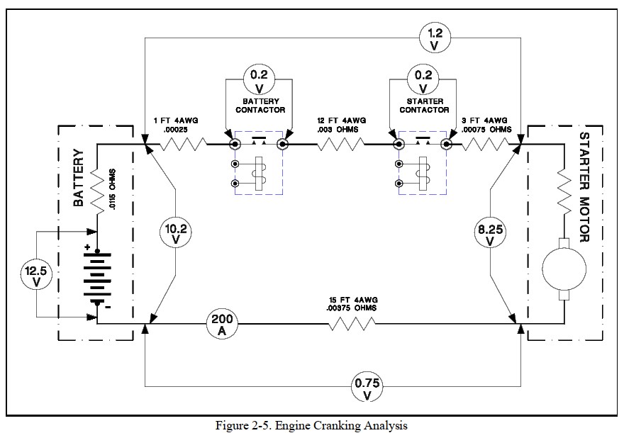

10AWG wire is 0.001 ohms per foot. For every 3AWG steps in
wire size, resistance varies by a factor of 2. Hence
7AWG wire would be 0.0005 ohms/ft; 4AWG would be
0.00025 ohms/ft; 2AWG would be approx 2/3rds of the
way between 4AWG and 1AWG of 0.00012 ohms/ft. Let's
call it about 0.00016 ohms/ft. If you'd like a hard-copy
look-up, here's but one example https://tinyurl.com/4jw4heeh
For broad brush estimating, let's assume 200A for
a average starting current. So, 10 feet total 4AWG
wire in your cranking loop would drop 200A x 10ft x
0.00025 ohms/ft = 0.5 volts. An acceptably small
value. Replacing it with 10' of 2AWG would yield
a voltage drop of 200A x 10ft x 0.00016 = 0.32 volts
or 180 millivolts! If your loop is less than 10'
then the improvement is still smaller.
The attached figure is purloined from Chapter 2
of the 'Connection. In this figure I hypothesis
cranking performance of a 4AWG cranking loop in
a canard pusher . . . i.e. LONG cranking wires.
As you can see, even with these wire lengths,
cranking voltages are rather nominal. Starter
motors EXPECT to see voltages on the order of 9
volts.
In any case, up-sizing wire from 4 to 2AWG produces
about 30% improvement only in WIRE drop while doing
nothing for internal resistance of battery and
voltage drops across other hardware in the loop.
I suggest that with few exceptions (IO-540
engines in a composite seaplane - that airplane
hand a cranking loop of 48ft! We ran doubled
up strands of 2AWG), 4AWG will suffice
nicely for the cranking loop especially
in a metal airplane. A more detailed analysis
is called for in LONG runs on composite aircraft.
