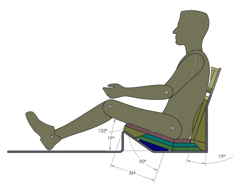

PostPosted: Fri Aug 27, 2021 11:07 am    Post subject: Re: N11EU Update Reply with quote
Hi Pete,
I removed the picture because I first want to obtain permission from the photographer that took it. Once I have that will post again.
On the RPM part thanks for the heads up. Yes, I am familiar with that subject but I have decided that I will run my engine at 4900 RPM unless I am trying to get somewhere fast. It just gets too noisy and I don't like it. My suspicion is that there are resonant modes in the airframe that amplify noise and vibration over 5000 RPM and I don't like it. I have done a few cross countries at 5200 RPM and its fun because of the speed (I loose a full 10 knots between 4900 and 5200) but it's tiring. I also fly a lot of formation flight with airplanes that are slower and that forces me to back-off on the RPM. Time will tell.
On the cushion side of things, right now I have a prototype installed (yes, I am taking it that seriously because I am getting sore butt from sitting in this thing).
The prototype is made with PU foam to test. The intent is to go with Confor foam on the bottom for protection and to reduce pressure points on the final iteration. The rest is firm PU foam to keep it light. The biggest challenge was to keep the torso to thigh angle at 95° or over but couldn't achieve that. I got around 90° but kept the foam on the distal thighs soft to try to get a little more angle. The yellow stuff in the picture is PU foam. Dark blue is PE foam piece that I hotwired to get the proper bottom angle. The pink, light blue and green layers are Confor.
I wanted to minimize the Confor foam but in my PU prototype I get a pressure point on my right tuberosity (butt bone) and I think it is attributed to the 90° angle and leaning toward the center of the cockpit because your left arm is hitting the door frame. I think the Confor foam will help.
The surfaces are flat. No bolsters (makes them a little ugly) but that will allow some repositioning during flight and allow leg sprawling (important in our plane and for comfort). It also keeps them simple.
Picture of my CAD design attached and I hope it helps. I will report how it comes out when I build the final ones and test them.

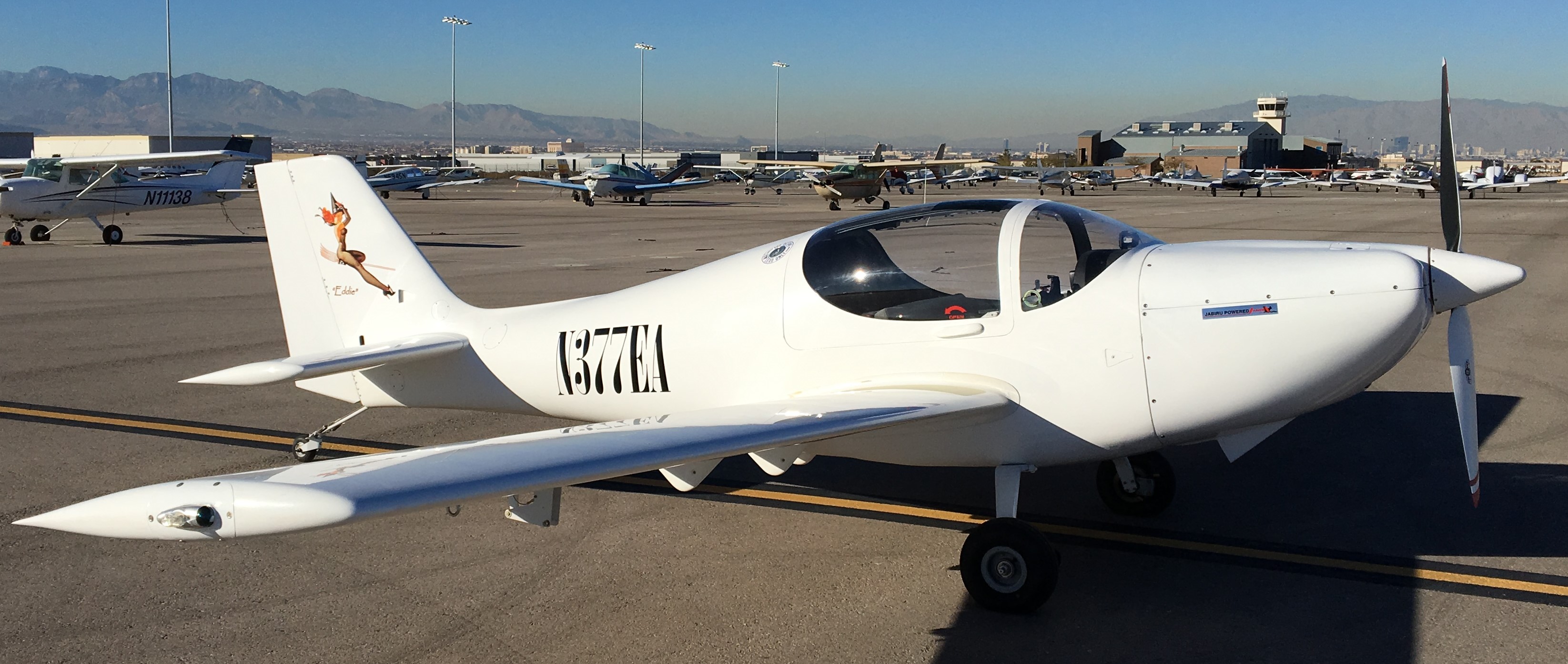

PostPosted: Fri Aug 27, 2021 1:24 pm    Post subject: N11EU Update Reply with quote
Well.....I wouldn't want to leave you talking to yourself on this forum. Especially since you are down-under and your government seems to be either crazier than ours or really really health conscious. I fly the Europa as a taildragger with the Bob Berube single piece gear leg. I run a 120 hp Jabiru 3300A with a twin blade Sensenich prop. She will cruise about 110 knots while drinking a little under 17 L/hr.
And yes, I feel that the forum has been very quiet but we can still go flying without restrictions. But for me, living near Phoenix, Arizona, I have to fly before 11 am as the temps today are currently 112' F or 44' C. This makes for a very sweaty experience. But this only lasts about 3 months and then we get into the fun flying.
So....good day...and keep up the hours.

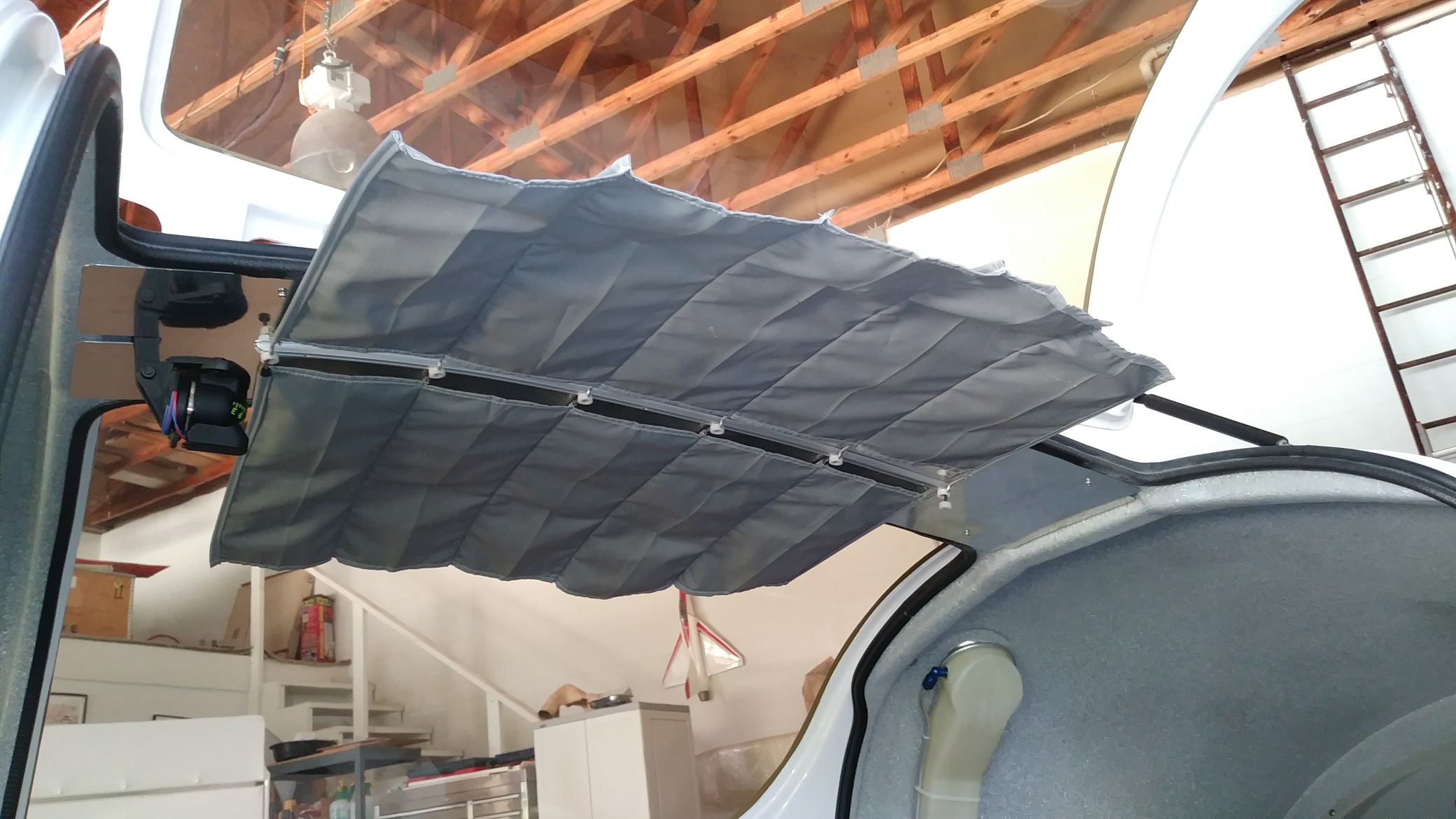

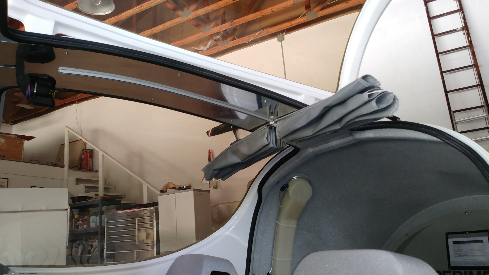

PostPosted: Fri Aug 27, 2021 6:39 pm    Post subject: Re: N11EU Update Reply with quote
To share another thing I did, ceiling cover and Kroger Sunshade. I actually ended up removing the compass and moving the shade forward. It does get in the way of getting into the seat but it is nice when flying with the sun high.
I got this shade used (like most stuff on my plane) so it is what it is. They are not very wide but do work. I'm keeping it (and the wife liked it). The only thing I would do different is a longer rail to be able to slide it all the way back.

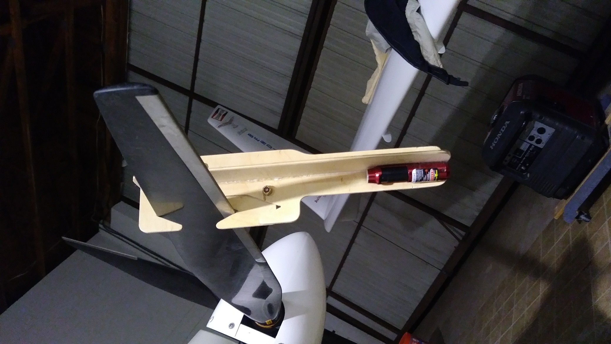

PostPosted: Sat Aug 28, 2021 5:12 pm    Post subject: Re: N11EU Update Reply with quote
Here is a picture of the tool on the blade. I use a digital level to level the blade. The laser will shine a spot on the floor and you mark it. Then do the same for the other blades and match all spots. You end up with same angle on all blades with great resolution. I tested for repeatability and it is very good.

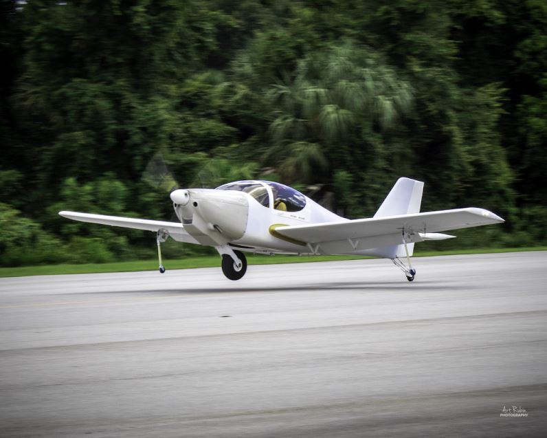

PostPosted: Sat Aug 28, 2021 5:16 pm    Post subject: Re: N11EU Update Reply with quote
Got permission to post this picture of N11EU touching down. Credit goes to Art Rubin Photography.
I think that in this case my deck angle was a bit high but I found I prefer this to being too close to touching main first. Of course different landings vary a bit, with sometimes touching the main a hair before the tail with the resulting bouncy. But I think this is such a fun picture with the tail rolling along happily (or maybe about to touch) while still in the air.

PostPosted: Sat Aug 28, 2021 7:42 pm    Post subject: N11EU Update Reply with quote
Very neat idea….

PostPosted: Sun Aug 29, 2021 12:51 am    Post subject: Re: N11EU Update Reply with quote
Great pitch tool idea; how do you prevent the aircraft from moving between blade rotations? Or is everything on the undercarriage fully chocked up?
Nice pic too on touchdown! I prefer being contrary and wheeling my mono onto the deck for now; need more practice flaring to grease it in the correct way

PostPosted: Sun Aug 29, 2021 7:26 am    Post subject: N11EU Update Reply with quote
Wow…!…absolutely textbook touchdown…congratulations !

PostPosted: Sun Aug 29, 2021 7:39 am    Post subject: N11EU Update Reply with quote
Chris…compliments on both concept and execution…What material did you use to make your tool?…Would you be willing to post a couple additional photos?
