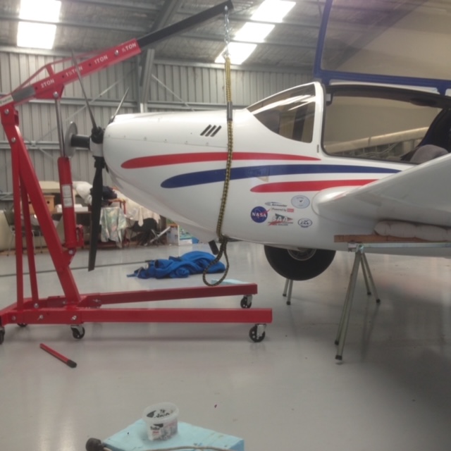

PostPosted: Thu Jun 17, 2021 4:00 pm    Post subject: Jacking Mono Reply with quote

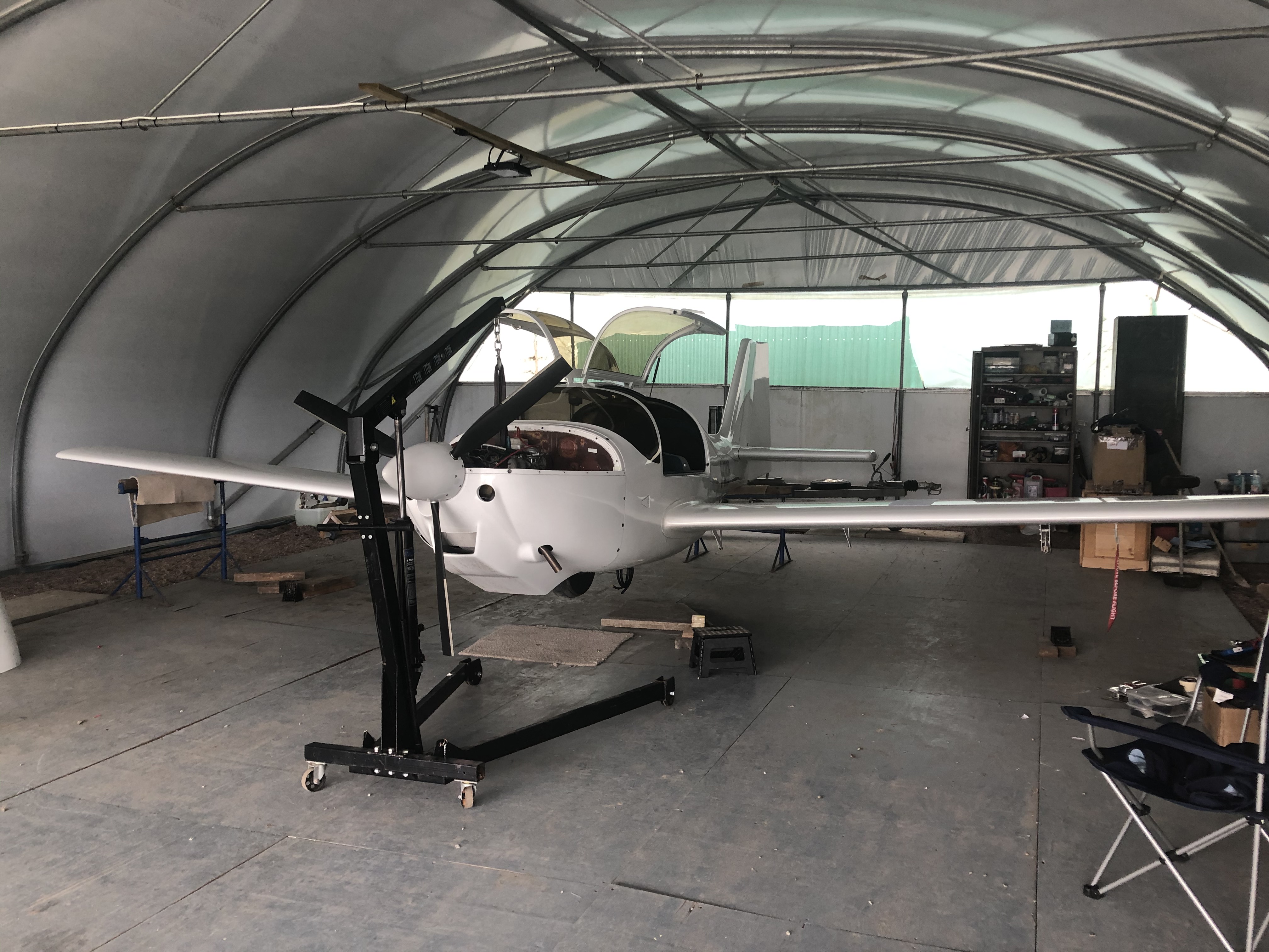

Hi Peter, This is what I do. See photo. Use long bolts into cowl anchor nuts to secure rope position. Once lifted secure aircraft with sawhorses either side of fuselage under wing spar position. Lower and raise under as need be. Use tow rope. Takes 30mins.
Cheers,
Tim

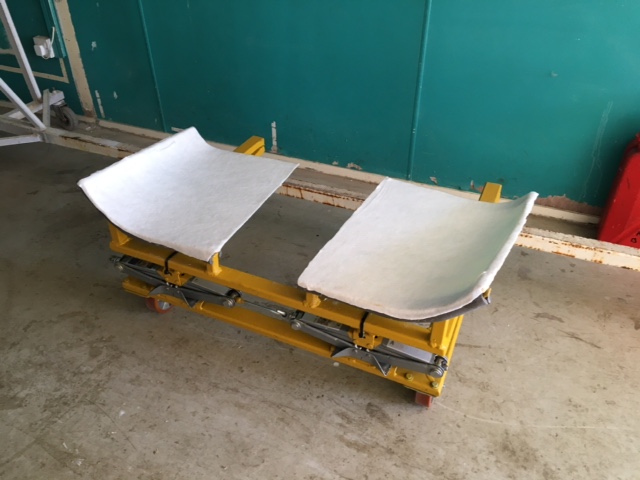

I have 2 pump jacks I've lifted plane up by root of wings. Motor and prop was installed but weight of plane probably 75% and no wing root fairings. Think with 100% weight it would work fine but you need to distribute weight evenly. I stacked a number of fairly hard rubber foam knee pads to conform to wing.
I much prefer dual scissor jack dolly that allows wing rigging, gear retraction and you can even roll plane sideways:

PostPosted: Thu Jun 17, 2021 6:44 pm    Post subject: Re: Jacking Mono Reply with quote
Thanks fellas,
Will lift it with the engine hoist as per Tim’s photo.
Cheers Peter

Hi i used a strapp around the through the engine mount frame and an hoist.

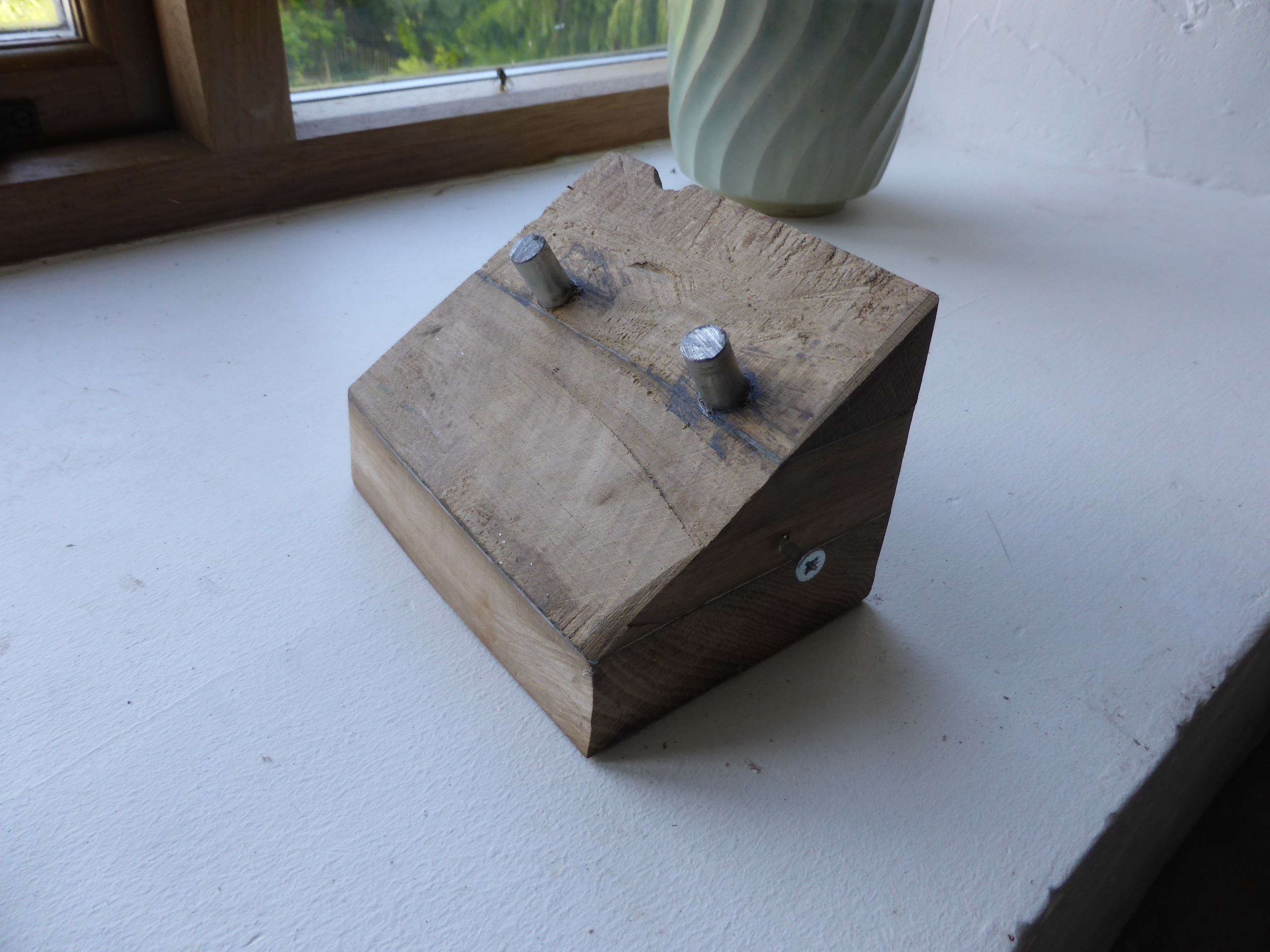

PostPosted: Sat Jun 19, 2021 3:30 am    Post subject: Jacking Mono Reply with quote
Peter, Lifting the plane via an engine hoist is a good solution if you have one! Otherwise you can lift a Europa via its wings although you need to be extremely careful that the load is well spread. Dealing with a puncture on a trigear is relatively easy by getting someone to lift the wing on the punctured side and putting a well padded trestle under that wing to keep the punctured wheel off the ground. this technique could be doubled up to get a mono off the ground, but there are better methods. I would recommend making a jacking block as in the picture the two sawn off coach bolts fit into two equivalent holes drilled in the U/C arm and that gives a firm horizontal surface for putting any conventional jack under. This was the only solution available when my friend suffered a puncture on one of the Arran Islands. It is also worth considering building a dolly, which makes all maintenance tasks very much easier. Regards, David Joyce, GXSDJ

Does anyone or the Europa Club have drawings for the proprietary 'Dolly' to which David Joyce refers in his post?
Thank you

Hi David, I copied the design.
[img]cid:97FBD147-1A3D-4E18-8555-021A1C6C0FBE[/img]
And have the moulds on loan.
Alan

James, Perhaps you will allow me to answer that question! The dolly I have is a one off constructed by Roger Target many years ago, but I have seen a number of others build dollies along similar lines or with a wooden base (although the latter are difficult, but not impossible to construct in a way which allows the plane to be lifted off the wheel. The starting point is a stiff splash moulding of the front part of the fuselage bottom, using multiple layers of fibreglass. This then needs to be covered with some padding material such as neoprene and attached to some form of framework. As you will see in the picture, mine has a clever hinging metal structure which can be expanded with a system made of two cheap car jacks. Further clever features are two holes drilled in the fibre glass bit on each side through which large wing nutted bolts go into corresponding holes in the fuselage where captive nuts are located, thus allowing the fuselage to be securely fixed to the dolly secondly just in front of the wheels are steel pieces with a hole through which further wing nuts can be screwed to securely locate the dolly and its attached fuselage in my covered trailer. It fits under the fus with the front edge just behind the rear of the cowlings. The dolly can and fairly frequently is used by friends who lack the fixing captive nuts in their fuselage by simply keeping the rear of the dolly in contact with the plane by passing long straps though the doors and round the dolly. Could send more pictures if required.

PostPosted: Sun Jun 20, 2021 8:28 am    Post subject: Jacking Mono Reply with quote
Alan, thanks for that. My reply was rejected because the picture was >3 mb. Mine has rather bigger wheels and also two holes though each outer support piece for wing nutted bolts to go though 1 cm holes in the fus into captive nuts, in order to firmly fix dolly to plane. It also has steel plates with holes through just in front of the wheels to allow the dolly to be screwed down in the trailer. Regards, David

David are your bolts into the fuselage primarily to secure the aircraft during transit in your trailer?

PostPosted: Sun Jun 20, 2021 1:20 pm    Post subject: Jacking Mono Reply with quote
They serve a dual function of keeping the plane secure on the trailer for maintenance or for transport. The wheels of the dolly are right at the front of the dolly in order to stay in contact with the ground when you open up the jack mechanism. Without the bolts or firm strapping of the dolly to the fuselage the dolly is not stable and can rotate in a back end down sense and lose proper contact with the fuselage, taking all its weight on the leading edge of the dolly. David

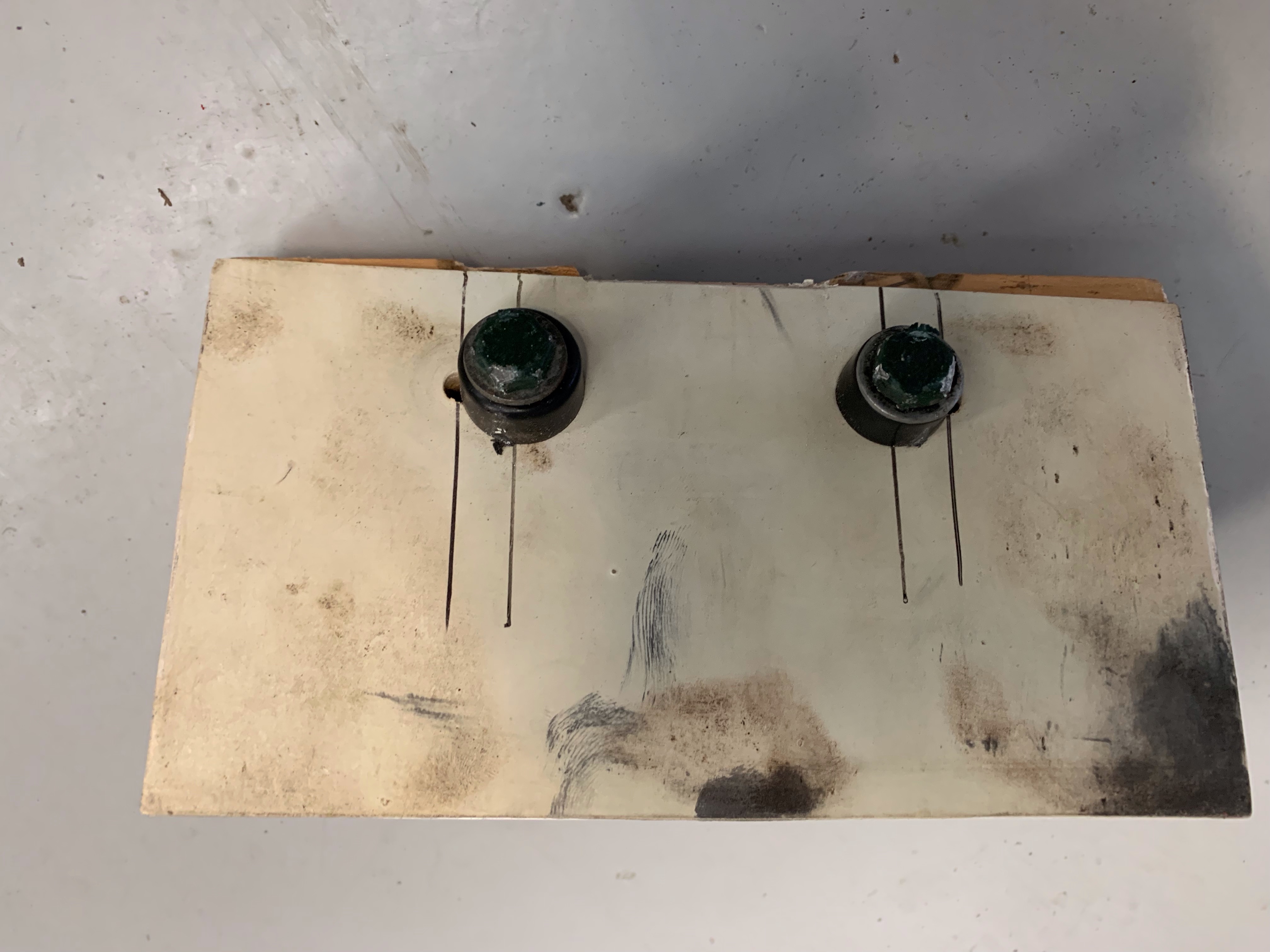

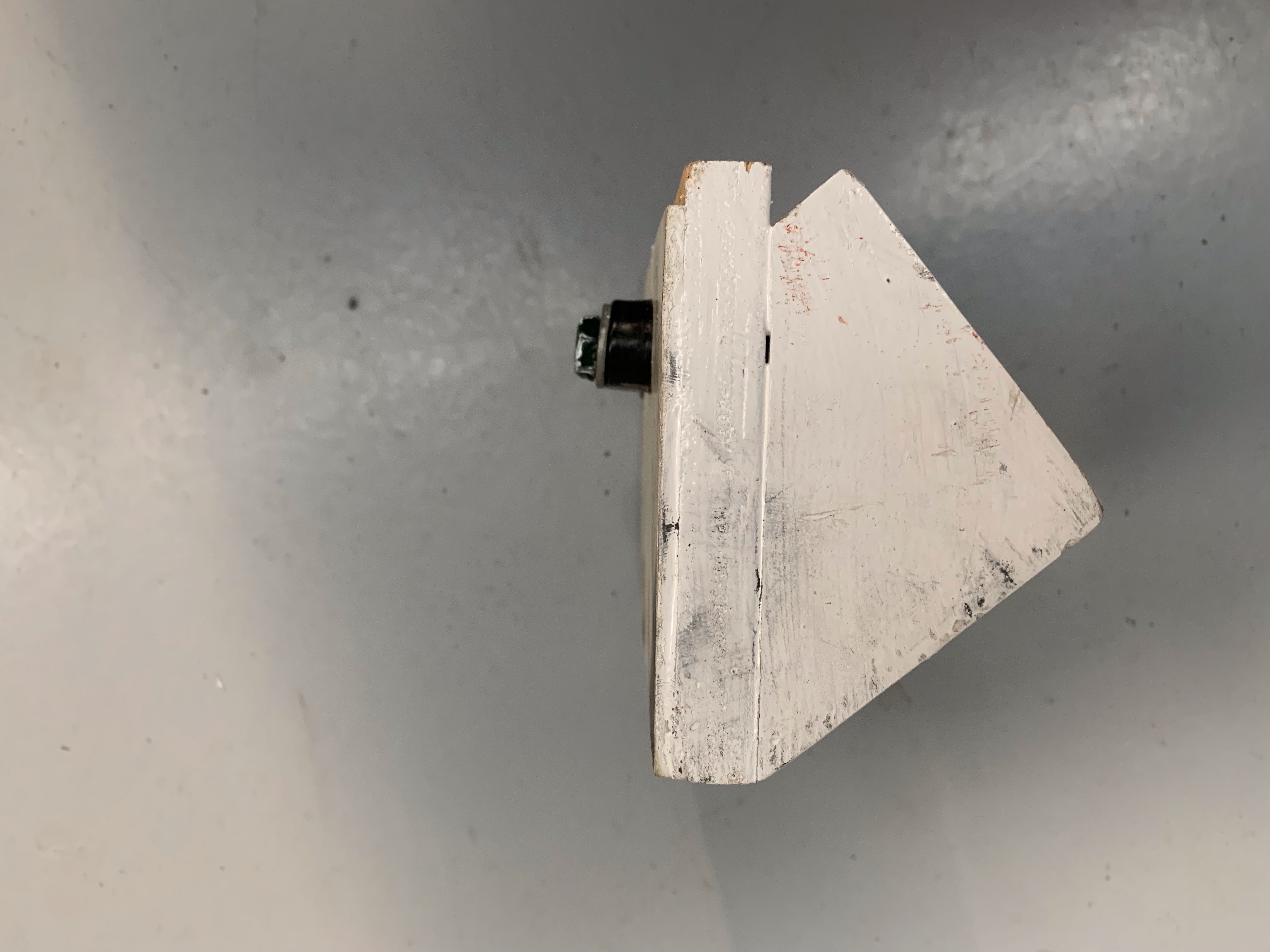

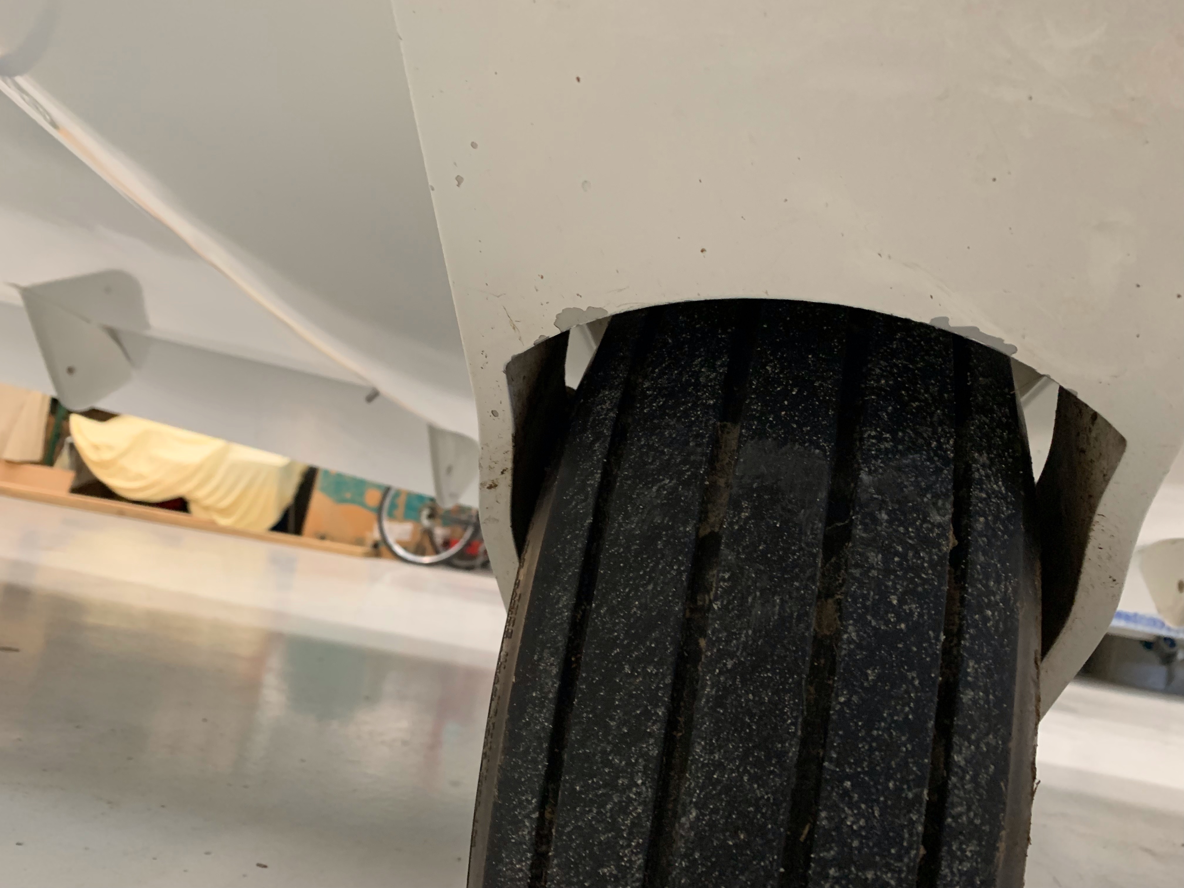

PostPosted: Sun Jun 20, 2021 8:23 pm    Post subject: Jacking Mono Reply with quote
Peter,Following on from David’s suggestion, I use a very similar method for a puncture repair
of the main wheel. Instead of drilling two holes in the undercarriage arm, I found two bolts drilled into a wooden block with rubber washers and placing the bolts between the wheel and arm is sufficient to lift the aircraft. See photos. Either two jacks as shown or one trolley jack works well. I carry the wooden block with me with a spare inner tube but not used in 18 years flying.

PostPosted: Sun Jun 20, 2021 8:27 pm    Post subject: Jacking Mono Reply with quote
Two more photo for clarity.[img]cid:3832886D-F890-4EE5-991E-3A5CB48CF643-L0-001[/img][img]cid:0828E16F-24DF-458B-9757-8DBCCBB90268-L0-001[/img]
Cheers,
Tim
<image7.jpeg>
[img]cid:6037B256-6D45-46C0-80B6-C26FE7A47A46-L0-001[/img]<image11.jpeg>

<<...and can rotate in a back end down sense and lose proper contact with the fuselage, taking all its weight on the leading edge of the dolly.>>
Resulting in permanent dents to the fuselage skin.
