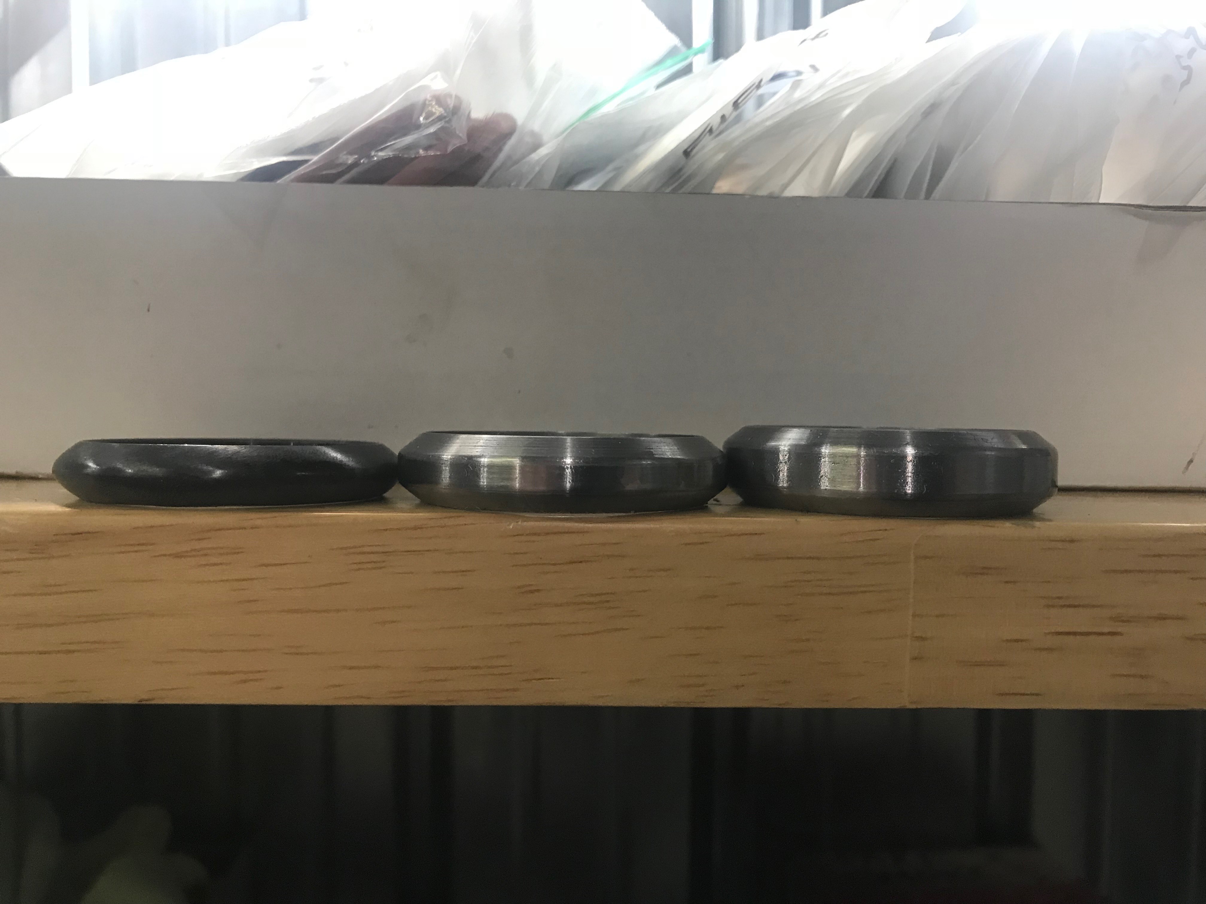

draftsjust417(at)gmail.co
PostPosted: Mon May 17, 2021 7:15 am    Post subject: intake/exhaust stack-to-cylinder rings... ? Reply with quote
Great info all, thanks-I learn something every time I open the cowls.
Thought there were olives/rings on both intakes & exhausts, good to know just exhaust stacks and fewer req'd.
I'm running a Chinese Housai, any info on those ring p/n's?
Thanks again- Justin

PostPosted: Mon May 17, 2021 8:44 am    Post subject: intake/exhaust stack-to-cylinder rings... ? Reply with quote
Excellent info, thanks Walt!Justin
On Mon, May 17, 2021, 9:39 AM Walter Lannon <wlannon(at)shaw.ca (wlannon(at)shaw.ca)> wrote:
Hi Justin:
The exhaust seals are identical for both the HS and M14 engines.
There are stainless steel units manufactured by one of the US exhaust manufacturers.  I have those on my engine but would caution any one considering same to be aware of the fact that as theses units are pressed in manufacture they leave a sharp protruding edge that will destroy the aluminum alloy cylinder seat.
If they are perfectly centered  they will work however I have yet to see an exhaust system made to perfectly align with all of the cylinder seats.
I have modified these for my own use but it is an extremely dangerous hand grinding operation.
Walt

PostPosted: Mon May 17, 2021 8:48 am    Post subject: intake/exhaust stack-to-cylinder rings... ? Reply with quote
Walt.
I just had this education recently from Richard.
They make the exhaust olives in three thickness.
10, 12 and 14mm to help fit the flanges better.
Since I used these my exhaust fits very well and stays tight.  Grinding those would be difficult at best.
I have attached a photo of what Richard supplies.  I understand Richard uses these on a regular basis

On Mon, May 17, 2021 at 12:39 PM Walter Lannon <wlannon(at)shaw.ca (wlannon(at)shaw.ca)> wrote:
Hi Justin:
Walt

The M14 part numbers are:
10-04-46 Intake gasket upper pipe to cylinder 3 per cylinder
14-04-542 Exhaust Gasket (doughnut)
10-04-26 Intake gasket lower pipe to supercharger case
George Coy

Yes, in Europe we call them exhaust "olives". The standard size is 10 mm thickness, but we realised that a certain number of people fail to tighten the exhaust nuts on a regular basis; the exhaust plus olive then "fret" against the cylinder head and wear it away, and in these cases we manufacture thick olives to any size people might want. So the standard olives are Euro 28 each and the thicker ones in any dimension (to order, since we manufacture them) are Euro 38 each.
And the intake tube gaskets are of course different – it is a rubber ring at the supercharger end, for which we charge Euro 4 per ring and at the cylinder end it is a paper gasket, but in order to get the appropriate thickness one needs three of them per intake tube. Cost is Euro 2 per gasket, so Euro 6 for the three and so a total of Euro 10 per intake tube!
All are in stock with Aerometal in Hungary, so let us know if anyone needs them.
