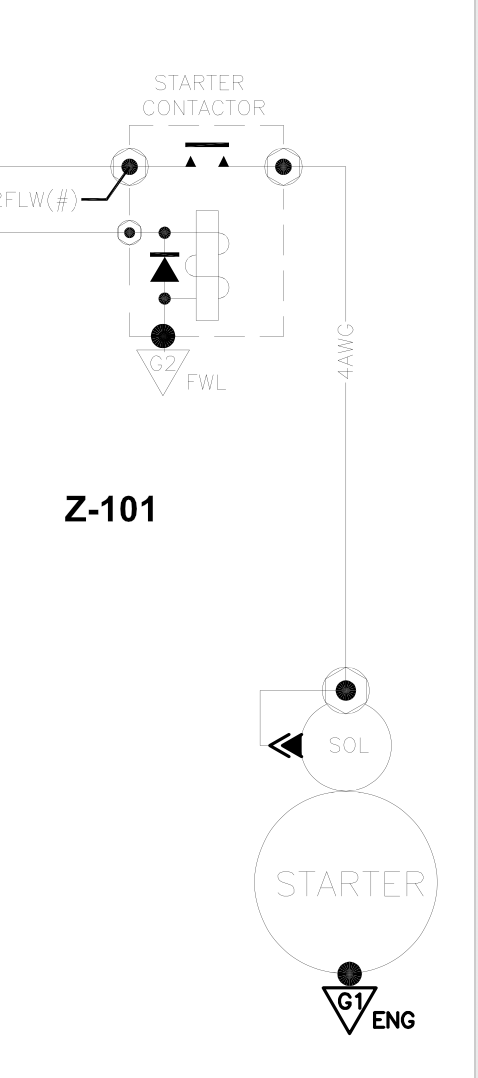

I'm working on a schematic for my RV-10 based on the Z-101 architecture and have come up with a couple questions about contactors...

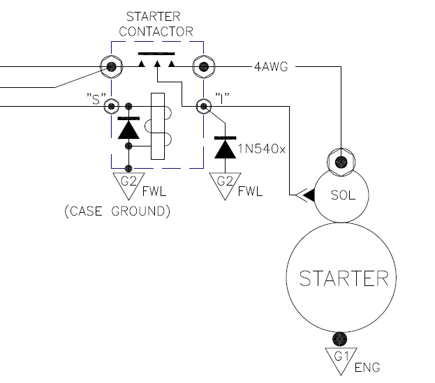

First, about the starter contactor. The Z-101 shows a single conductor connecting the contactor to the starter with a jumper at the starter. I found another discussion from 2015 with an alternative arrangement (attached) for permanent magnet starters. I'm planning to use a B&C starter. Should I be using the extra wire & diode?
By 'extra wire' are you talking about the jumper from
contactor "I" terminal to the starter's "S"
terminal? Yes, wire as shown and including
the diode is a good thing. The starter contactor
from B*C will include a built in diode on its
coil.

Thanks to you both for the quick feedback. I'll include the jumper from the contactor "I" terminal to the starter with the extra diode.
