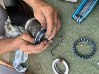

Thought it would be helpful to add some images of the hub disassembly and bearing, bush, o ring replacement. The orange nylon block has a barely perceptible notch on the corner which the manual talks about - with trailing edge up it goes on the right as you view the blade from tip looking towards hub.
Shiney new hardware from Simply Bearings in the UK

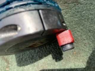

As was mentioned, one side of the bearing is noticeably smaller than the other so just remember which goes on first
 Filesize:  34.16 KB
 Viewed:  15829 Time(s)

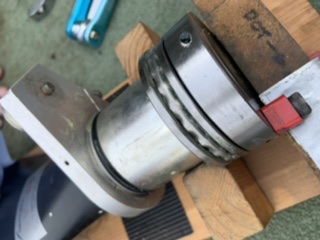

 Filesize:  33 KB

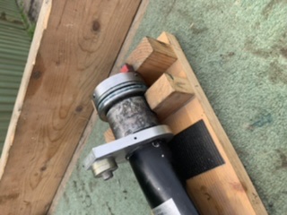

The jig is to make sure the angle stays the same. Just lay the prop tip flat and have the nylon block hard up against in this case, the flat top of the jig. Others use a notch or hole and I think this would be more precise again
 Filesize:  31.01 KB

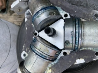

The nylon block that engages in the triangular platform to change pitch. The notch is bottom left in this image
 Filesize:  28.13 KB

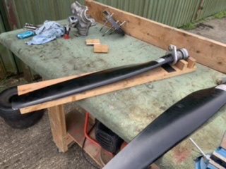

The open hub with old and dirty prop parts
 Filesize:  32.29 KB
