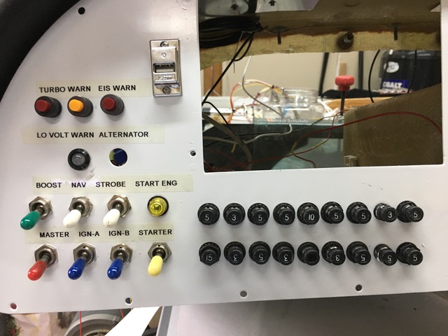

FWIW, I just labeled mine as IGN A and IGN B.
[img]cid:5C3CC2D4-7E17-4FFD-AD7C-922B600D8ACA[/img]
There really isn’t a “LEFT or RIGHT.”
I guess you could label them IGN TOP and IGN BOTTOM and stack the switches the same way.
