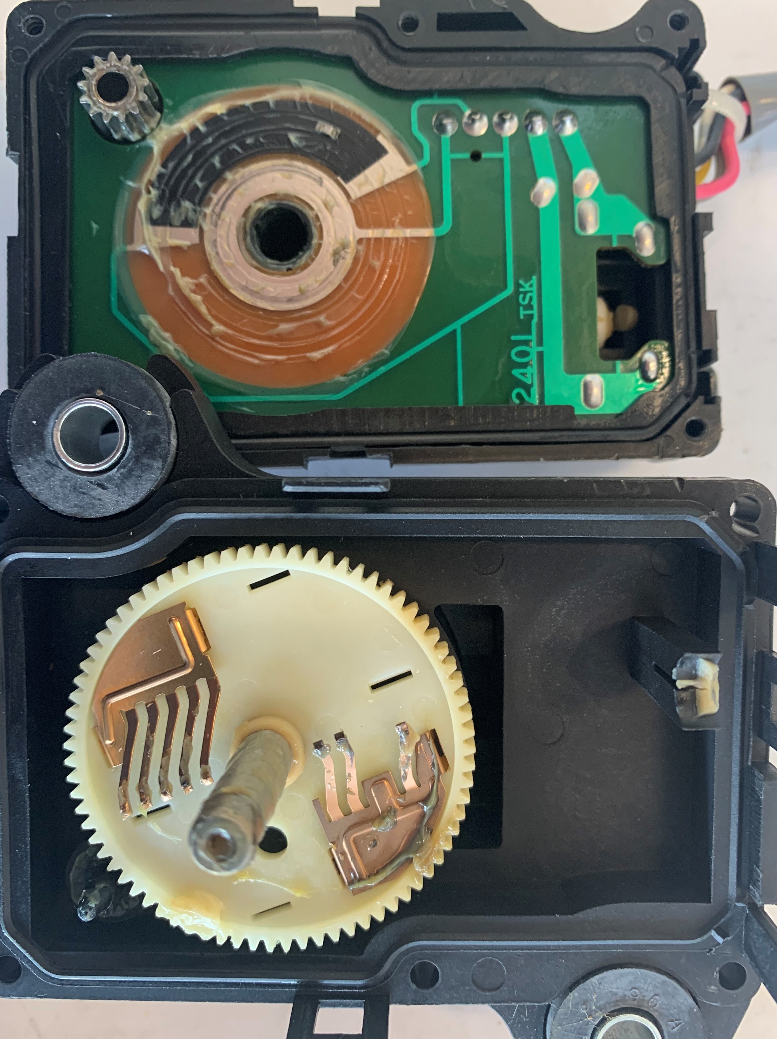

The picture shows the inside of my TCU wastegate servo where the tip of one wiper has broken off and is now stuck against (perhaps with dielectric grease) what appears to be a screen printed resistor that is used by the TCU to measure servo position.
The symptom was a jammed wastegate cable and a blinking orange TCU light that appears about 6 seconds after power up (not immediately like what happens with a disconnected sensor). After I removed the jammed cable from the servo wheel, the servo rotates "too far" on power-up -- clockwise past the cable mount before returning to the start position. No wonder the servo and cable were jammed. When I opened the servo, the broken copper wiper was obvious.
Has anyone else seen this? Can I buy a gear with the copper wipers, or maybe just the wipers themselves? This happened suddenly: 2 weekends ago everything was perfect, last weekend -- blinking light. This weekend -- disassemble until problem found. I can't imagine that I'm the only one with what amounts to a potentiometer with a bad wiper. This is certainly not a $500 failure (cost of new servo). Thanks.

Hi PCahill Now that I have seen the unit and heard from Bud a few ideas:
Ask Bud if he still has his old unit that may have a good set of brushes on gear and buy it from him and put on your unit? Note: There may be different variations of servo, I have no ideas what the differences are. Perhaps the gear/brushes is the same?
Measure the thickness of copper on brush, procure same or similar from McMaster or other:
https://www.mcmaster.com/copper-sheets
Cut off a good portion of remaining leg on broken brush and form the end to look exactly like other brushes, then solder splice a piece of copper splint.
I would probably do the percussive maintenance trick on solder job. Take some of the thinnest solder you can find, then pound it into a thin sheet and cut to precise size of splint. Put some flux on both sides after cleaning copper immaculate and make a few clamps to hold it in position. Use some thin SS welding rod if you have it, if not bend up some paper clips. Start with a modified Omega shape. Thy different sizes of clamp also different thickness paper clips or welding rod. If you have a problem getting heat in there or getting your soldering iron in position, use flame from cigarette lighter. I would wrap neighboring brushes with a piece of aluminium foil to keep heat off them. we don't know what sort of temper they may have.
You ultimately want about the same pressure on brush as others. Since you are splicing and may not be using the exact same copper, you will probably end up a bit stiffer? If that happens you can probably do like Shunts do. Start making the width a little bit narrower at a time till pressure is the same.
If you need more tension, beat a piece3 of copper thinner, cut to size and splint.
Look very careful at other brushes for any cracks. Any defects smooth out.
Look very very carefully at the broken pieces and see if there is a defect that caused a stress riser. If there is, perhaps contact Rotax and see if they can be of assistance. Probably out of warranty, but since it was definitely a factory defect, it would be greatly appreciated if they could help you out, like 50 to 75% discount off replacement? Good luck on that one Wink
