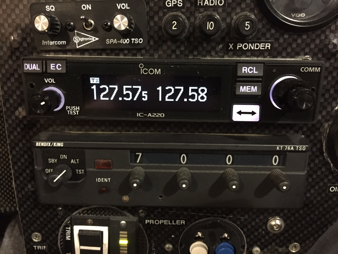

PostPosted: Tue Jan 05, 2021 2:34 am    Post subject: Intercom Reply with quote
John ,
Pic of installation using existing sigtronic intercom ...reduces head down time while flying , also made for very quick radio swap as most wires are undisturbed when installing 8.33 where a 25mhz was prior ( with Traditional TSO kit ) slots in to existing tray too.
Kevin.
UK Midlands based XS Trigear .100hp Rotax ( softstart) Warpdrive prop..6 pack instruments including dual manifold pressure.
