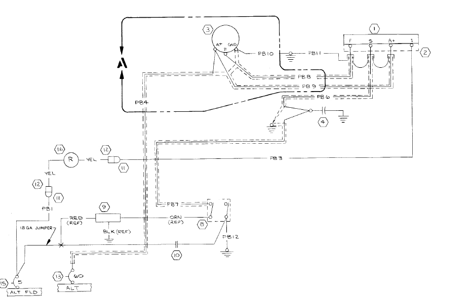

this non-trivial expense. This wiring diagram
is an excerpt from a C172 service manual.
