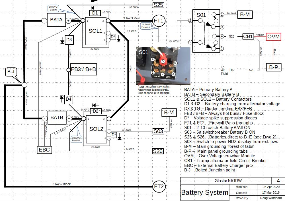

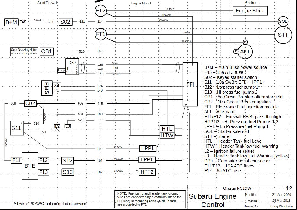

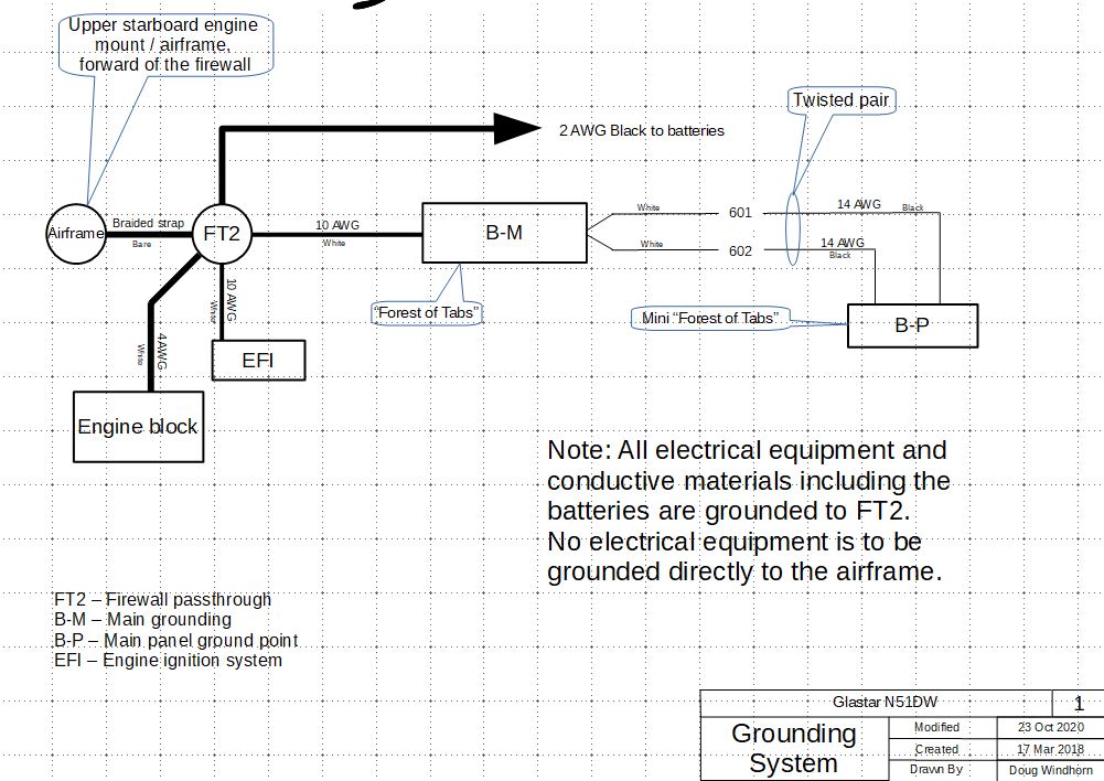

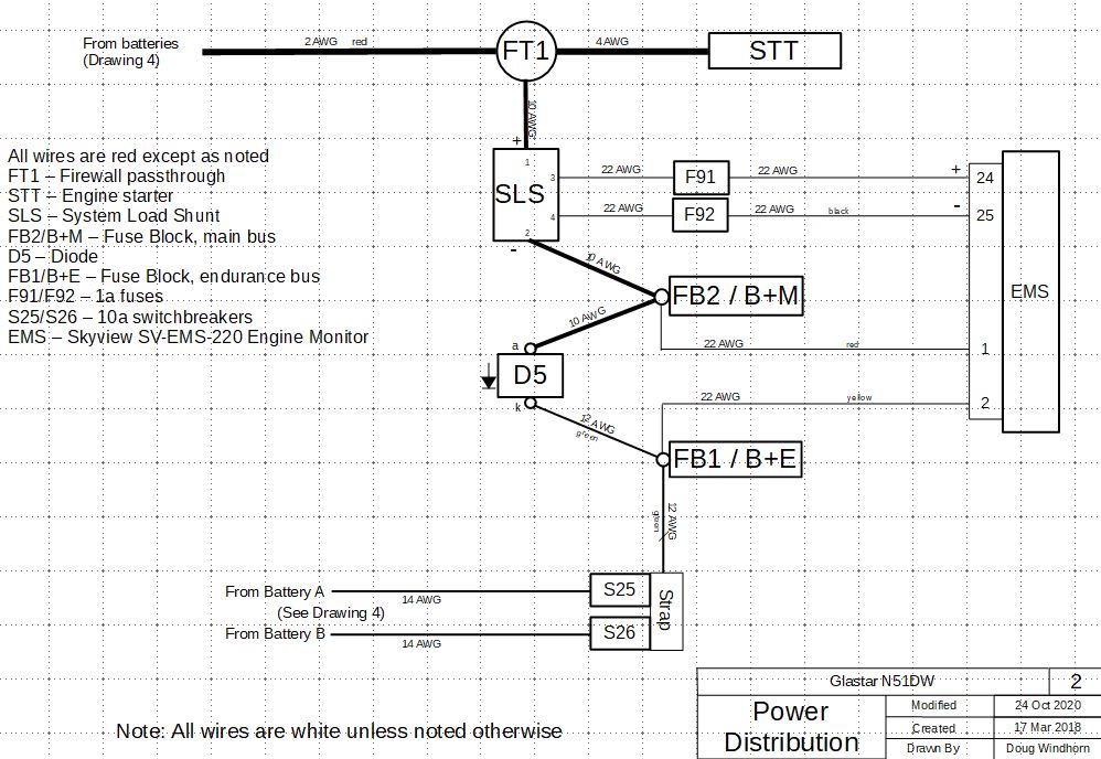

PostPosted: Tue Oct 27, 2020 1:51 pm    Post subject: Positively Negative (-) ? Reply with quote
This comment may not be relevant as I am not aware of the engine installation. I have a single alternator dual battery configuration with batteries aft and 2 AWG cables between the batteries and firewall connection. From the latter connection, I feed the main bus and an e-bus via a diode. I also have direct switched feeds from the batteries to the e-bus. I have an electrically dependent automotive fuel injected conversion powerplant.
I found that when attempting to start on one battery, I could not get a reliable start. But when I switched to the second battery directly to the e-bus, no starting problem. My conclusion is that the voltage drop while cranking the engine was sufficient to cause the ignition system to not operate reliably. This may have been due to the 9-10v cranking voltage drop in in addition to the up to 1v drop across the diode. It is my understanding that most ignition systems need 10v to operate reliably.
My current process to start the engine is to crank on the A battery while feeding the B battery directly to the e-bus.
Again, don’t know if this is relevant to this discussion.
Regards, Doug Windhorn

PostPosted: Wed Oct 28, 2020 5:02 am    Post subject: Positively Negative (-) ? Reply with quote
Very much so . . . but to offer cognizant
analysis of your observation, we'd have to
see a schematic of your distribution system
and a good physical description of the
installation.
Your observations are no doubt accurate
but anecdotal with respect to cause and
effect.
You don't seem to have an issue with
cranking (starter) performance but instead,
the ignition system seems especially
sensitive to low supply voltage. This
is curious as automotive electronics are
designed to function under exceedingly
trying conditions.
The batteries in automobiles are the
second worst maintained in practice
(farm equipment comes first). Any
automotive designer worth his salt
strives for state of battery to be
the last bastion of determination
for getting ol' bessy fired up.
If the starter motor achieves
rotation at all, getting one ideally
charged cylinder past TDC is going
to speak to failure/success. Voltage
to the electrics is generally not
the limiting factor.
The article referenced at the start
of this thread speaks in generalities
and offers no data that quantifies
improvements to be secured nor does
offer anecdotal evidence of a problem
in practice having been resolved.
Your narrative at least describes
actions taken and improvements noted
as a consequence of that action. But
it too is short on data that would
help us understand exactly what
is happening.
DougW
Joined: 16 Sep 2015
Posts: 14
Location: Washington
PostPosted: Wed Oct 28, 2020 1:19 pm    Post subject: Positively Negative (-) ? Reply with quote
Bob,
Thank you for your comments. I have attached some JPEG images of my relevant schematics. The originals are .ODG drawings (can’t figure out how to transfer to PDF). I hope these may help; let me know if there is something else I can provide. FYI, the numbers interrupting the wires between devices (nodes) are connector pin numbers.
Not sure what you mean by “a good physical description of the installation.” The only thing I can add, not included in the drawings, is that the firewall passthroughs are 5/16” tin-plated threaded studs in an insulated frame mount commonly used by boaters. Batteries are Odyssey PC680’s.
The original electrical installation was done a couple decades ago and generally followed the drawings of the engine converter for those engine related components. I tried to follow your Z drawings (forgot which one) for overall ships electrical installation. I have not measured more than about .007 ohms resistance along any of the wires installed, but maybe I should recheck some of those.
Additional notations in your prior response.

n1dw wrote:
> Bob,
> Doug
> *From:* owner-aeroelectric-list-server(at)matronics.com
> <owner-aeroelectric-list-server(at)matronics.com> *On Behalf Of *Robert
> L. Nuckolls, III
> *Sent:* Wednesday, October 28, 2020 5:57 AM
> *To:* aeroelectric-list(at)matronics.com
> *Subject:* RE: Positively Negative (-) ?

PostPosted: Wed Oct 28, 2020 5:25 pm    Post subject: Positively Negative (-) ? Reply with quote
Dick, thanks for the tip. Have attached the newly created PDF versions.
Doug
