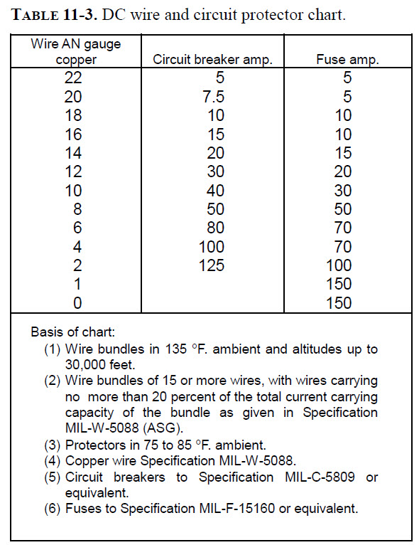

Looking at table 11-3 in the 43.13, the table shows lower amperage recommendations for fuses versus circuit breakers in many cases. Bob has shown us how much quicker a fuse operates versus a CB so logic seems to suggest a higher fuse rating versus a CB. What am I missing?
Thanks!

Here's an image of Table 11-3.
