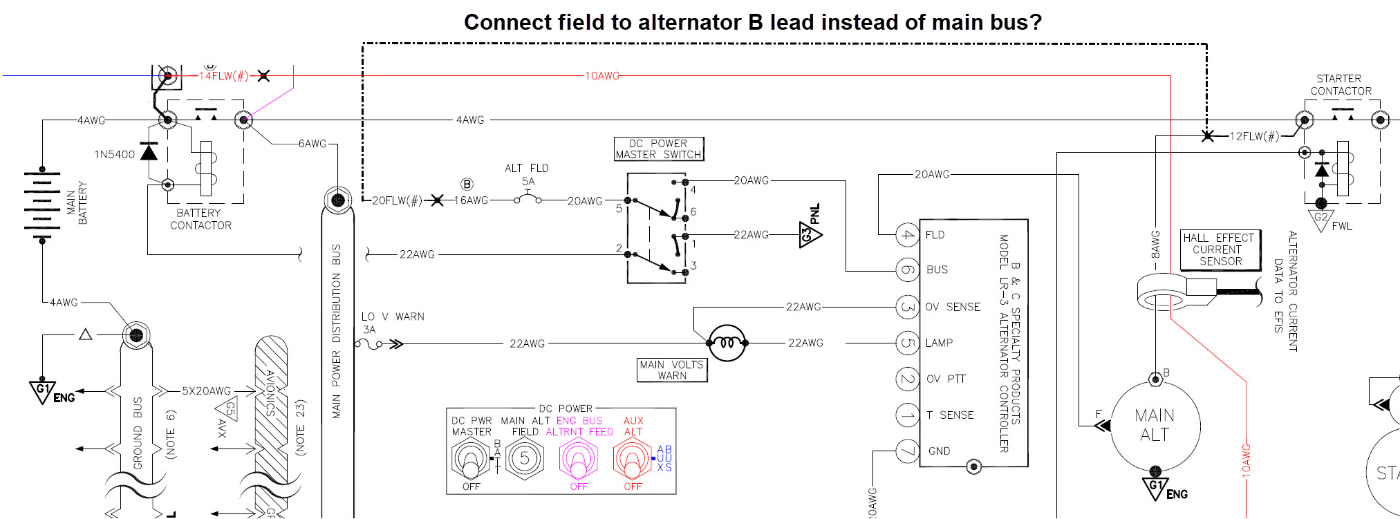

Hi Bob,
Someone in my sphere suggested getting field current from the B lead instead of from the main bus.
This way if the B lead shorts to ground and the fuselink opens, the field will be de-energized.
Marked up snip of Z101B attached.
Comments?

Bad idea. How often do "B" leads short to ground?
The "B" lead is not going to short to ground if properly installed.
Adding an extra wire from the alternator to the instrument panel increases the chances of a failure.
Suppose the alternator stops working for some reason.
It could be a broken belt, bad brushes, broken wire, blown "B" lead fuse.
The pilot will not know the cause. What action will the pilot take?
She might cycle the alternator field switch on and off. If the alternator still does
not work, she might leave the switch off to conserve the battery.
I see no advantage to adding an extra wire to the engine.
