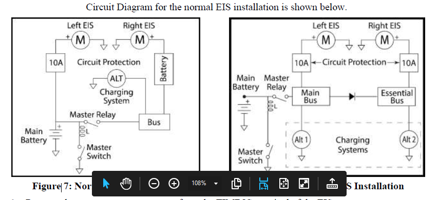

Got today SI 1569A which is talking about the new Lycoming EIS which are power dependent.
Interesting their wiring recommendation, looks so familiar:
[img]cid:part1.84668BC5.71729677(at)gmx.net[/img]

Thanks for the link.
Is the Lycoming EIS an off-the-shelf or a clean sheet system and who makes it?

It looks Lycoming branded but identical to the Surefly, for certified it
has fixed timing Smile
Cheers Werner

It's a SureFly.
https://www.lycoming.com/eis
The Lycoming EIS was developed by SureFly Partners, Ltd. with input from Lycoming’s engineering teams to meet Lycoming’s exacting specifications.
