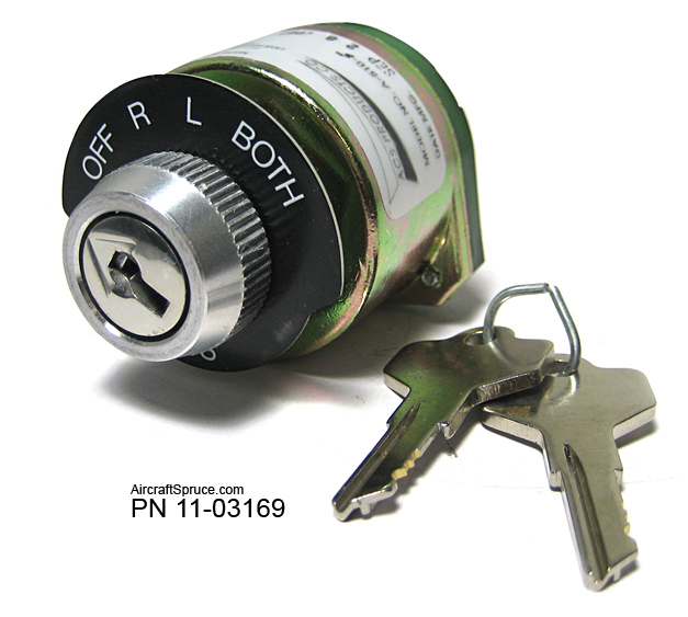

With 'standard' mags as supplied by Lycoming, and an RV9a with ACS Key switch WITHOUT starter position and using 'push switch' to operate starter, should the engine be started on LEFT MAG ONLY.
John
PS: Aircraft Spruce photo: copyright acknowledged

You want to start on the mag with the impulse coupling. On most engines, that would be the left mag. But you should check to make sure.

Depends on what the mags are. If they both have impulse couplings you can start on both, I think.

The common configuration is to have the impulse coupling on the left, which means left on and right off for starting.

The engine should be started with the impulse coupled mag 'on' (ungrounded P lead), and the other P lead grounded.  What you describe is how the switch *should* operate, but it's easy to verify operation for yourself. Without the P leads connected to the switch, Measure resistance from each P lead terminal to the ground terminal, 1st with the switch 'off', then in 'L', then in 'R'. Both P lead terminals should show dead short to the ground terminal with the switch 'Off'. The 'L' terminal should  show an open circuit (infinitely high resistance) and the 'R' terminal should show a short to ground with the switch in 'L', and the reverse in 'R'. With the switch in 'Both', both terminals should show open to the ground terminal. (Don't forget that if you're touching the terminals with your fingers, your body will conduct slightly, so depending on the meter, you might see some high but not infinite resistance when the switch is open.)
The left mag is *typically* the impulse mag, but it's pretty easy to check. The impulse mag has what appears to be a spacer that's about an inch thick between the body of the mag and the engine. So the 'taller' mag is the impulse mag.

I presume my next question is: does a Lycoming that comes via Vans for an RV come with one or two ‘Impulse Coupled’ mags.
