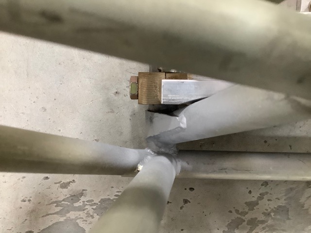

Hi Folks,
My kit’s (circa-2001) frame seem to have an offset error on the swing-arm tube centering tabs, making it not possible to drop the gear without interference. Anyone else seen this error? Looks like a fiddly fix to carefully grind down one tab and adding to the other.
Picture is attached (if it gets through - also posted on the Europa Aircraft Owners FB page)
Thoughts/experiences anyone?
Many thanks,
Pete

PostPosted: Thu Jun 25, 2020 4:01 am    Post subject: Re: Frame/gear offset error? Reply with quote
Pete,
Could you explain further what is the problem? From the photo I don't see anything wrong.
Jim

PostPosted: Thu Jun 25, 2020 7:18 am    Post subject: Frame/gear offset error? Reply with quote
Pete,
What do you mean by centering tabs? From you picture it looks like the swing arm needs to be moved over slightly to the S.B. side. I believe the lateral position of the swing arm is set by the LG08 legs which are centered in the large diameter cross tube and LG02A which is bolted to the swing arm. Looking at your picture it doesn’t look like the LG08s have been mounted to the frame yet. I suspect you just need to clean up the bearing surface on the lower frame to allow the swing arm to slide closer to the port side down tube. Or perhaps I am missing something and got it all wrong. 🤔

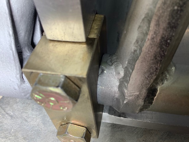

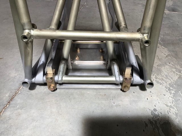

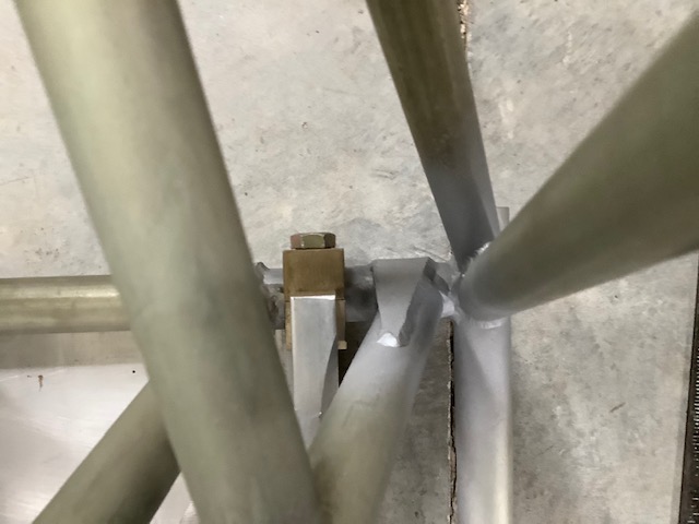

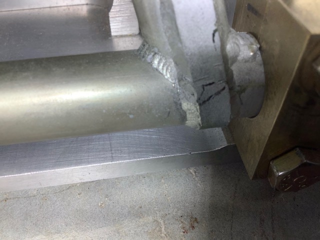

peterz(at)zutrasoft.com
PostPosted: Thu Jun 25, 2020 7:47 am    Post subject: Frame/gear offset error? Reply with quote
Indeed the swingarm is centered on the lower frame tube by two small tabs welded onto the top of that tube, which ride on the inside vertical surface of the arm’s brass bushing blocks. Those tabs are nicely tight on the swingarm to prevent any lateral sliding of the swingarm on the tube, but sadly they are offset to the pilot’s side on mine, preventing the swingarm from clearing the vertical tube. I was just wonder if others had seen this fabrication error, or if mine was a one-off mistake.

kingsnjan(at)westnet.com.
PostPosted: Thu Jun 25, 2020 3:20 pm    Post subject: Frame/gear offset error? Reply with quote
Peter,
Photos can be deceiving but in the photo attached, it appears the brass
bushings may be offset with respect to the swinging arm.  As a point of
interest, have you tried inverting each pair of bushings to see if there
is any improvement?
If the tabs as you call them are different distances from the side frame
(a fabrication error as you suspect), I think I would be tempted to
simply grind away that part of the swinging arm that conflicts.  There
is not much clearance at the best of times in that area.

PostPosted: Thu Jun 25, 2020 10:42 pm    Post subject: Re: Frame/gear offset error? Reply with quote
Pete,
From what I see on your pictures, it seems that one weld (image2) is preventing the swinging arm to be moved to starboard enough to clear the frame when in the extended position. May be some filing of the excess welding would solve this issue?
Good luck

PostPosted: Fri Jun 26, 2020 8:32 am    Post subject: Re: Frame/gear offset error? Reply with quote
Pete,
Please ignore my previous post. After a closer look at your photos, I see now the tiny tabs you are referring to. You are perfectly right: they are welded in a position which makes the swinging arm to be offset to the pilot side.
Not easy to fix that properly. Good luck!
